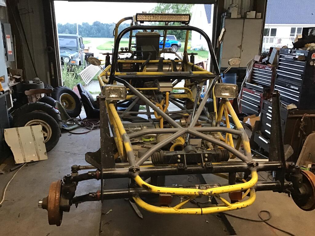

I have a Subaru powered Dune Buggy but it is road legal to drive trails too.  Getting stuck is fun, but getting out with no help is an adventure!
