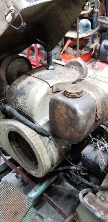

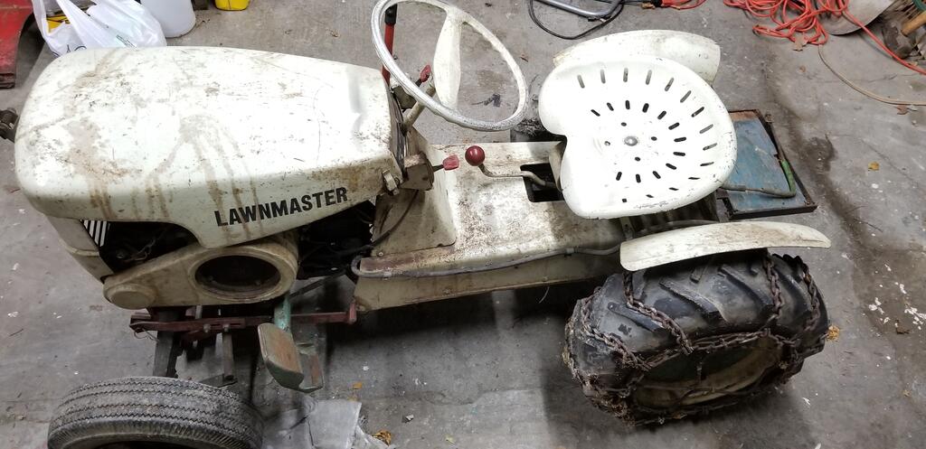

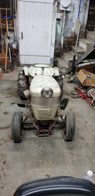

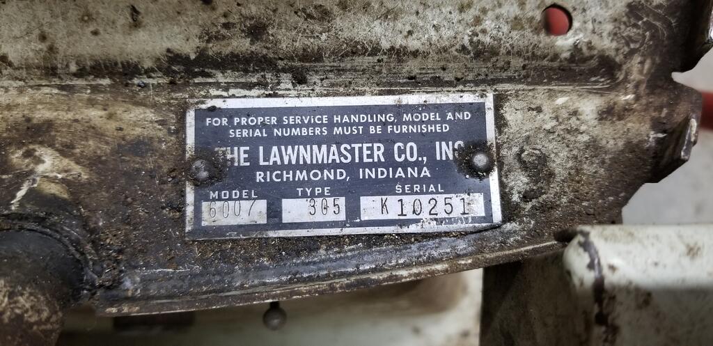

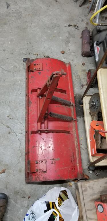

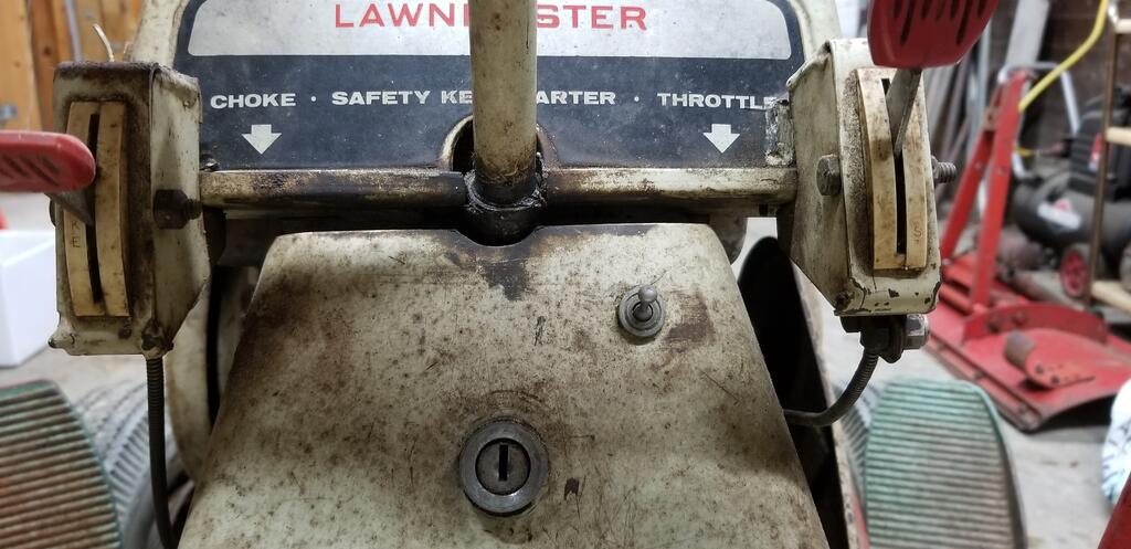

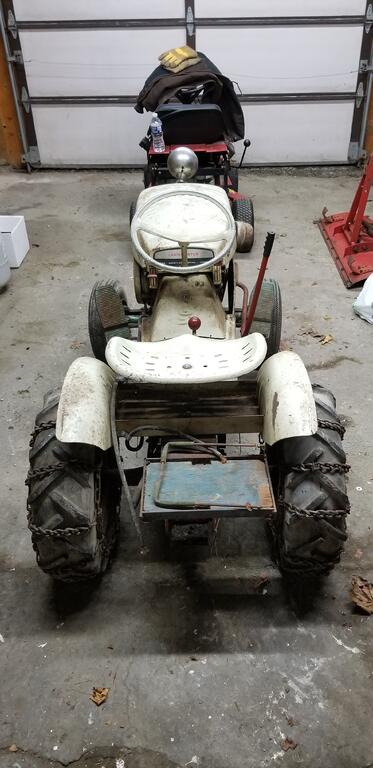

Mike'sHorseBarn 3,122 #1 Posted December 15, 2020 Anyone have any info on this machine, like when they were made? I'm assuming parts are going to be hard to find, but I think this was built by Moto-Mower. I keep picking up these off brands lol 8 5 Share this post Link to post Share on other sites
WHNJ701 4,165 #2 Posted December 15, 2020 Nice machine, that design was produced by several different manufacturers after Porter cable sold off its lawn garden division in late 1959 A good guess is 60 to 63. I would try to put a date on the kohler. Yours looks complete and has the belt guard on the muffler side which is a hard to find part 1 Share this post Link to post Share on other sites

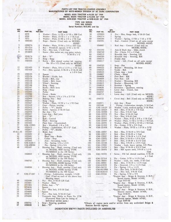

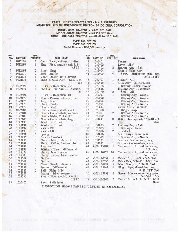

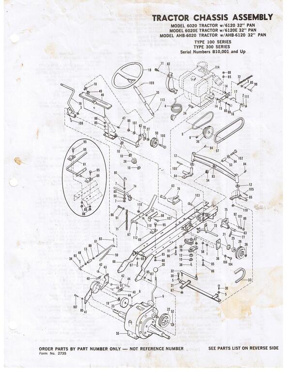

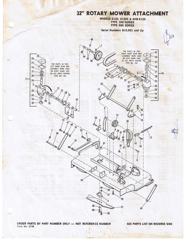

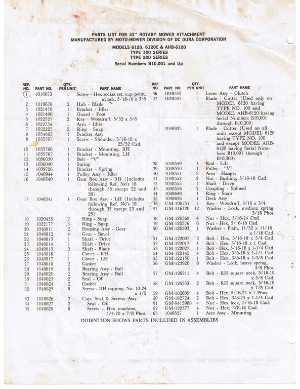

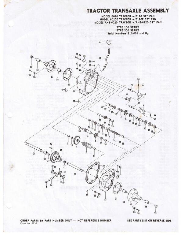

oliver2-44 10,351 #3 Posted December 15, 2020 (edited) Yep, built by Moto Mower. Similar to Massey Ferguson Executive and Porter Cable GT's. The hood on each of these is different. Here's some moto-Mower info I've collected. it should be very close to identical for a LawnMaster @new2horses has several. I've seen some comments/speculation that the foot rest (which are also the brake and clutch pedals) are left over WWII aircraft foot pedals I have a transmission on one to overhaul, and boy do they make WH tranny's look simple. Moto-Mower_Sales_flyer_1964_mower_line.pdf Edited December 15, 2020 by oliver2-44 3 Share this post Link to post Share on other sites
Mike'sHorseBarn 3,122 #4 Posted December 15, 2020 Well thanks to those pics I know where the battery is supposed to go now. Previous owner built that bracket on the back for it. Get this, he lived to be 100. Got this tonight from his estate yard sale. Sat in the corner of his garage for 20 years when he couldn't plow his snow on his own anymore. 2 2 Share this post Link to post Share on other sites
WHNJ701 4,165 #5 Posted December 15, 2020 Not sure if you saw it there was a great buy on a Porter cable with alot of original attachments for 350 bucks kinda between me and you in pa. I think it finally sold. They are fun little machines my 2 have pull start briggs, yours with kohler definitely a nicer option Share this post Link to post Share on other sites
Mike'sHorseBarn 3,122 #6 Posted December 15, 2020 6 minutes ago, jabelman said: Not sure if you saw it there was a great buy on a Porter cable with alot of original attachments for 350 bucks kinda between me and you in pa. I think it finally sold. They are fun little machines my 2 have pull start briggs, yours with kohler definitely a nicer option I missed that. I've never had a machine like this so it will be a learning experience. Definitely love anything with a kohler engine though! 1 Share this post Link to post Share on other sites
WHNJ701 4,165 #7 Posted December 15, 2020 Pretty basic machines, yours looks likes original survivor, not sure about the light. Looks cool enough, the rear battery definitely helped with weight. You will notice driving they have very light steering, you can steer it all day with 1 finger 1 Share this post Link to post Share on other sites
Mike'sHorseBarn 3,122 #8 Posted December 15, 2020 13 minutes ago, jabelman said: Pretty basic machines, yours looks likes original survivor, not sure about the light. Looks cool enough, the rear battery definitely helped with weight. You will notice driving they have very light steering, you can steer it all day with 1 finger I doubt the light is original, but I'll leave it there anyway. I'm just going to clean it up good, get it running and leave it alone. 2 Share this post Link to post Share on other sites
wallfish 17,483 #9 Posted December 15, 2020 52 minutes ago, Mike'sHorseBarn said: I doubt the light is original, but I'll leave it there anyway. I'm just going to clean it up good, get it running and leave it alone. Totally agree. That's definitely a cool little machine and appears to be in very good condition. The front of the hood pic reminds me of those 50s robots in the movies 2 3 Share this post Link to post Share on other sites

tractornut86 621 #13 Posted December 15, 2020 The Lawn Master was a Dura-Corp built tractor not Moto Mower. Dura Corp built the tractors for Moto Mower, Porter Cable, Massey Ferguson, Lawn Master and I believe there were 2 other tractors also. It is odd that yours is built just same as the Porter cables. The other Lawn Masters I've seen had a pipe front axle instead of the cast axle. Share this post Link to post Share on other sites
