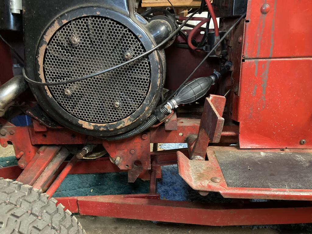

SylvanLakeWH 27,534 #11 Posted December 15, 2020 Did it couple years ago and just put new one on because old cheap one cracked... works like a charm... fuel filter between tank and bulb... As always, things go better with pics: 7 Share this post Link to post Share on other sites
Ed Kennell 40,486 #12 Posted December 15, 2020 I have primer bulbs on all mine. Same location as in Jim's picture so I can reach it from the seat. They all start with a bump of the starter...no cranking at all. Your battery and starter will thank you. 5 2 Share this post Link to post Share on other sites

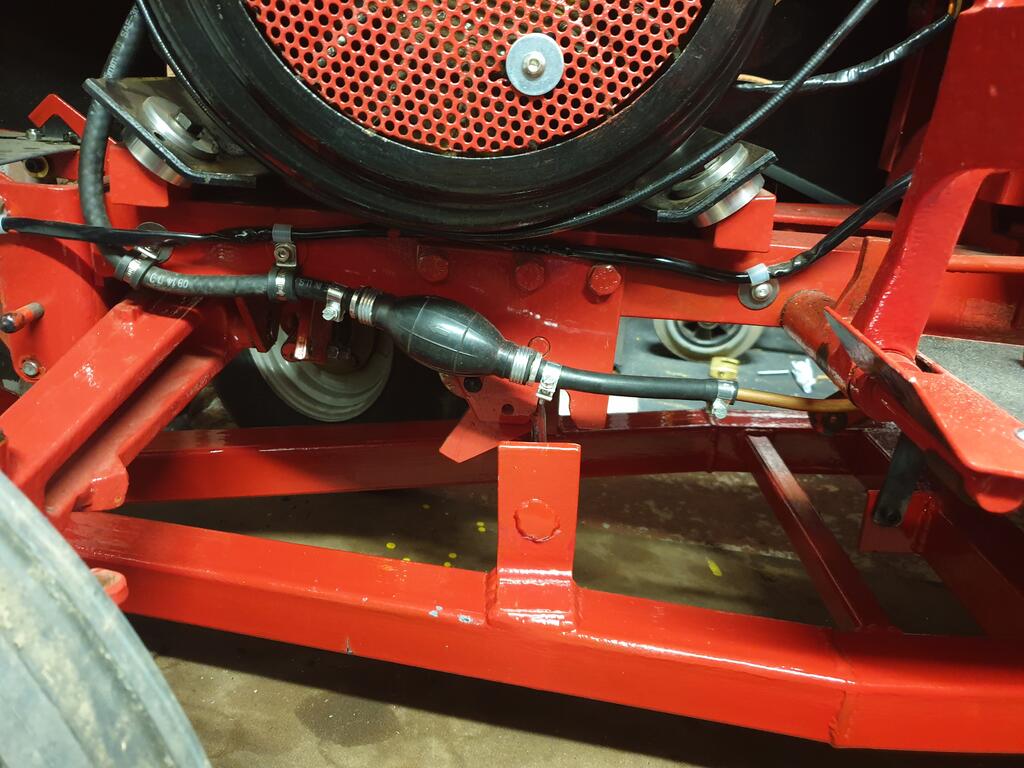

Mickwhitt 5,016 #21 Posted December 15, 2020 This is mine, grafted into the fuel line beneath the engine cowl. Works really well but as some have said before, only needed if the tractor has been stood a while. 1 Share this post Link to post Share on other sites
