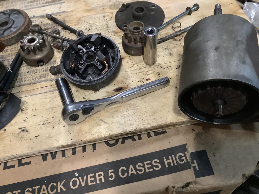

Pullstart 64,620 #1 Posted December 14, 2020 So once I get this cap cleaned up, what’s the trick to get all the springs and pieces aligned for re-assembly? Share this post Link to post Share on other sites

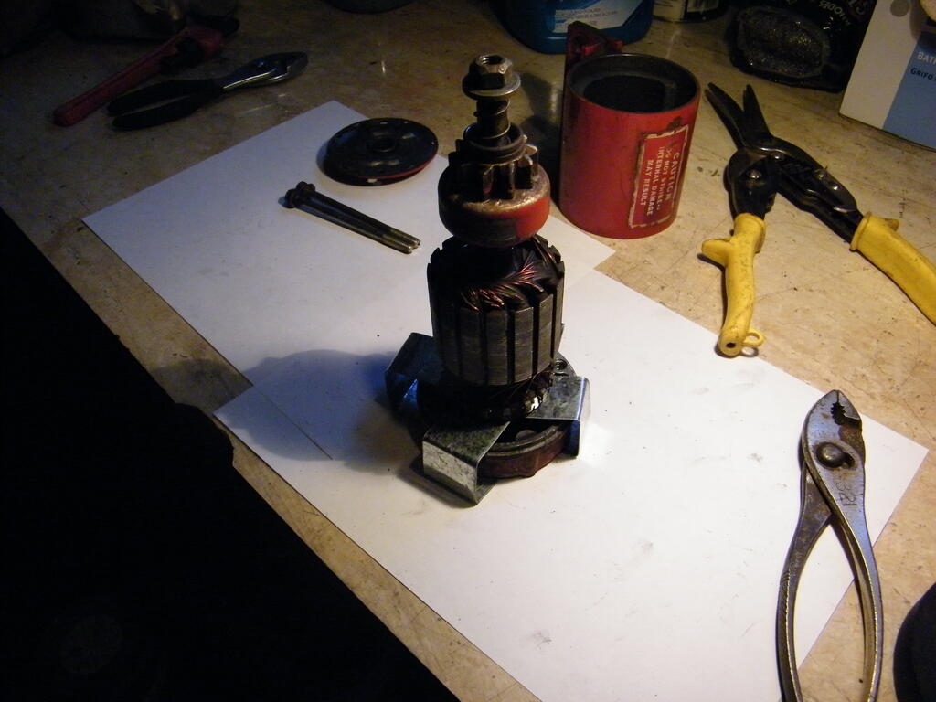

Pullstart 64,620 #5 Posted December 14, 2020 1 minute ago, pfrederi said: or don't take it a part in the first place I intended to clean up the other end and apply a dab of grease... when it all popped apart. I got it, but it likely wasn’t pretty looking in the shop for a minute! 1 Share this post Link to post Share on other sites

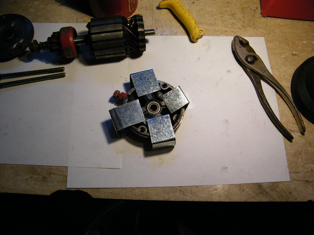

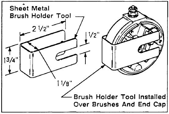

squonk 42,584 #7 Posted December 14, 2020 (edited) Courtesy of the Dino: Edited December 14, 2020 by squonk 6 4 2 Share this post Link to post Share on other sites

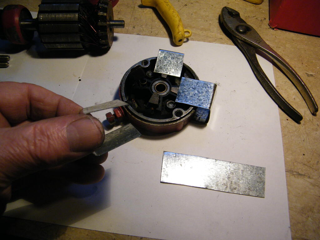

Pullstart 64,620 #8 Posted December 14, 2020 2 hours ago, squonk said: Courtesy of the Dino: That would have been nice. I was thinking a heavy plate to hold them all down, slotted to allow removal, over engineering at it’s finest. A handful of tin scraps and whallaah! 1 Share this post Link to post Share on other sites
Stormin 9,983 #9 Posted December 14, 2020 I use Stanley knife blades. Just watch your fingers. Share this post Link to post Share on other sites

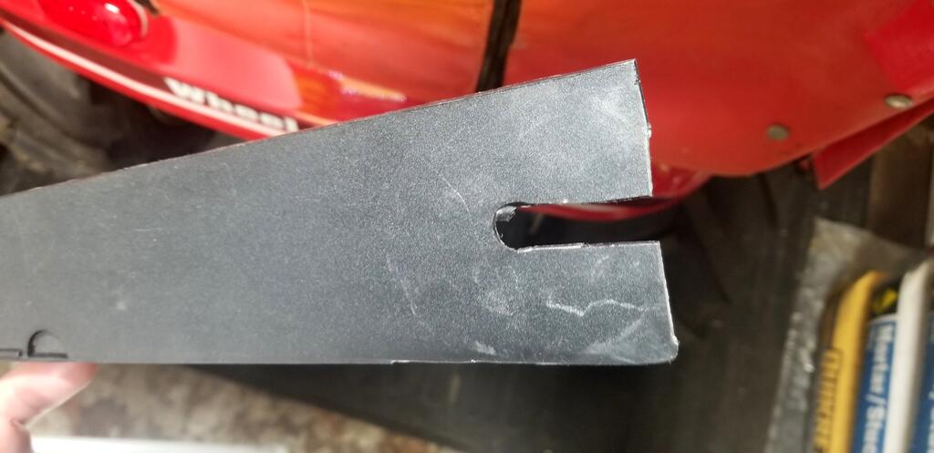

AMC RULES 37,147 #10 Posted December 14, 2020 Just took an old piece of plastic and cut into it a slot for the starters shaft. 3 Share this post Link to post Share on other sites
