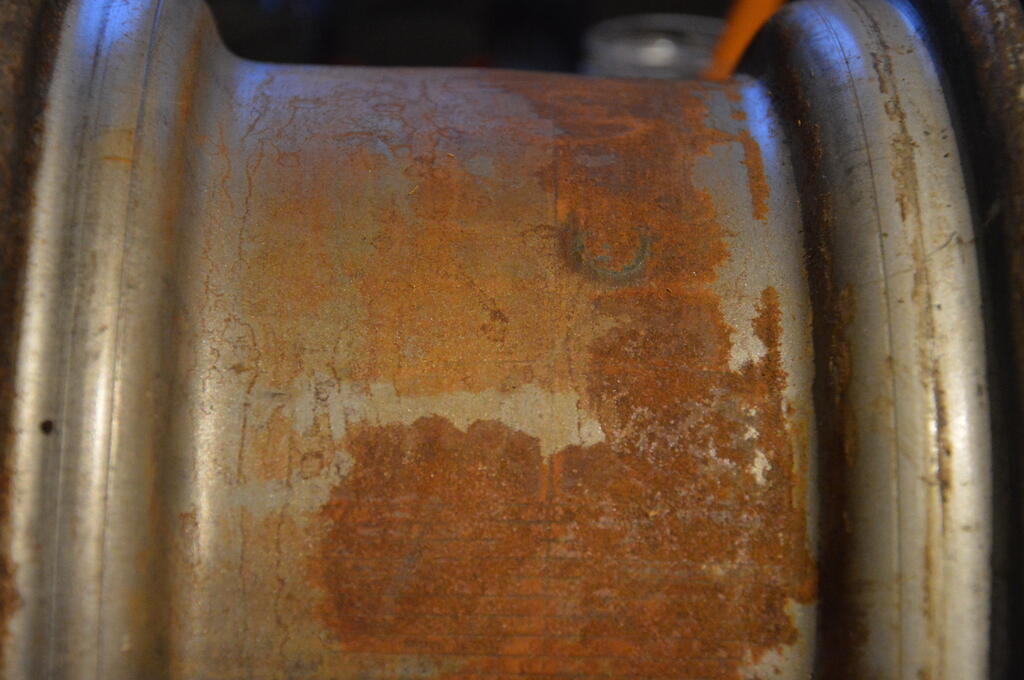

Maxwell-8 4,366 #11 Posted December 22, 2020 (edited) Vinegar, isn't the best for me, i painted it on some wheels and the deep rust got less, but there was more surface rust. Couldn't was it of, so sanding was the only option. I am gone drop off the rims to get sandblasted. Would it be worth getting a sandblast set-up? Edited December 22, 2020 by Maxwell-8 Share this post Link to post Share on other sites
ebinmaine 69,901 #12 Posted December 22, 2020 8 minutes ago, Maxwell-8 said: Vinegar, isn't the best for me, i painted it on some wheels and the deep rust got less, but there was more surface rust. Couldn't was it of, so sanding was the only option. I am gone drop off the rims to get sandblasted. Would it be worth getting a sandblast set-up? Sandblasting cabinet is one of those tools that is a larger investment and very much worth it to you if you're going to be planning on doing multiple restorations and repairs over the next few years.. 1 Share this post Link to post Share on other sites
Maxwell-8 4,366 #13 Posted December 22, 2020 (edited) 9 minutes ago, ebinmaine said: Sandblasting cabinet is one of those tools that is a larger investment and very much worth it to you if you're going to be planning on doing multiple restorations and repairs over the next few years.. Do you have one? The thing is you have to remove ALL the rust, or you did all that effort for nothing. I feel you can only accomplish it with a sandblaster. Edited December 22, 2020 by Maxwell-8 Share this post Link to post Share on other sites
