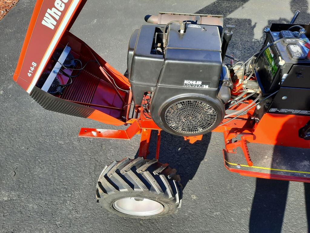

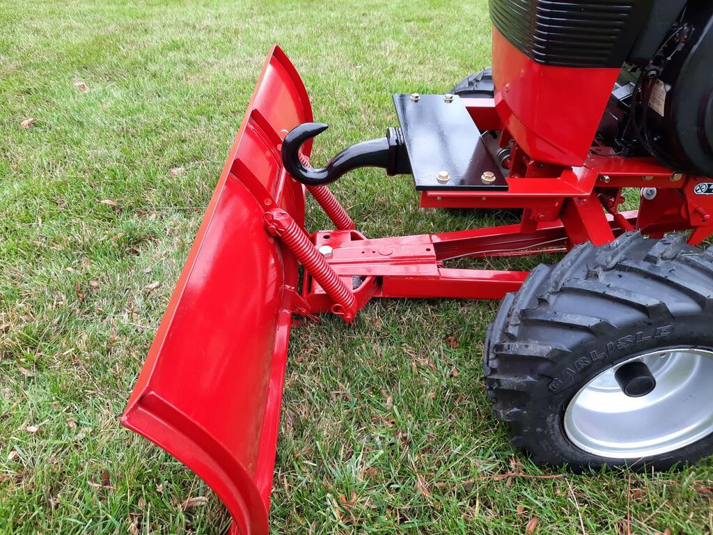

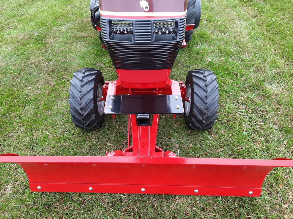

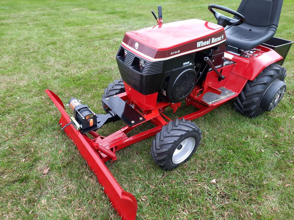

David414 289 #1 Posted December 12, 2020 This is a front hitch I designed for my 414-8 WH. Material is 2" x 2" x .375 thick angle iron that is bolted directly to the frame rails using three, 3/8", grade 8 bolts per side. The hitch is angled outward from the edge of the tractor frame to allow the engine hood to fully open between the hitch rails. Bolted to the hitch frame rails, using four 3/8" grade 8 bolts, is a 3/8" steel plate with a 2" receiver that will accept standard 2" shank, such as tow hooks, 2" towing balls, and a 3,500 electric winch. What ever fits in the front, will also fit my rear hitch including my weight box. 7 5 Share this post Link to post Share on other sites
David414 289 #2 Posted December 12, 2020 Some additional photos for the front hitch.o's 7 6 Share this post Link to post Share on other sites

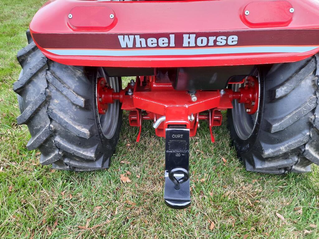

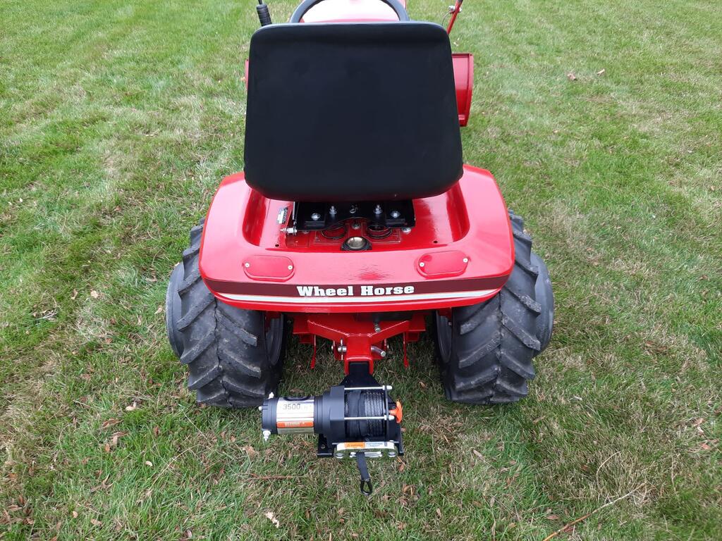

scWHhauler 96 #7 Posted December 13, 2020 did you make the rear hitch Share this post Link to post Share on other sites
David414 289 #8 Posted December 13, 2020 No. Rear hitch made by Tom Rupprecht, Saginaw, MI 989-213-2690 Share this post Link to post Share on other sites
