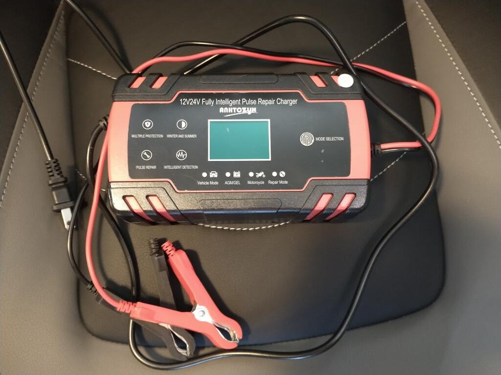

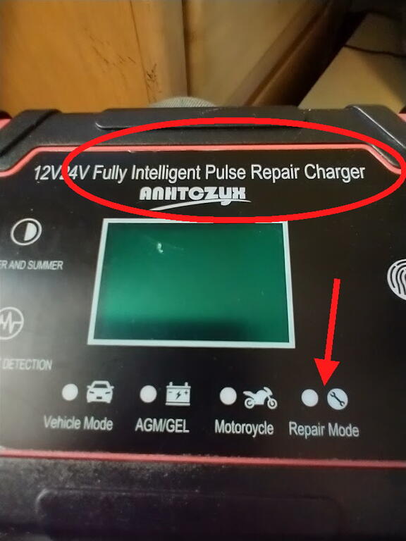

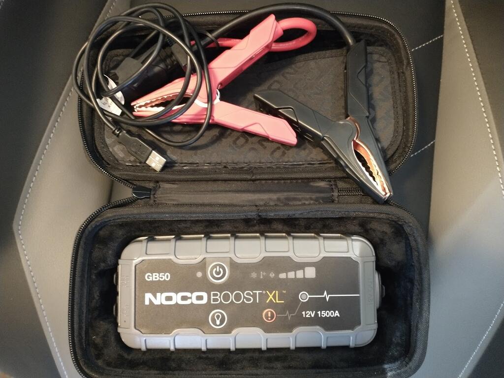

rmaynard 15,892 #35 Posted January 13, 2021 (edited) I know this thread has died, but like the battery in my Tacoma, I thought that I would resurrect it. I parked my truck over a week ago and have not started it since. When I went to start it Monday, the battery barely turned it over fast enough to start it, but it did. So I drove into town for a haircut. That normally would have been enough to charge it sufficiently for a restart a half hour later, but when I came out, the battery was dead. I always carry one of these with me. and after giving myself a hotshot, I drove home and put my new Chinese battery charger on it. This little guy only cost me $34.00 delivered, and I've only ever used it to charge a tractor battery last summer. So I hooked it up at around 1:00 pm, and by 8:00 pm it was not taking a charge. So I left it on all night. The readout on the charger said that the battery needed service. So I removed the battery, grabbed the wife's car and took it to my local auto parts store for them to test. The verdict was, "yup, you got a dead battery", and they proceeded to offer me a new one for $190.00. I did not buy it. I took the old battery home and hooked it up again to my little Chinese friend, this time setting it to the repair mode as shown below. Well, what to my joy and surprise did I see this morning, but a fully charged battery. It's all magic to me, but whatever that Fully Intelligent Pulse Repair mode is, it worked, and saved me $190.00 Edited January 13, 2021 by rmaynard 1 1 Share this post Link to post Share on other sites

rmaynard 15,892 #37 Posted January 13, 2021 That looks just like mine. I'll let you know how the battery "repair" holds up, but so far so good. 3 Share this post Link to post Share on other sites
DennisThornton 4,771 #38 Posted January 13, 2021 Please do. I have one in my cart. Some say it's nonsense, some it won't fix all batteries, some that it might take days and others that it saved them LOTs of $$$. If this saves one lawn mower battery it's paid for! 1 Share this post Link to post Share on other sites

Handy Don 13,284 #42 Posted January 14, 2021 On 1/13/2021 at 6:24 PM, rmaynard said: It's all magic to me, but whatever that Fully Intelligent Pulse Repair mode is, it worked, and saved me $ My son lent me his "intelligent charger" and it has extended the life a battery we were about to write off. An older, basic charger had charged it to the right voltage, but the newer charger seemed to give it more capacity to crank. I'm sure a lot depends on the state/condition of the battery to start with and we sure weren't scientific with our methodology! 2 Share this post Link to post Share on other sites
