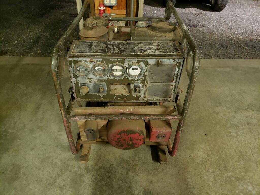

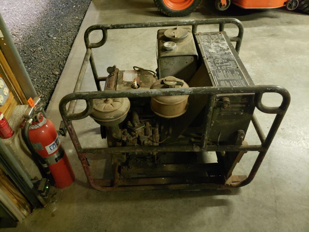

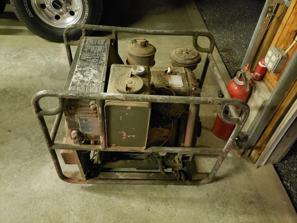

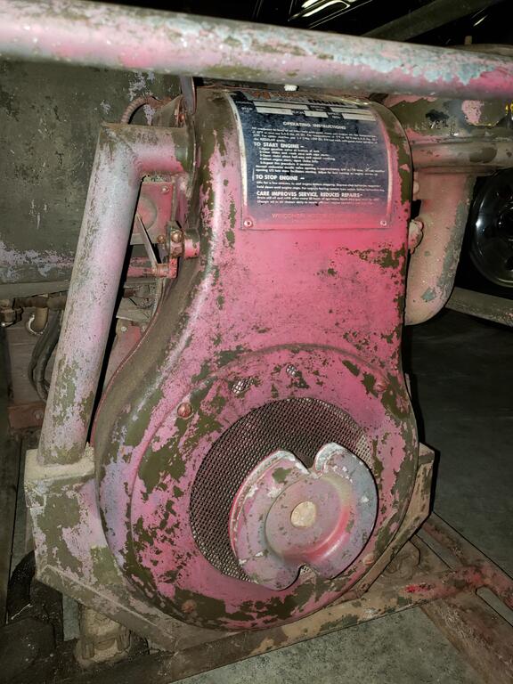

71_Bronco 1,072 #12 Posted December 10, 2020 (edited) Picked it up tonight. Haven't found much on this unit. I found one old ebay listing with some info, but not much else. From what I've gathered, its a 3,300 watt unit (3,600 surge). Powered by a 6hp Wisconsin engine, single cylinder. If the hour gauge is correct, this generator only has about 90 hours on it. Someone added some home-use plugs to it, that I will need to address. Will get some better pics later, but this should do for now. Edited December 10, 2020 by 71_Bronco 2 1 Share this post Link to post Share on other sites

71_Bronco 1,072 #14 Posted December 10, 2020 Oh, forgot to add the price... a whopping $50. Figured I couldn't go wrong for that kind of money. 2 Share this post Link to post Share on other sites
Sparky-(Admin) 21,780 #15 Posted December 10, 2020 Is this to power your house in an outage? At 3300w/125v your getting 26.4 amps of usable power or 14.4 per leg if your drawing it at 230volts. That lower right hand outlet should be a 20amp 250volt 4 wire receptacle (L14-20). Good luck with it! Share this post Link to post Share on other sites
71_Bronco 1,072 #16 Posted December 10, 2020 4 hours ago, Sparky said: Is this to power your house in an outage? At 3300w/125v your getting 26.4 amps of usable power or 14.4 per leg if your drawing it at 230volts. That lower right hand outlet should be a 20amp 250volt 4 wire receptacle (L14-20). Good luck with it! Originally, I didn't have any plans for it, except to pick it up and see if I could get it running and working. The 2 plugs mounted to the plywood are not part of the factory wiring. I recently put in a 12' x 16' shed, and haven't run power to it, as most of the time I'm in the shed is during the day. I was considering putting this out in the shed to run some lights or small power tools if the need ever arose (obviously run it outside for exhaust reasons). I do have a 5,000 watt generator in my garage in case of a power outage (used it this past fall when we had that hurricane rip through, lost power for about a week). As of right now, game plan is to get it running and decide from there. But I figured for the price, gab it and see what happens. 3 Share this post Link to post Share on other sites
