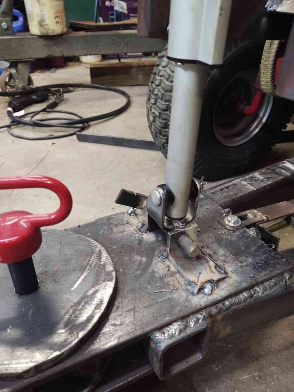

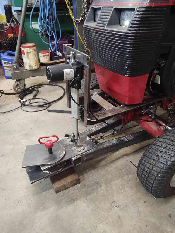

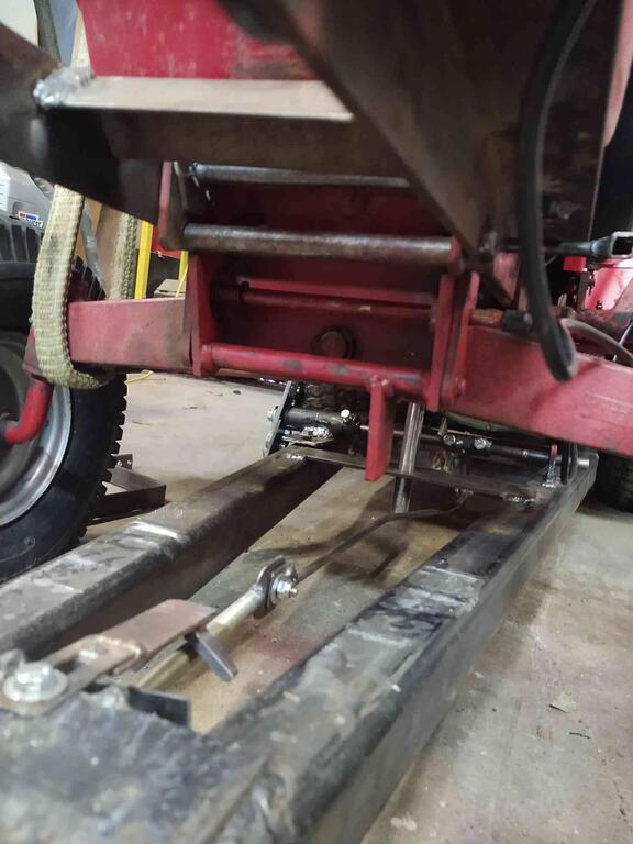

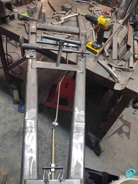

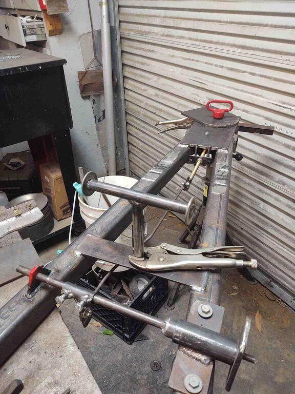

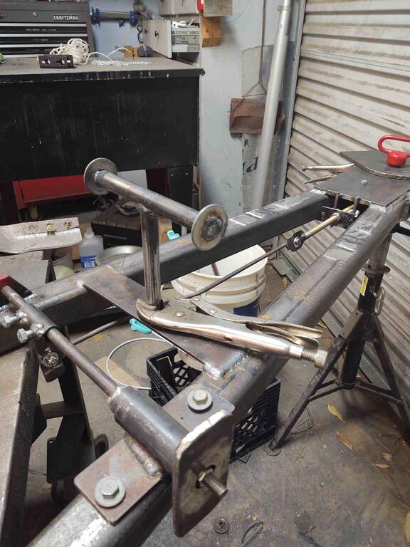

Mark Bartlett 83 #6 Posted December 26, 2020 Got back to my dozer blade project. I built a frame for the blade control actuator. It slides in and locks into place with the front attach o native hitch and has a rod (the handle in the pics) through it and the tractor frame. 1 Share this post Link to post Share on other sites
