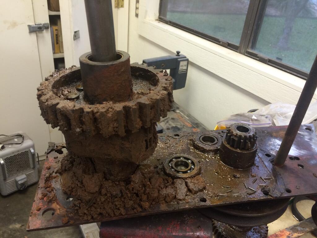

Just to give you hope!
Even a transmission filled with this rusty/dirty caked oil/grease/mud can be saved.
