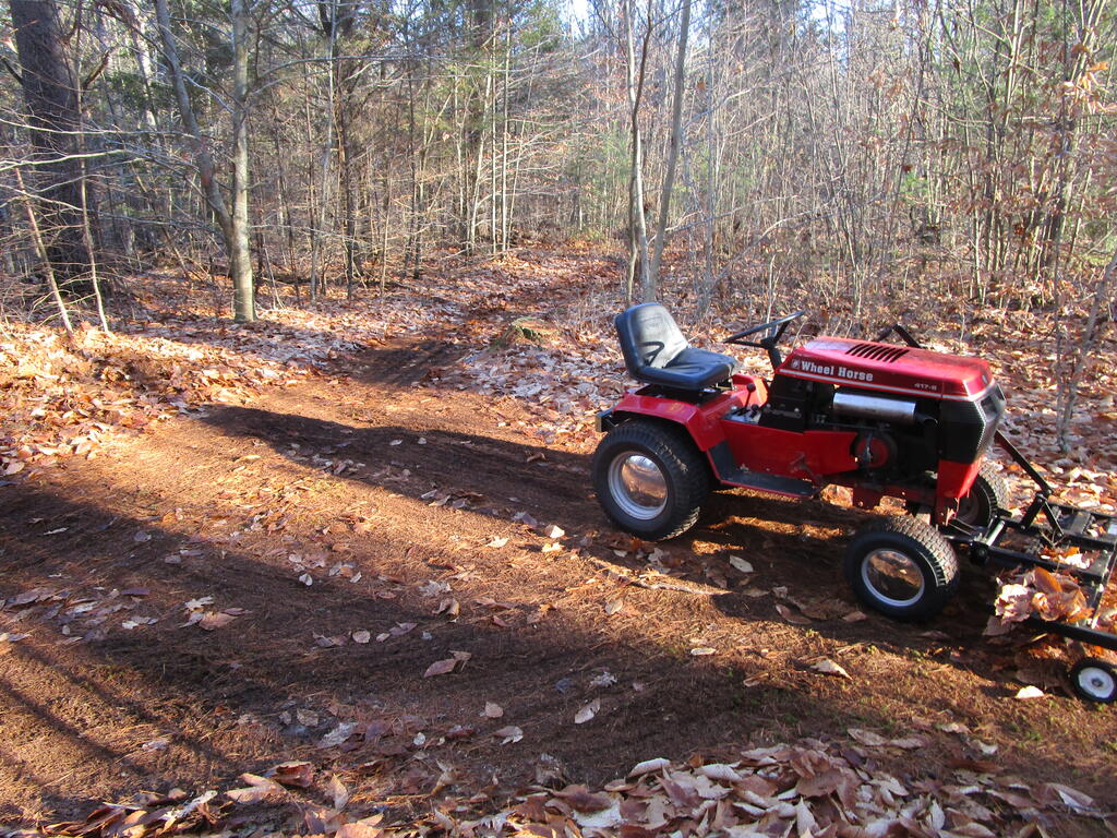

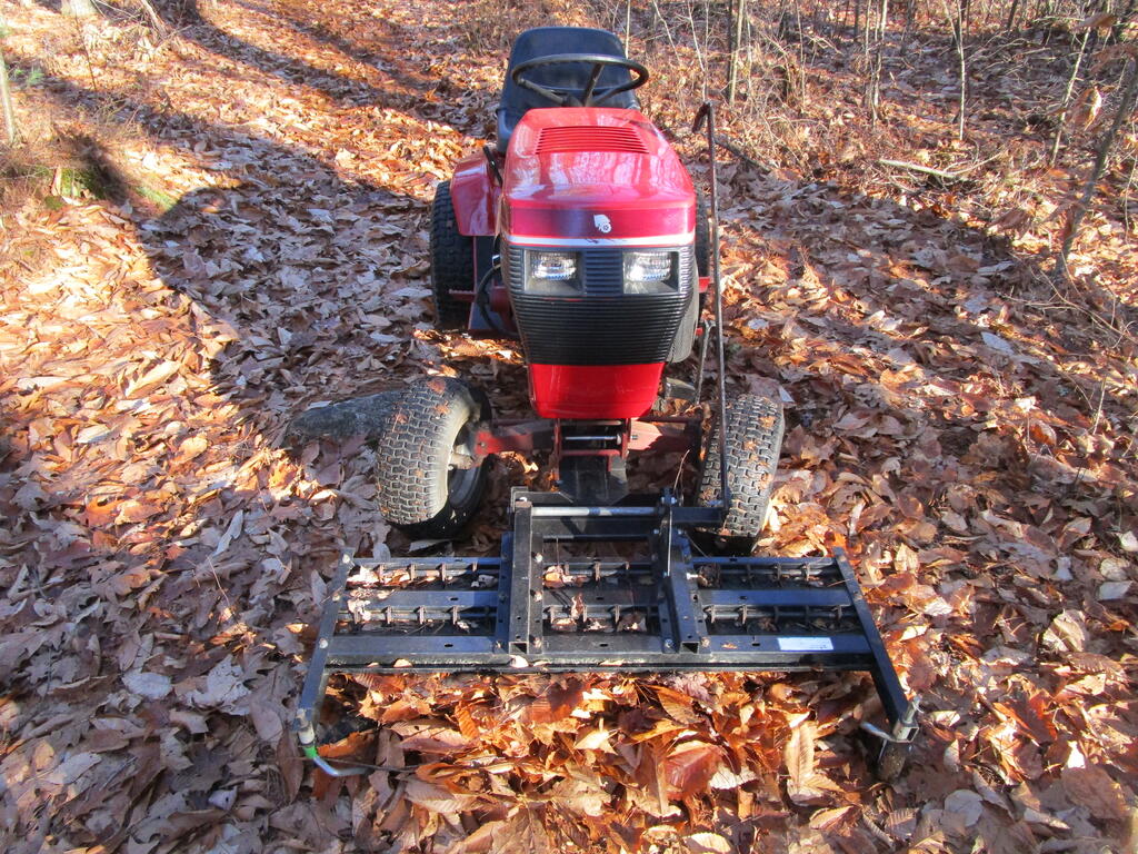

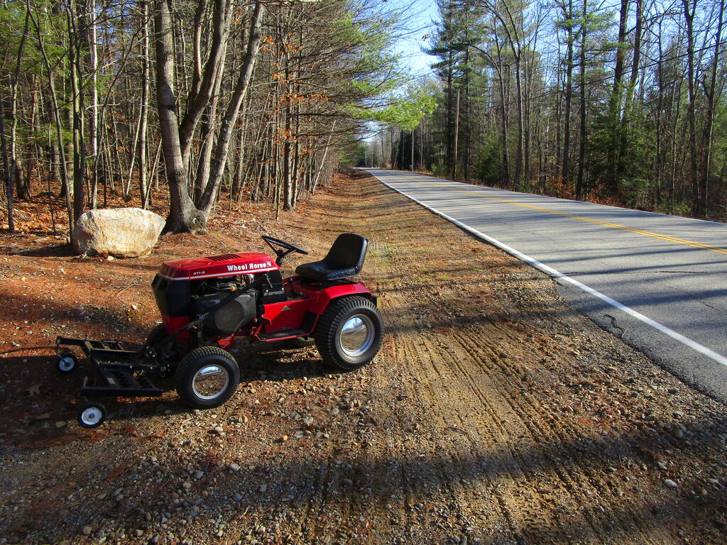

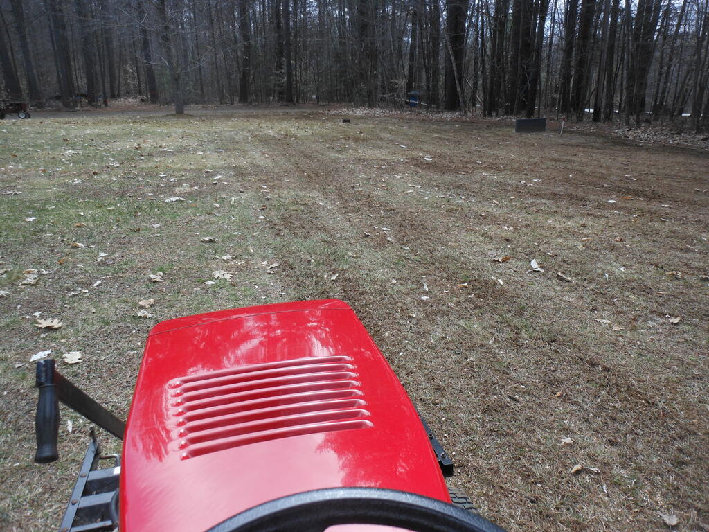

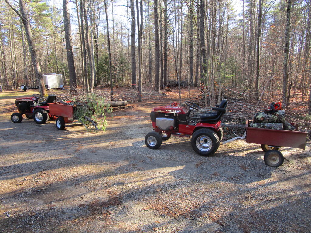

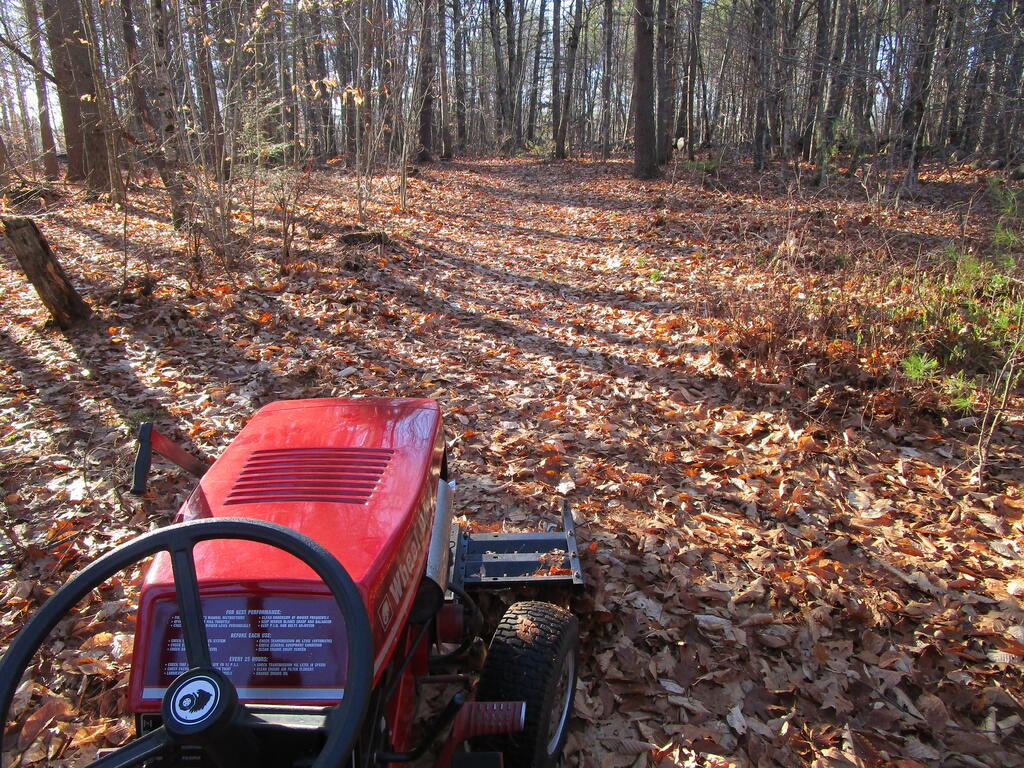

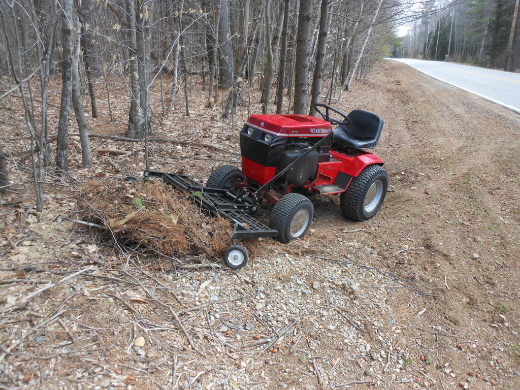

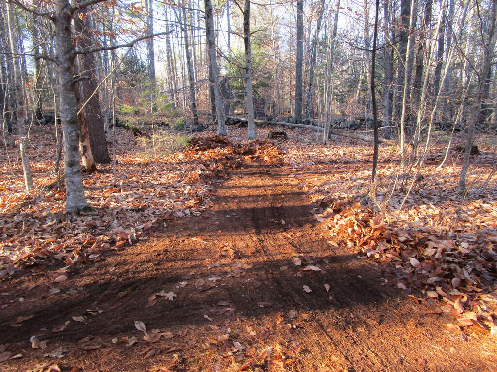

JCM 10,017 #1 Posted November 29, 2020 Had the 3 Kohler Twins out today helping around the yard. Decided to finish the tree work clean up along the driveway. Then did the roadside with the tine rake and then out back to maintain the trail system. Removed a lot of leaves and twigs from the trail system and it was such a nice day today being this late in November I decided to get some seat time in out back. Tine raking the trails reminds me a lot like plowing snow, a lot of back and forth especially when coming to an intersection. But seeing the looks on the faces of those who attended the M & G in September it makes it all worth the effort. Also installed a set of rear hubcaps on the 418-A that were purchased from another member on here. All in all a productive day and nice to see water in the brook after a very dry summer. 7 5 1 2 Share this post Link to post Share on other sites
Sparky-(Admin) 22,065 #2 Posted November 29, 2020 Smoooooth trails are the best! The ones out back behind my property just about shake your kidneys out 1 3 Share this post Link to post Share on other sites
ebinmaine 70,729 #3 Posted November 29, 2020 VERY nice work! @Sparky ours are so rough we're almost never out of second gear at 3/4 throttle. Good stuff. 3 Share this post Link to post Share on other sites

DennisThornton 4,771 #6 Posted November 30, 2020 Wow! I've got to have one of those tine rakes! Details, close-ups and info please! I bought some rubber/steel tines but haven't gotten around to making a frame. Seeing what you can do with it is awesome! I have both a 4ft and 6ft rear but I'm guessing you already know the downsides to rear mounts. 1 Share this post Link to post Share on other sites

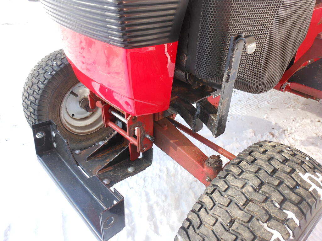

JCM 10,017 #7 Posted November 30, 2020 I have never used a rear mount. This came with my 91 520-H when I bought in 2002. Once the front mount is on the tractor rake takes 2 minutes to install, 1 pin with a washer and hairpin cotter at either end. Glad you like it Dennis and nice to hear from you back on RS. I have pics showing the mounting bracket and possibly ID tag info,just need to locate, stay tuned @DennisThornton . 1 2 Share this post Link to post Share on other sites
DennisThornton 4,771 #8 Posted November 30, 2020 5 hours ago, JCM said: I have never used a rear mount. This came with my 91 520-H when I bought in 2002. Once the front mount is on the tractor rake takes 2 minutes to install, 1 pin with a washer and hairpin cotter at either end. Glad you like it Dennis and nice to hear from you back on RS. I have pics showing the mounting bracket and possibly ID tag info,just need to locate, stay tuned @DennisThornton . Thank you, it's real good to be back! You have to drag over what you want to clean up with a rear mount, breaking branches, shoving them into the ground and then drag the mess off somewhere, lift and dump, as opposed to what you are doing. Far better than nothing but far less than what you have and what you are doing! Yes indeed! More info and pics would be appreciated! 2 Share this post Link to post Share on other sites

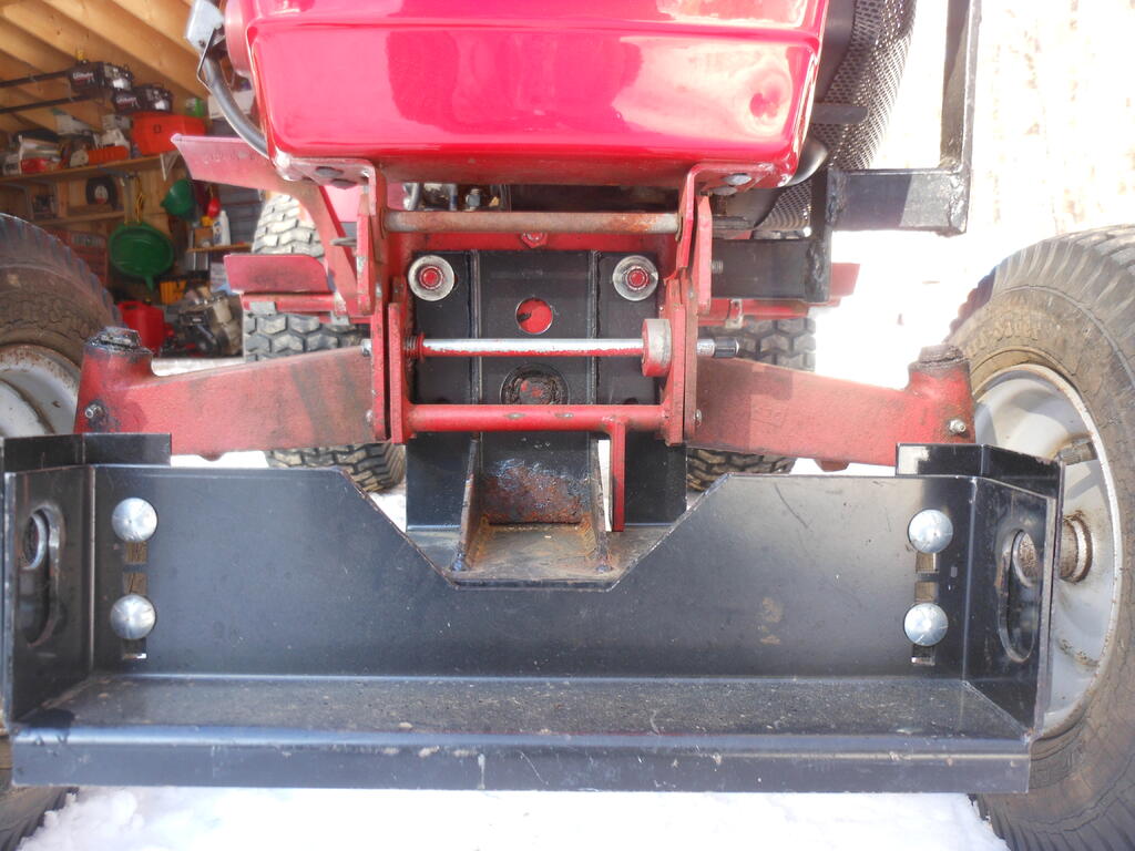

JCM 10,017 #10 Posted November 30, 2020 Separate piece Eric, it goes behind the Attach o matic. Somewhere I have a picture of it on here that Ed K wanted to see how it mounted, you think I can find it . 1 Share this post Link to post Share on other sites

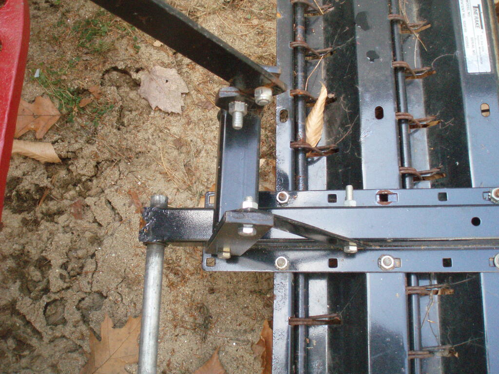

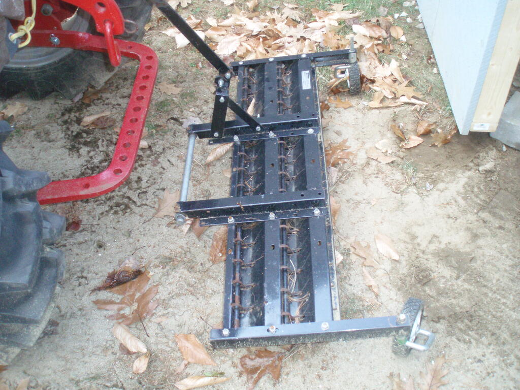

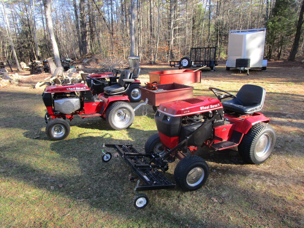

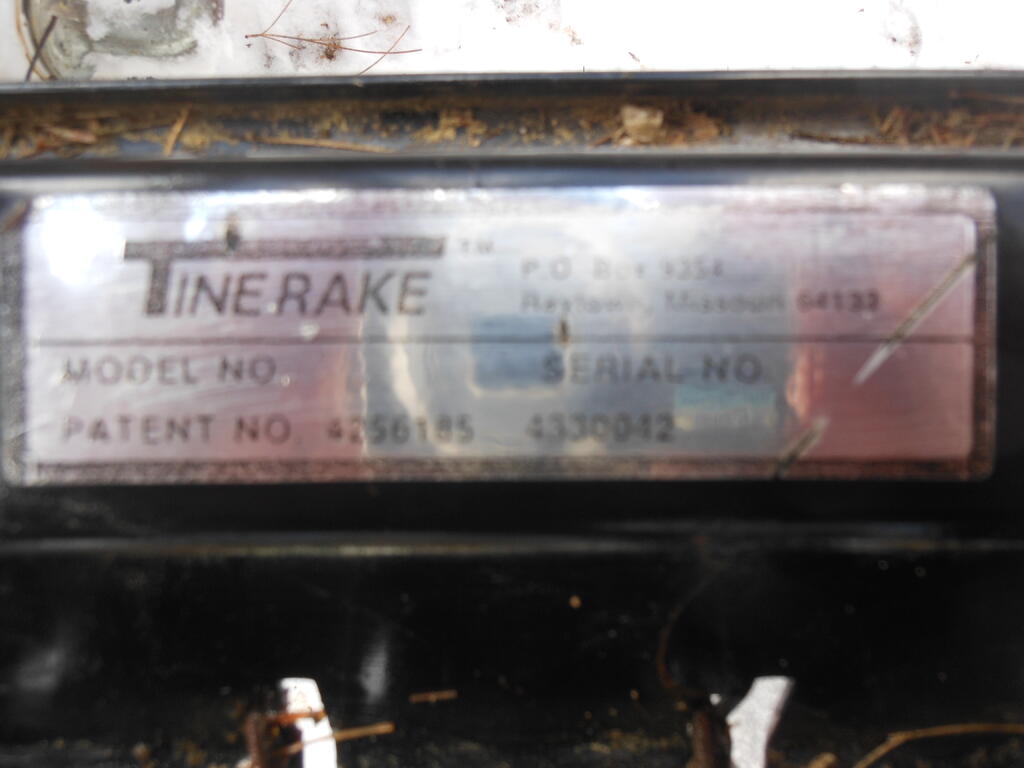

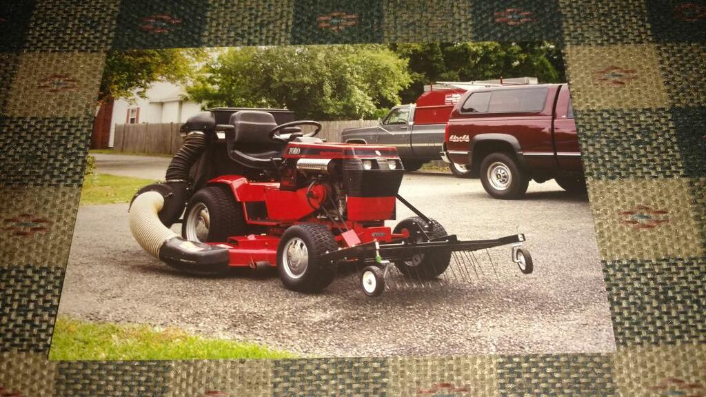

JCM 10,017 #12 Posted November 30, 2020 Found the remaining info @DennisThornton . You can still leave the mower deck on for use with this attachment. Rake, mow and bag all in one if so desired as pictured on the 520, I just use the tine currently. Hope this inspires you. Jim 1 1 Share this post Link to post Share on other sites
ebinmaine 70,729 #13 Posted November 30, 2020 Is that a Wheelhorse attachment Jim? Are there other things that can be mounted in the front of the tractor using that same bracket? Share this post Link to post Share on other sites
JCM 10,017 #14 Posted November 30, 2020 (edited) I believe Tine Rake is the MFG out of Missouri. Not WH Eric. Have not looked into if they are still around. That attachment along with a PECO bagger,48'' SD deck and 91 520 -H was $ 7000.00 when sold new. Bought from a childhood friend who bought that from Leo. Raytown. Missouri no longer in business, just checked. Didn't answer your question about mounting something else. I'm sure you could dream up something. Edited November 30, 2020 by JCM 1 Share this post Link to post Share on other sites

DennisThornton 4,771 #17 Posted December 1, 2020 6 hours ago, JCM said: Found the remaining info @DennisThornton . You can still leave the mower deck on for use with this attachment. Rake, mow and bag all in one if so desired as pictured on the 520, I just use the tine currently. Hope this inspires you. Jim Pictures saved! Thank you! Could I ask for another detailing the lift? 1 Share this post Link to post Share on other sites
JCM 10,017 #18 Posted December 1, 2020 @DennisThornton If you look at the left front frame rail you will see a hook attached, then check out the 417 on the roadside with the pile of debris in front of it. there you will see the lever with a hand grip, all manual lift, simple. Share this post Link to post Share on other sites
DennisThornton 4,771 #19 Posted December 1, 2020 2 minutes ago, JCM said: @DennisThornton If you look at the left front frame rail you will see a hook attached, then check out the 417 on the roadside with the pile of debris in front of it. there you will see the lever with a hand grip, all manual lift, simple. I completely overlooked the hook! I understand now! Boy it does a nice job! I might add some heavier tines in the front that ride a bit higher to catch larger debris. Thank you! 1 Share this post Link to post Share on other sites
Pullstart 64,531 #20 Posted December 1, 2020 12 hours ago, DennisThornton said: Pictures saved! Thank you! Could I ask for another detailing the lift? 14 minutes ago, JCM said: @DennisThornton If you look at the left front frame rail you will see a hook attached, then check out the 417 on the roadside with the pile of debris in front of it. there you will see the lever with a hand grip, all manual lift, simple. Is there anything that keeps the manual lift lever from hitting the hood or dash when it’s released? 1 Share this post Link to post Share on other sites
JCM 10,017 #21 Posted December 1, 2020 @pullstart No, sometimes the lever goes behind the hook and rubs on the chaff screen when pushing a lot of debris because the twin Kohler hangs out over the frame rail and then I remove the screen in the spring then lightly sand and spray a light coat of semi-gloss or satin black to keep it nice. The lift lever in it's normal position does not come near the hood. Share this post Link to post Share on other sites
Pullstart 64,531 #22 Posted December 1, 2020 I wonder if a guide bar could be bolted as an extension behind that hook latch Jim? 1 Share this post Link to post Share on other sites
Lee1977 7,037 #23 Posted December 1, 2020 (edited) 1 hour ago, DennisThornton said: I completely overlooked the hook! I understand now! Boy it does a nice job! I might add some heavier tines in the front that ride a bit higher to catch larger debris. Thank you! If I were build that hitch I would attach it to the tac-a-matic so it could be easily removed. A 5/8" rod and a hook under the WH hitch is all you need. The bolt is not required, I used it because I had it. Edited December 1, 2020 by Lee1977 2 Share this post Link to post Share on other sites
DennisThornton 4,771 #24 Posted December 1, 2020 I was surprised to see that the hitch wasn't utilized and thought I would give that some thought later. Now here it is! And sooner! Thanks! 1 Share this post Link to post Share on other sites
