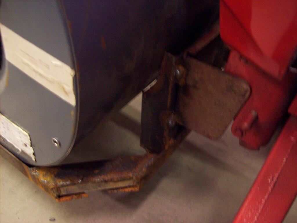

No pictures but if you have a nasty old mule drive that's all seized up and rusty don't toss it. The frame work can be used for a quick attach front accessory like a weight, sprayer, leaf blower ect.

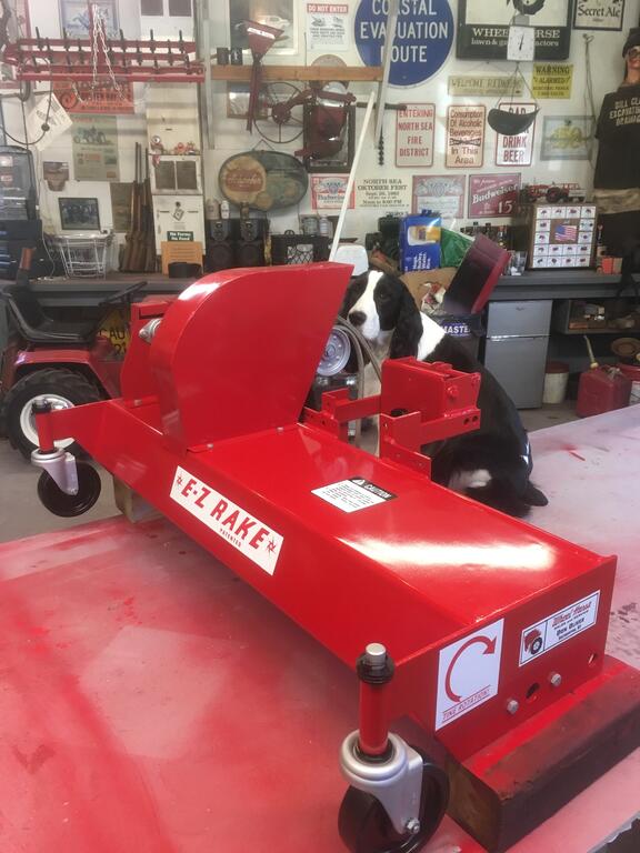

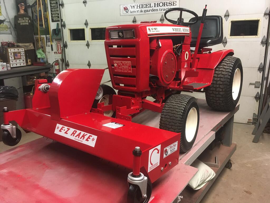

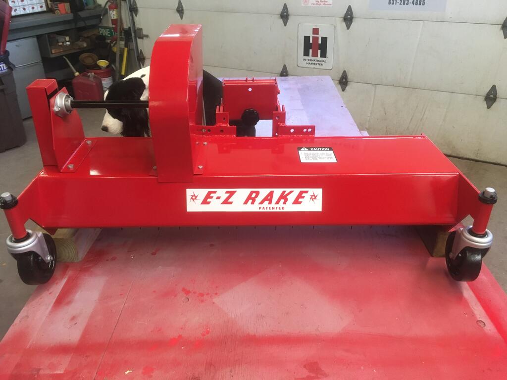

That’s exactly what I did when I purchased an EZ Rake and restored it. I wasn’t sure how I was going to mount it because the brackets it came with clearly were not for a Wheel Horse. Then the mule drive idea came into play and it works great. I used a lift tube from a snowblower to raise it. I have a pull behind spring tine de-thatcher that I’m thinking about mounting off a mule drive as well. Then I can de-thatch and vacuum up the thatch in one pass.

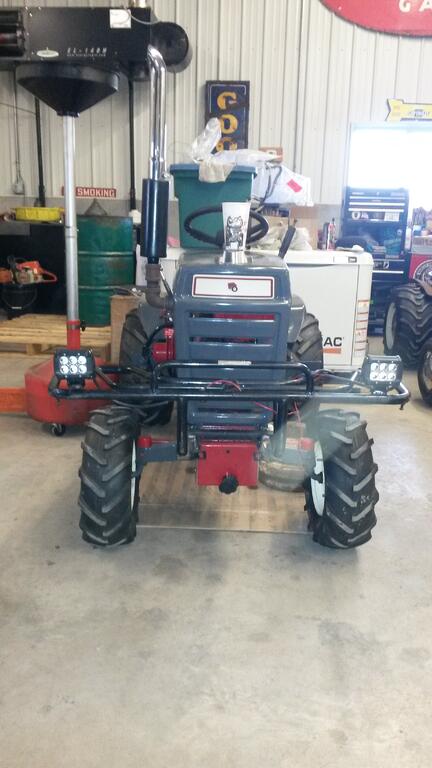

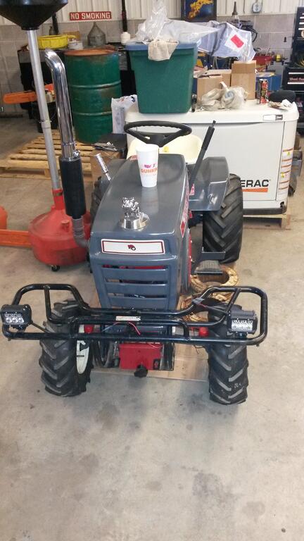

I used a front attach a matic bracket and a old atv rack and made a front rack for my main work machine. The dial on the frant bracket still has the function of leveling the rack, once you put it on. The rack is extremley useful for me. I often strap a 60 pound sand bag on there when im pulling trailers of firewood out. Helps keep the wheelies down on take off.

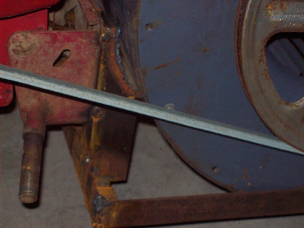

If you don't have an old mule drive all you need is a 5/8" rod and some metal a angle or plate. Here is mine I used a long 5/8" bolt because I had some and an angle to keep it from swing down and hooked below
to keep it from swing up. If you are using it for a belt tightener you will want it to swing down.
