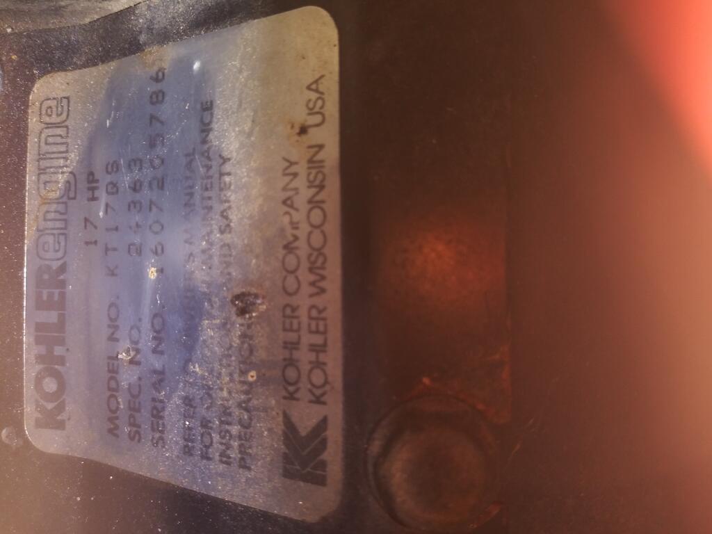

It’s hard to tell in the picture but it looks like that might be a series one.
Cee245
Here is the plate on the motor...
pfrederi
Spec 24300 and up is Series 2
