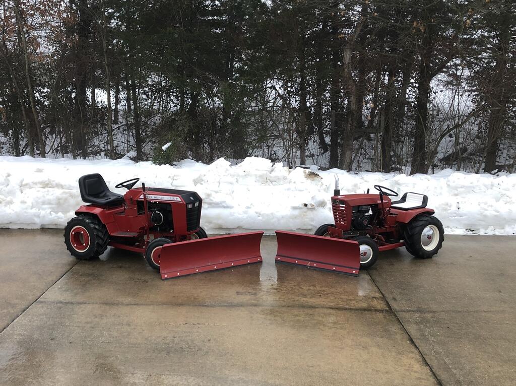

stevasaurus 22,991 #4 Posted November 17, 2020 My drive is level, so my B-100 is a snow blade machine. It is my heaviest horse and it just walks through snow. Notice the knobie rear tires...these are very good in snow. Like Bob said though, if you get about 6" out there, it is easier to move that and then go for seconds...rather then try moving a foot at a time. 3 1 Share this post Link to post Share on other sites

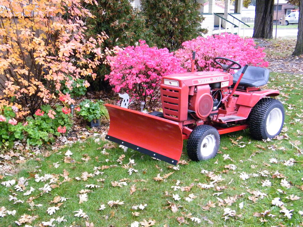

SylvanLakeWH 26,772 #5 Posted November 17, 2020 Good to see another Michigander! I plow 3 level driveways in SE Michigan with a C-105 10 hp. No weights or chains. No issues. Standard turf treads. Tried the chains once and the scratching was not acceptable to me or my two neighbors... If we are getting a bunch I just do it more than once... more seat time!!! 1 Share this post Link to post Share on other sites

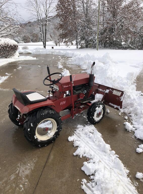

cschannuth 3,817 #9 Posted November 17, 2020 I plow with a 6.5 hp Predator as fast as I want in high gear and it never even notices so you should be fine. 4 1 1 Share this post Link to post Share on other sites
Achto 28,325 #10 Posted November 18, 2020 Good luck with your search. 24 minutes ago, cschannuth said: Looks like that was some wet heavy stuff too. 4 Share this post Link to post Share on other sites
Terry M-(Moderator) 2,180 #11 Posted November 18, 2020 2 hours ago, cschannuth said: I plow with a 6.5 hp Predator as fast as I want in high gear and it never even notices so you should be fine. That's Nice to see a 606 plowing Snow!! 1 2 Share this post Link to post Share on other sites
