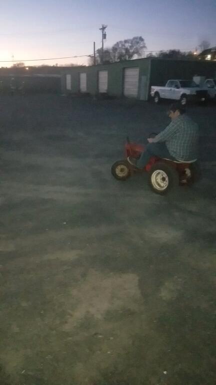

ccs002 79 #18 Posted November 18, 2020 It's running almost entirely under its own power now. I still need a governor spring so I have proper throttle control but I was at least able to go for a short ride with it. 1 1 Share this post Link to post Share on other sites
