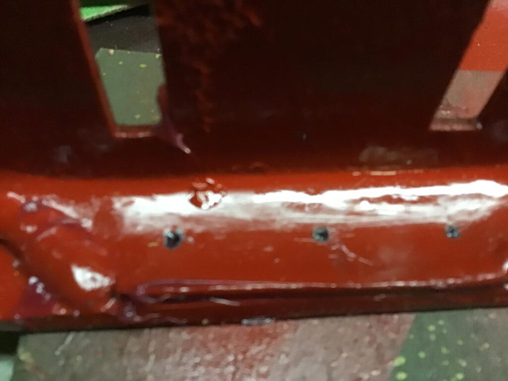

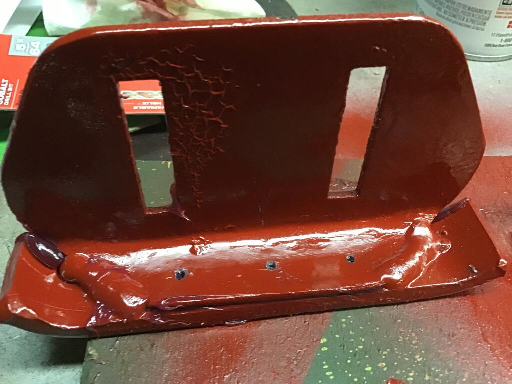

C-85 674 #1 Posted November 15, 2020 We have a Toro 5/21 snowblower with worn out skids so we've upgraded them. After the addition of some new steel, I didn't have a way to paint in between the layers and knew it would rust,so I drilled some holes in the top layer and used a needle point grease gun and greased it until I saw grease ooze out. I even used red grease, so it would match and for 'aesthetics' ! 4 1 Share this post Link to post Share on other sites
