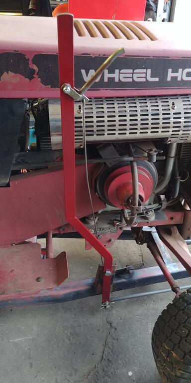

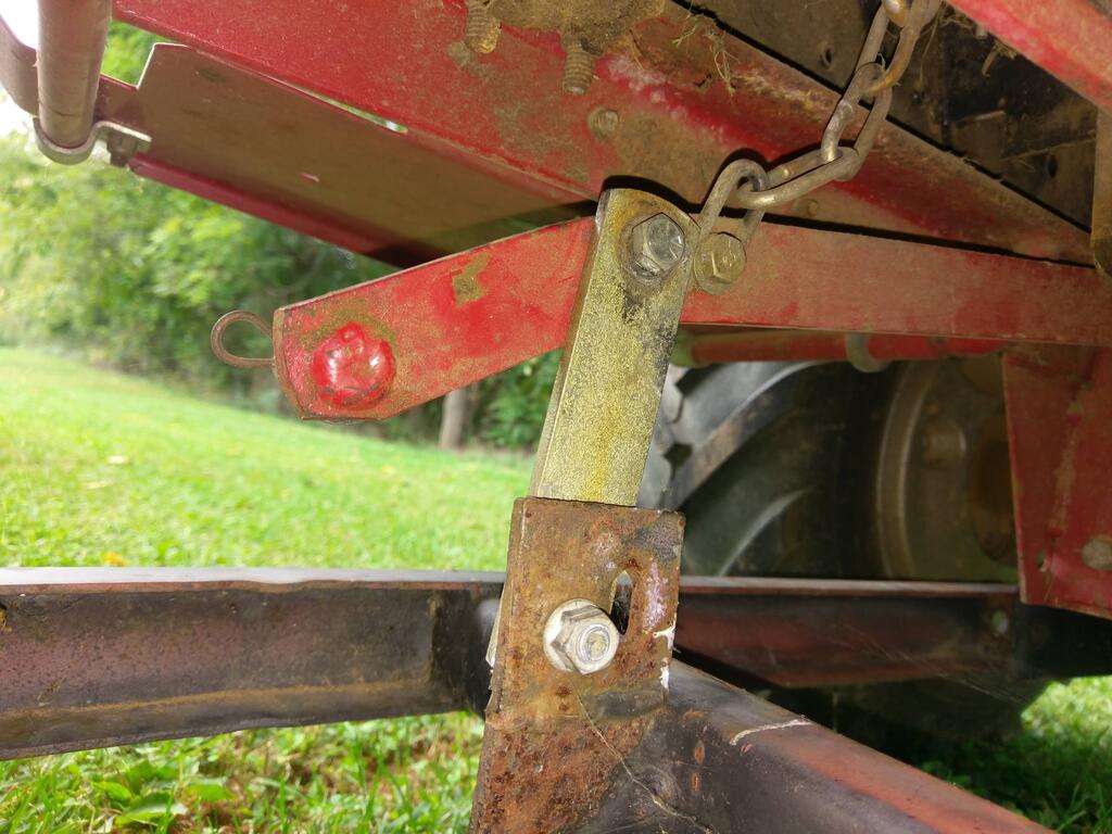

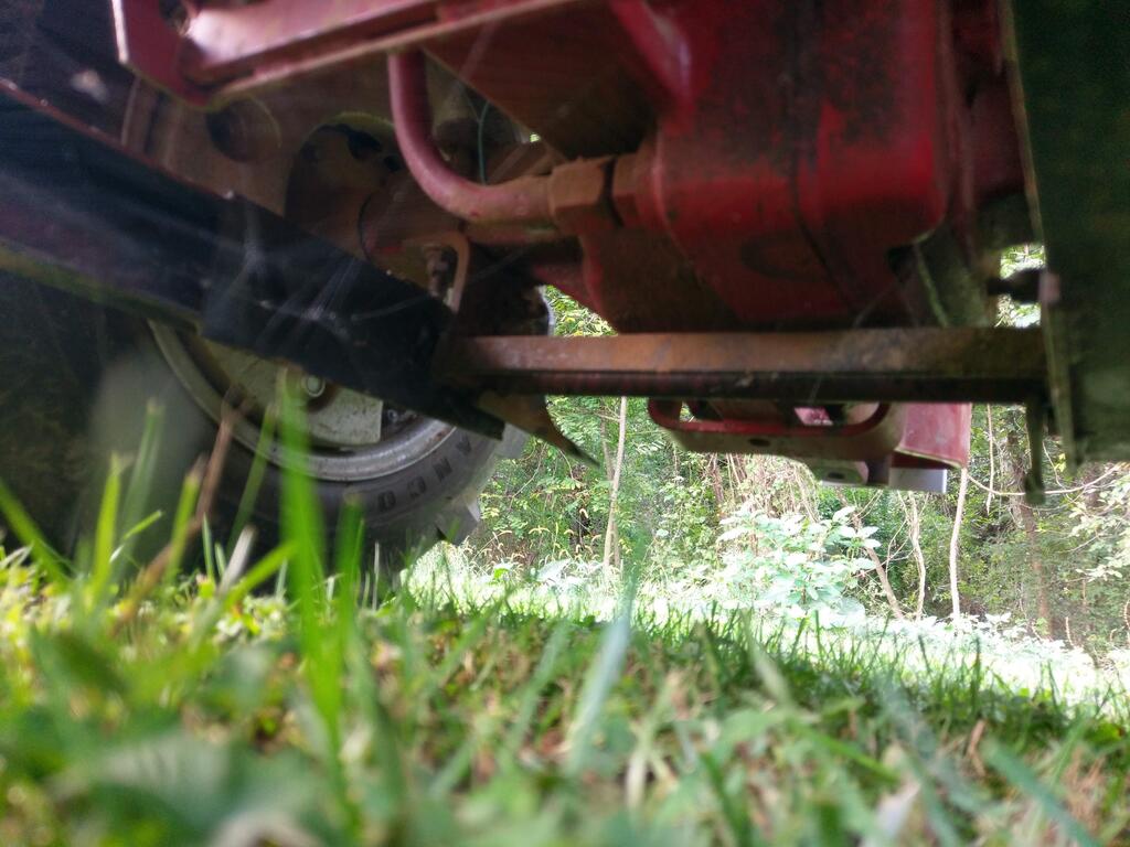

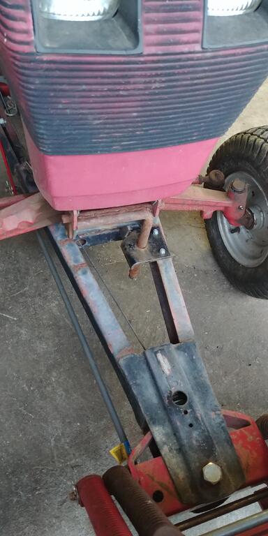

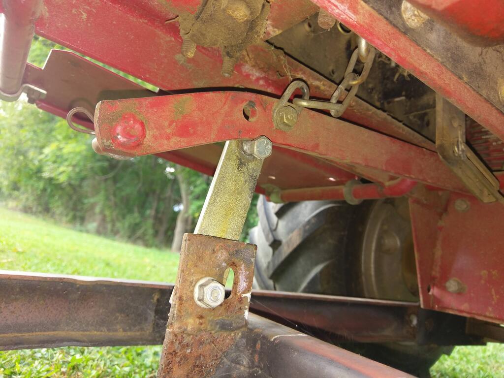

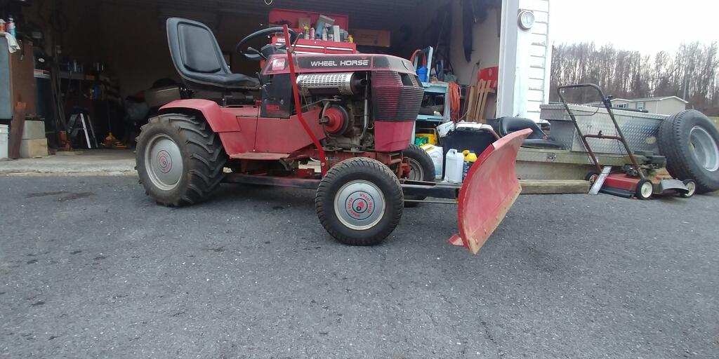

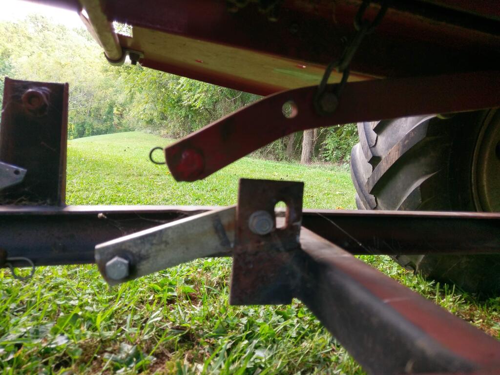

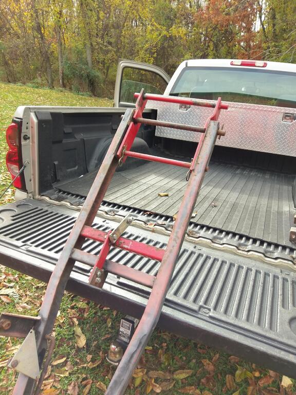

WVHillbilly520H 10,376 #8 Posted November 14, 2020 It it the shiny red parts added to the A frame... Unless you have an '88 or '89 straight axle 520... 90-97 has the swept forward front axle requiring the extension kit... Here's a brief pictorial of hitching up the snow plow using the "floating" lift link. Also my home brew front anti-sway bar, and the correct angle from seat lever. The extension kit can be procured from here... https://www.wheelhorsepartsandmore.com/brackets-linkages.html#!/Toro-Wheel-Horse-520-Snow-Plow-EXT-Kit/p/84954631/category=23566571. 2 Share this post Link to post Share on other sites
