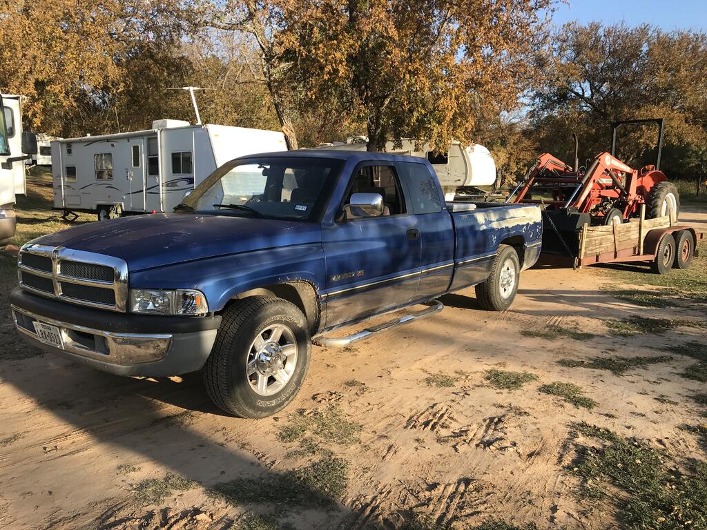

ZXT 2,401 #1 Posted November 10, 2020 (edited) I've needed a tractor with a bucket on it for a long time. I do a lot with cars, and dragging engines around by hand in the dirt got old real fast.. it also made my back feel old. A family member got a bigger tractor and was going to sell this, so I popped off and wound up with it. It's Yanmar YM2500, made in 78-79. Good running little tractor, and seem to be decent tractors from what I've read. Only a 25HP, but it should work for my needs. It's small enough that it'll get into fairly tight spots. Only issue with it is the brakes are stuck (Common problem and easily fixed, I just need to do it) so driving it on unlevel ground is a bit sketchy, and one ram on the loader leaks. Apparently the loader is a Chinese unit, and there isn't much info on it. When it comes to rebuilding hydraulic rams, are they all of similar design even if brands are different? It leaks on the down stroke and when you put pressure down with it. I figure it needs new seals/packing, but I've never been into one before so I'm not completely sure. For 1/3 the price of a new box store riding mower, and given the fact that it came with the loader and a mower, I think It'll pay for itself easily. Edited November 10, 2020 by ZXT 4 6 Share this post Link to post Share on other sites
