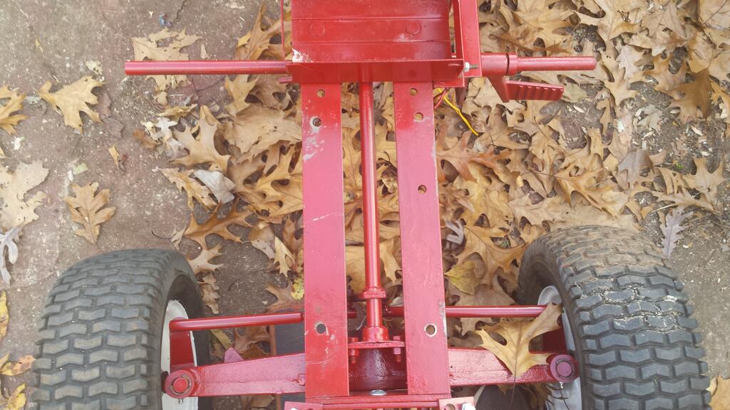

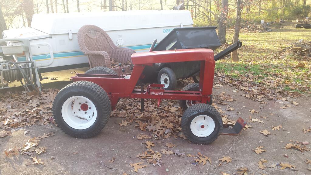

Zednoug 56 #1 Posted November 8, 2020 (edited) I have a 1972 raider 14 that I am restoring but I cant figure out how the engine attaches to the frame, parts manuals show an engine plate but dont show how tall it is. Edited November 8, 2020 by Zednoug Share this post Link to post Share on other sites
Ed Kennell 39,889 #2 Posted November 8, 2020 All the Kohlers I have use two bolts and nuts on the left side and two bolts inside the right frame rail into two tapped holes in the oil pan plate. The only plates I am aware of are the rocker plate engine mounts. 2 Share this post Link to post Share on other sites
rmaynard 15,820 #3 Posted November 8, 2020 (edited) 18 hours ago, Ed Kennell said: The only plates I am aware of are the rocker plate engine mounts. I know that the K-181's sat on a plate on mid/long frames, and that is shown in many of the parts diagrams. Edited November 9, 2020 by rmaynard Share this post Link to post Share on other sites
953 nut 56,900 #4 Posted November 9, 2020 You may have small base Kohler which will require a mounting plate. Take a look at this thread to see which you have. Share this post Link to post Share on other sites
The Tuul Crib 7,338 #5 Posted November 9, 2020 16 hours ago, Ed Kennell said: All the Kohlers I have use two bolts and nuts on the left side and two bolts inside the right frame rail into two tapped holes in the oil pan plate. The only plates I am aware of are the rocker plate engine mounts. Share this post Link to post Share on other sites

clueless 3,079 #8 Posted November 10, 2020 So is the 14 hp the original engine the came on it? Second did you disassemble the tractor to restore it? Share this post Link to post Share on other sites
Zednoug 56 #9 Posted November 11, 2020 Just now, clueless said: So is the 14 hp the original engine the came on it? Second did you disassemble the tractor to restore it? Yes the engine is the original but it sat for a while in my scrap pile without the engine and and trans axle attached. Share this post Link to post Share on other sites
