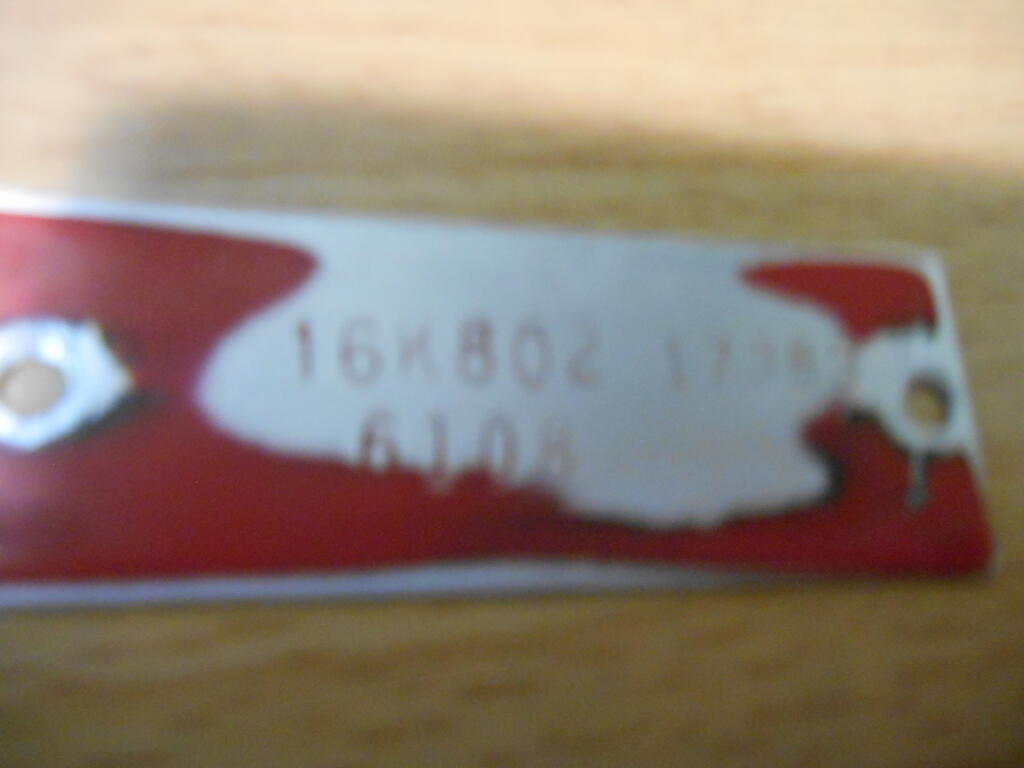

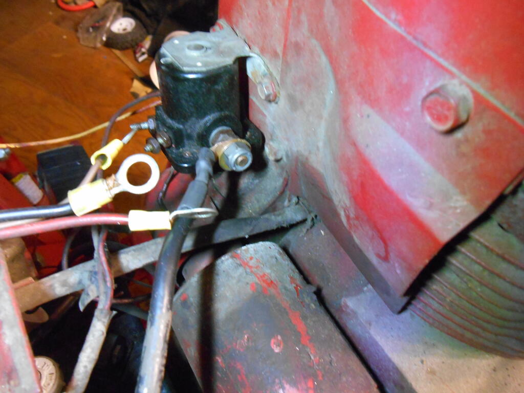

ohiofarmer 3,249 #27 Posted November 13, 2020 (edited) This is what i am up against. The PO had all this stuff tagged to the hot side of the solenoid. Most of the original harness is still there with the plug in to the switch intact, but missing one wire lead with just the remnants of a wire sticking out. The solenoid clicks , but no cigar. i will drill a tiny hole in the cap of the solenoid to inject some Deep Creep. That has worked before . i rescued the tag and carefully wet sanded the paint. 16K802 17383 6108 Edited November 13, 2020 by ohiofarmer 2 Share this post Link to post Share on other sites
gwest_ca-(File Mod) 10,876 #28 Posted November 14, 2020 Full model number would be 61-16K802 with the 61- likely printed rather than stamped. Click on the fuzzy part of the link. Garry 1 1 Share this post Link to post Share on other sites
ohiofarmer 3,249 #29 Posted November 14, 2020 I finally got the solenoid/starter thing fixed. I was back and forth with wondering why there was not enough oomph [ was it solenoid or poor ground to transfer the current to the starter. I had thoroughly cleaned the ring connectors and the copper penny washers. the test light lit on the far side of the solenoid, but the cable to the starter was not carrying current. Finally, the test light needle point got between the crimp and the copper wire and she lit off. So now i will use a bit of toilet bowl cleaner at the cable ends, as it works very well in tight areas to remove tarnish, then silicone grease and tighten the crimp a bit. No way would you ever look at the cable and even consider that this cable would not pass muster.. I just went ahead and removed the voltage regulator and ammeter. Might just as well clean that stuff as well as it looks pretty bad.. I have plenty of fresh wiring in the horde. Washing machines and cook stoves and stuff has excellent tight fittings that plug right into the ignition switch.All i need for now all i need is a jump wire to the coil and a momentary starter switch to see if it will fire. 1 Share this post Link to post Share on other sites
ohiofarmer 3,249 #30 Posted November 19, 2020 SHE'S ALIVE. Put a carb on it and a slave tank and it hit right off. No smoke and runs fine. It does need a new switch and some additional wiring clean up, but it is in the original repaired wiring harness. I save everything and seem to get the most parts from old appliance wiring and the thin but strong angle iron they use in bed frames and furniture.. An old stove or clothes dryer has some heavy duty wiring with suitable end fittings that plug right in to our wire harnesses. So order some parts like switches and carburetor parts, fuel line andgaskets for three or four Horses and the shop will be a happy place. The c-141 can go up on the lift for it's maiden start next., then the c-121 for a head cleaning and valve adjustment. I might tackle a rebore on one of my engines if there is time later. 2 Share this post Link to post Share on other sites

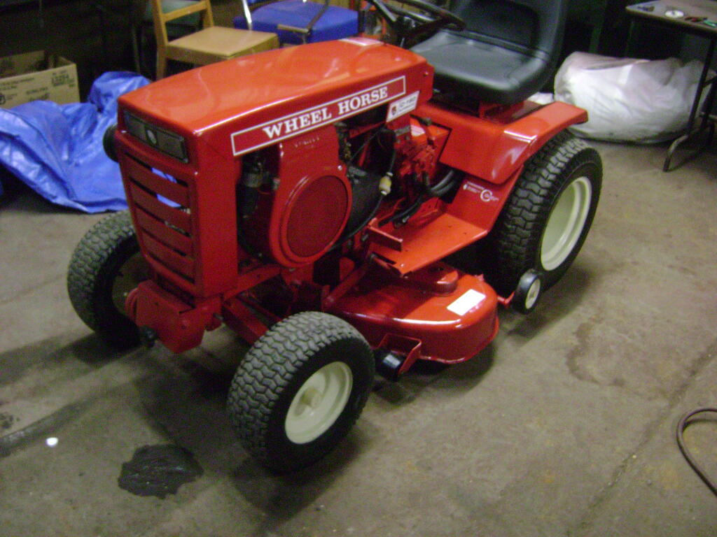

sparkie333 265 #35 Posted December 9, 2020 This picture of my C160 didn't come out very clear If I can find out how I posted it I will try again. 4 2 Share this post Link to post Share on other sites
