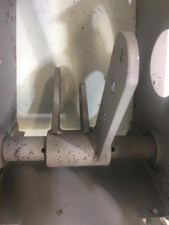

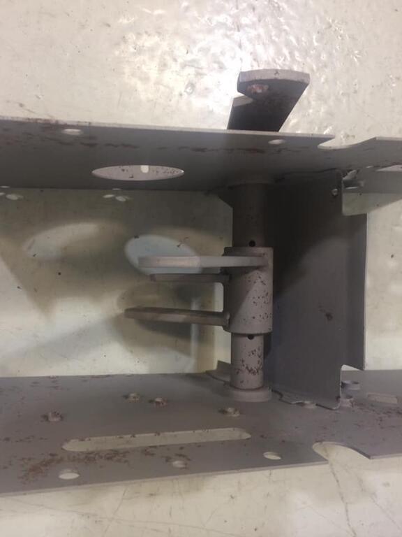

Hello All, I am trying to disassemble a part on my 93 520H. Sorry, I don't know the technical term for the piece but connects to the deck to lift it up or lower it. I have removed the pins and blasted the whole assembly but I find I need to blast it piece by piece separately to get the prep I'm looking for. I see the piece has a keyway in it as well. I've tried moderately heating it but it won't budge. I just want to ask the group if these are notoriously hard to separate and not worth the effort or perhaps I need to heat it more cos it's probably rusted together. Thanks in advance for any advice.

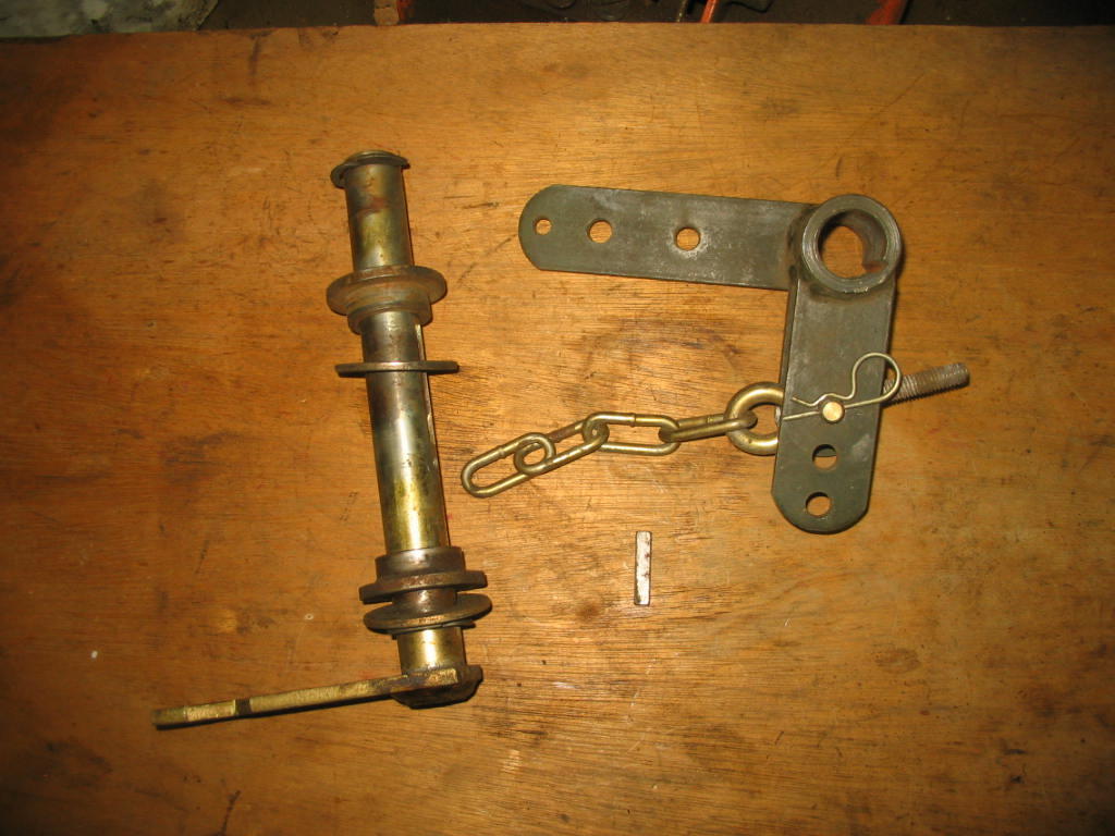

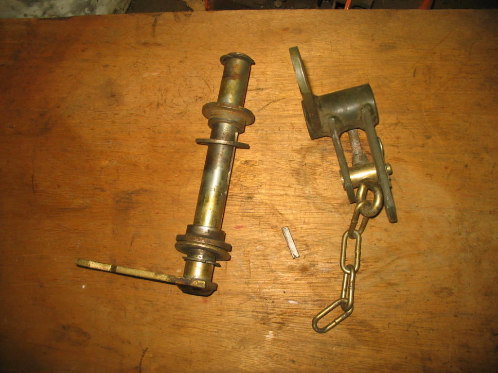

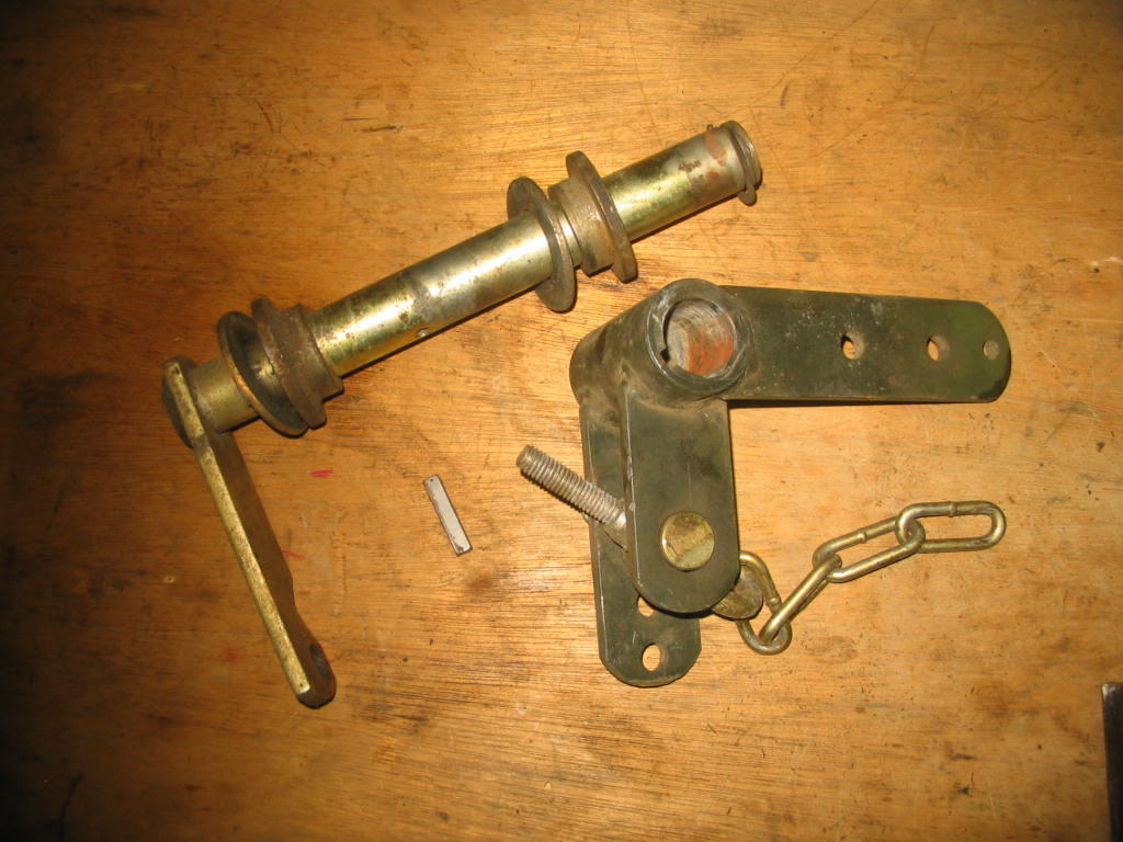

daveoman1966
Inasmuch as you've sandblasted the hoodstand with the bell-crank (rockshaft) in place, I've no doubt that the blasting sand has gotten in to each of the side bushings.  Given that, IMHO, you've no alternative but to get the bell-crank out at all costs.  If not, the sand will grind away at those two bushings leading to premature failure.
ps...  I have that shaft and bell-crank available if you destroy your getting it out.
