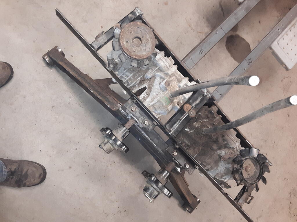

6 hours ago, Handy Don said:
can't get my head around driving something like that
It's a bit odd for sure. I've driven different types of lifts and run cranes that were not controlled the same.
Takes a little getting used to it but you'd be fine.
:handgestures-thumbup:
Oldskool
7 hours ago, Handy Don said:

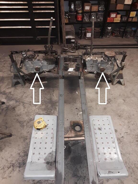

So two completely separate hydro units. Were they driven by a single "serpentine" belt or does one side have a dual pulley with a separate belt to the other hydro similar to a WH mower deck?
The engine has the double pulley. The pulleys on the hydro units are 1 in differant in hieght
Oldskool
Assuming you are thinking of a linkage that reorients the control movements. :D
Thanks for sharing the progress and the pics.
Yes. I will be using a bell crank on each side

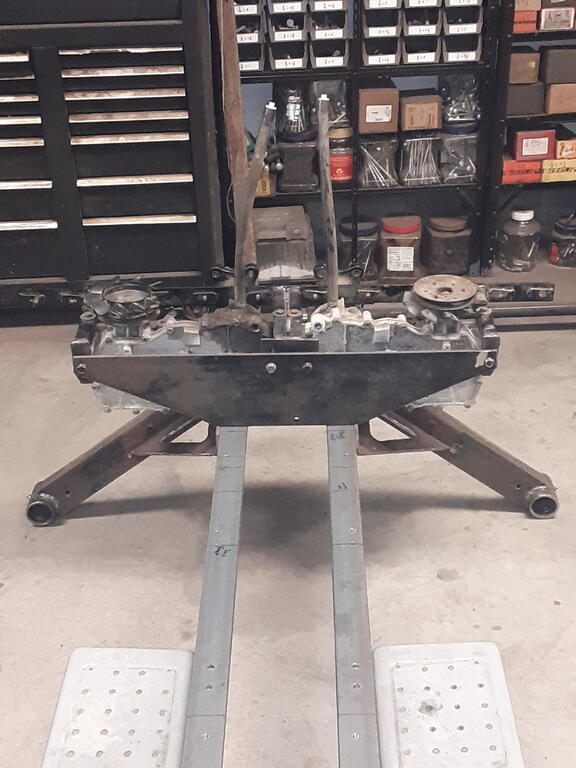

The drive units are in. Now for the engine so I can get the jack shaft built. Next after that will be the linkages.

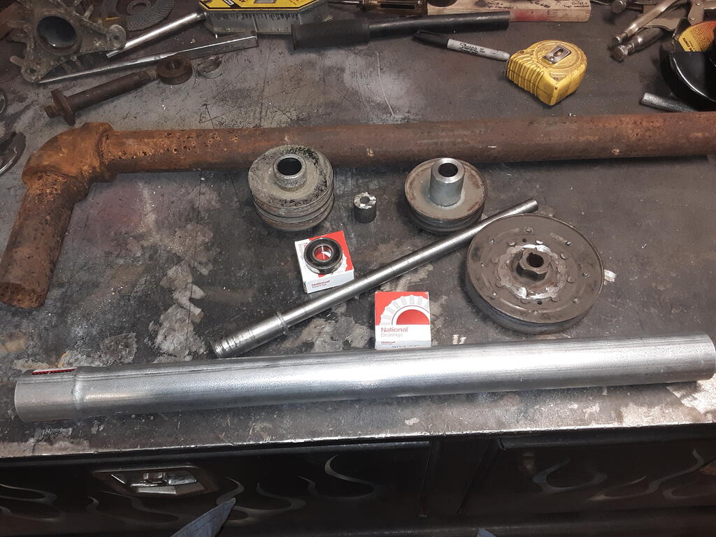

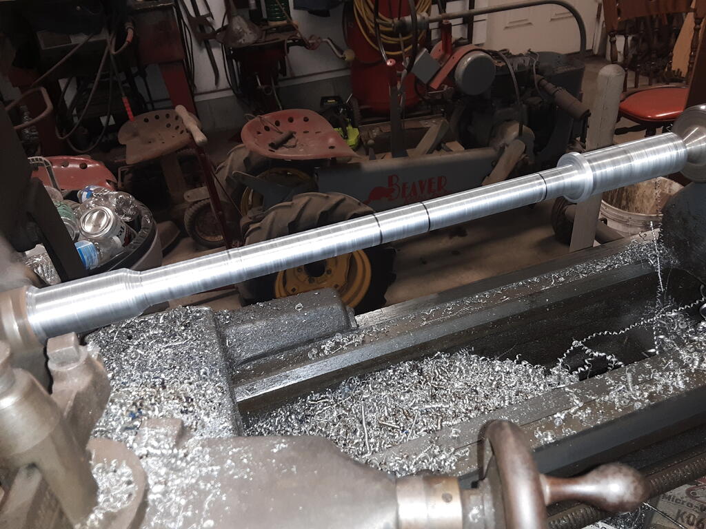

1 jack shaft in the makings
Oldskool
Here is more of my DIY jack shaft kit. Let's see how this turns out
