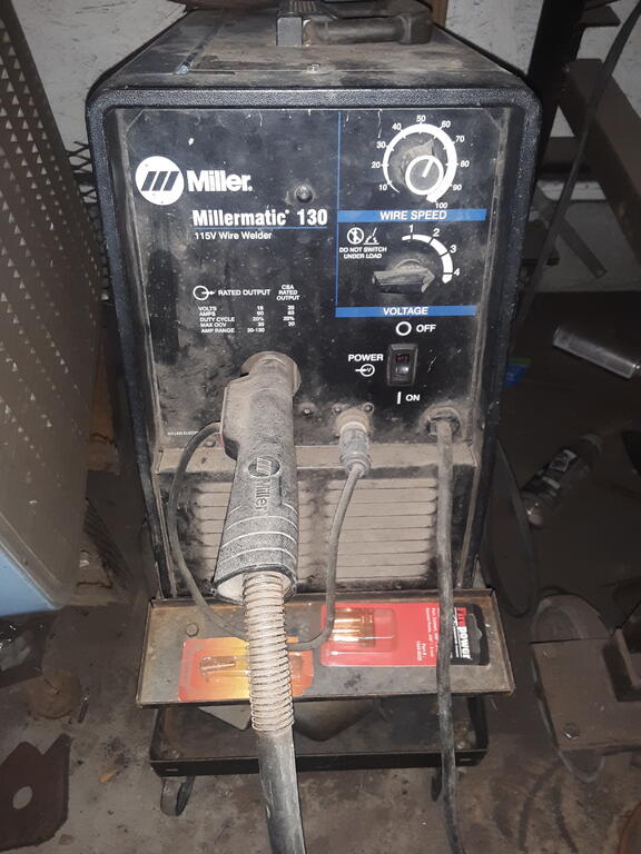

I think I am back in action. I acquired this little gem last night. 110volt so semi portable. Also with it being in the teens this morning I'm getting a late enough start at work to be able to drop some stuff off at the machine shop.
Nice find Sir

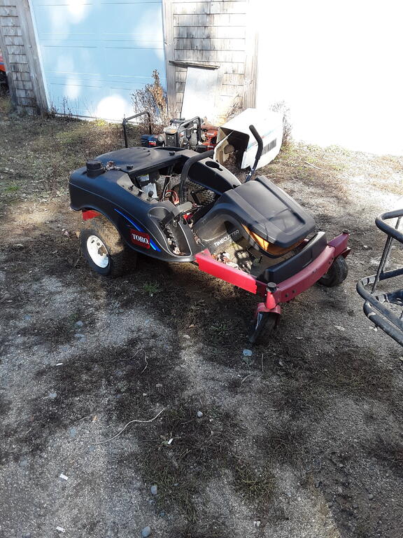

Oldskool
The donor is headed into the butcher shop in anticipation of a rain day off from work. Looks like alot of usable pieces to be had.
31 minutes ago, Oldskool said:
donor
So the lever that has the notches is your speed selector? Then the two hand levers are what? Forward? Reverse? Both?
Handy Don
My guess is notched lever is the cutting height selector and the two arms are motion control for the respective sides.

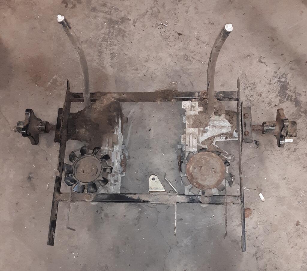

Oldskool
The one with the notches was the deck hieght. Yes the others are forward/reverse
Oldskool
Correct

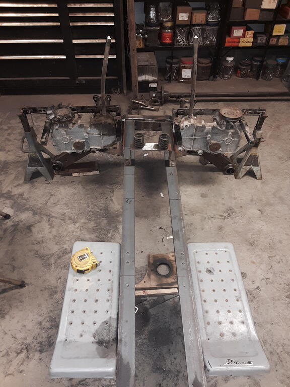

Oldskool
Here they are. Now to get them mounted
Oldskool
Getting a better feel for things
Handy Don
So two completely separate hydro units. Were they driven by a single "serpentine" belt or does one side have a dual pulley with a separate belt to the other hydro similar to a WH mower deck?
Handy Don
Also just realized that on a zero turn, the motion controls move fore and aft in the direction(s) of travel. For your application, the "native" controls will move side to side because the driven "axles" are longitudinal and not transverse. So both outward for one direction and both inward for the other direction--can't get my head around driving something like that. Assuming you are thinking of a linkage that reorients the control movements. :D
Thanks for sharing the progress and the pics.
