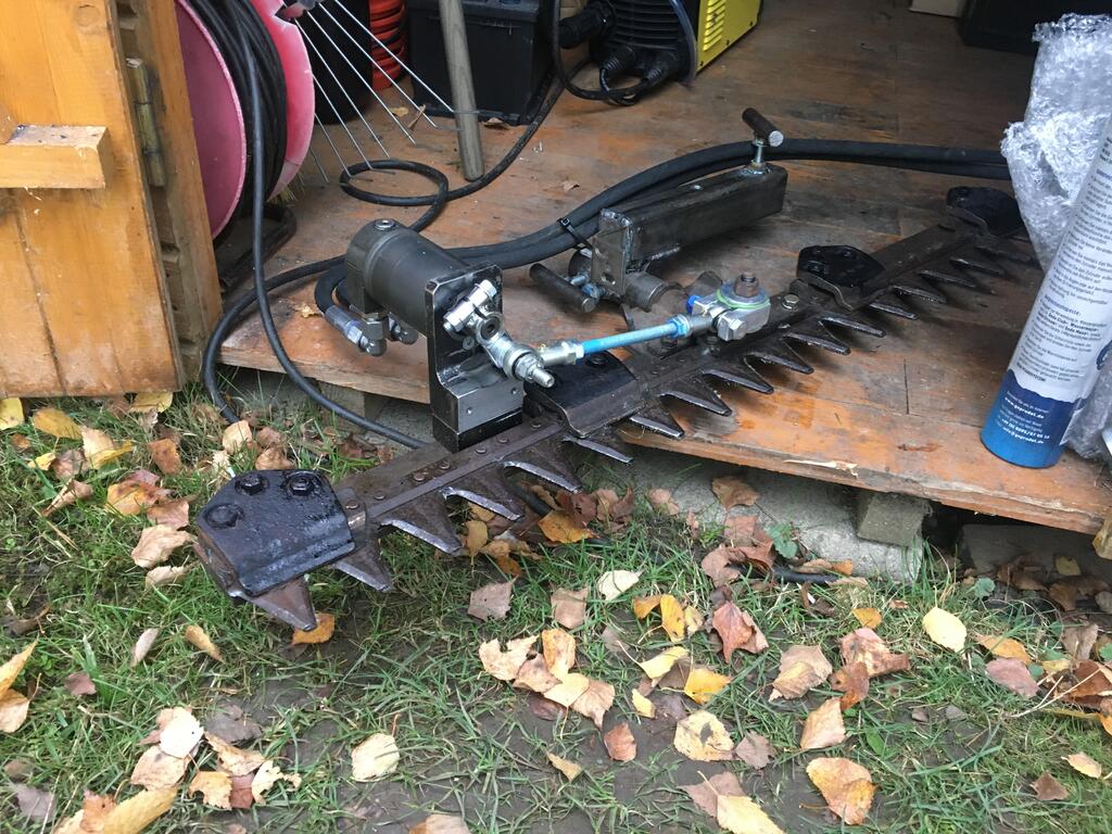

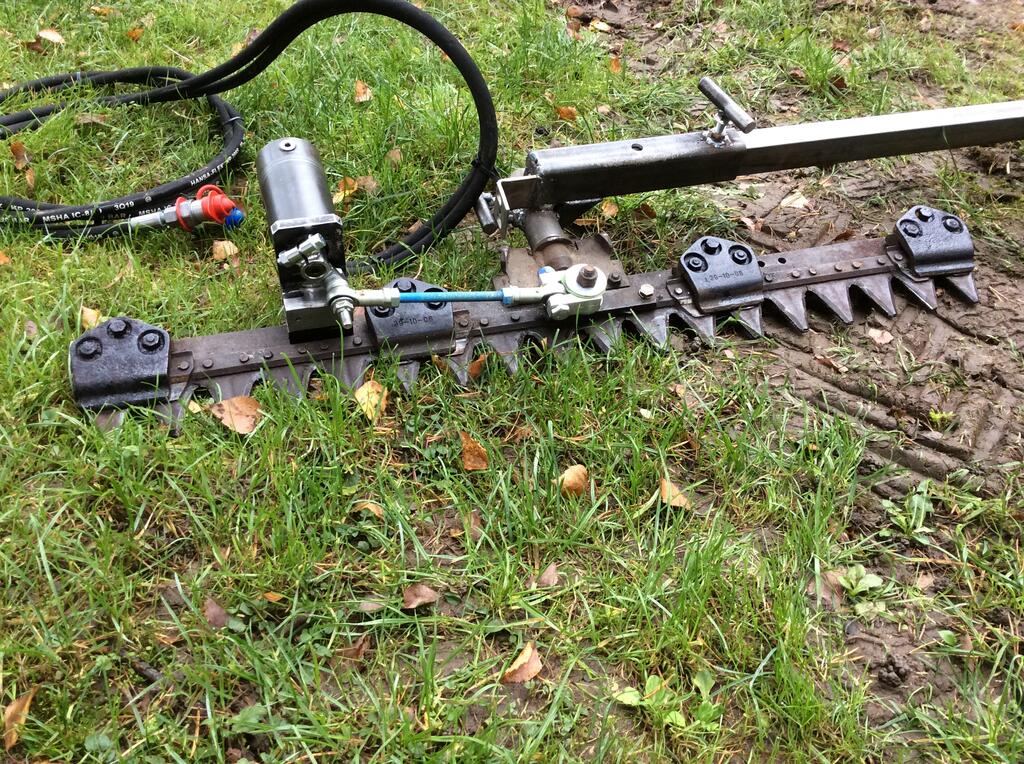

Another thing i found out when i searched a fitting hydraulic motor for my Sicklebar hedgecutter project,
the bigger the motor‘s the slower their output RPM.
when i do my equations, to estimate what i need on torque i use a torquewrend to get a feeling of what
torque i will need estimated to work that thing.
therefore i get a 2 cm thick piece of woof i try to cut.
with the torquewrench on the sicklebar i try to find out, how much torque shall be enough to cut that.
after i got my value i double the result + adding 10%reserve for any unknown i may overseen.
On a sidenote:
That thing works like a charm and Hedgecutting is now a just act of Fun and Seattime instead before.

That's a nice looking hedge trimmer. I could have used something like that last fall.
Tractorhead
Thanks,
that was 25 year old walk behind mower with a blown Briggs Engine i get for free.
because i hate it to trashing things and buy new, i do this rework to make me my life easier.
i had somewhere a Video of it in Action, but i missed the link for the moment.

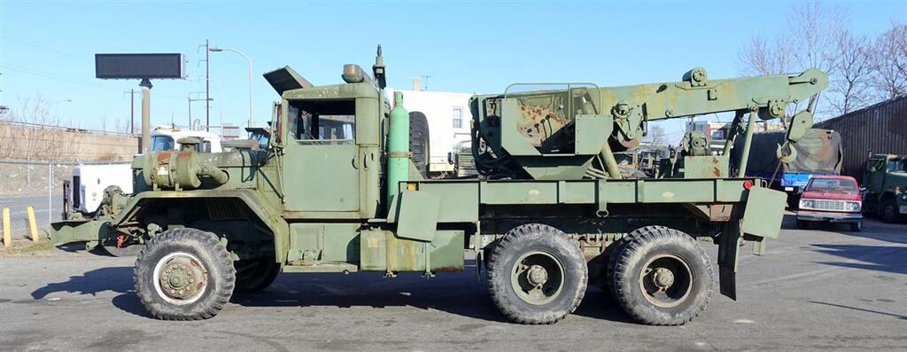

Amazing I like the way it goes sideways.  Hope you don't suffer a break down or get stuck,  towing that home might need a  M 816 5 Ton Wrecker:P

Sideways is the only way I can get it in and out of the garage over the cement. No doubt, I think it would take something like that  for recovery.
