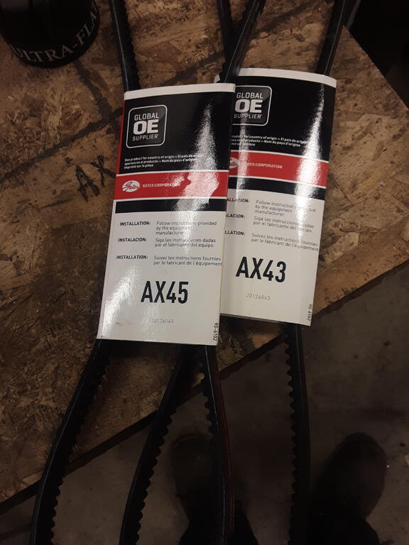

If you look at the pics again you will notice there are proposed tensioners. 1 on each side. Top pic is middle bottom. Bottom pic top right. Both on the slack side. They aren't finished yet.
That's the best you can do, I don't see anything that would be better. All cars use the tension type idlers with the multi groove belts. Had the tensioner fall of a 94 Explorer while setting at the
drive in window at the drug store. One single belt no alternator, water pump or power steering.
Oldskool
Here we go.
