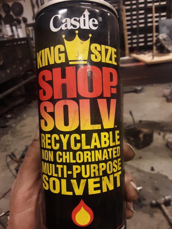

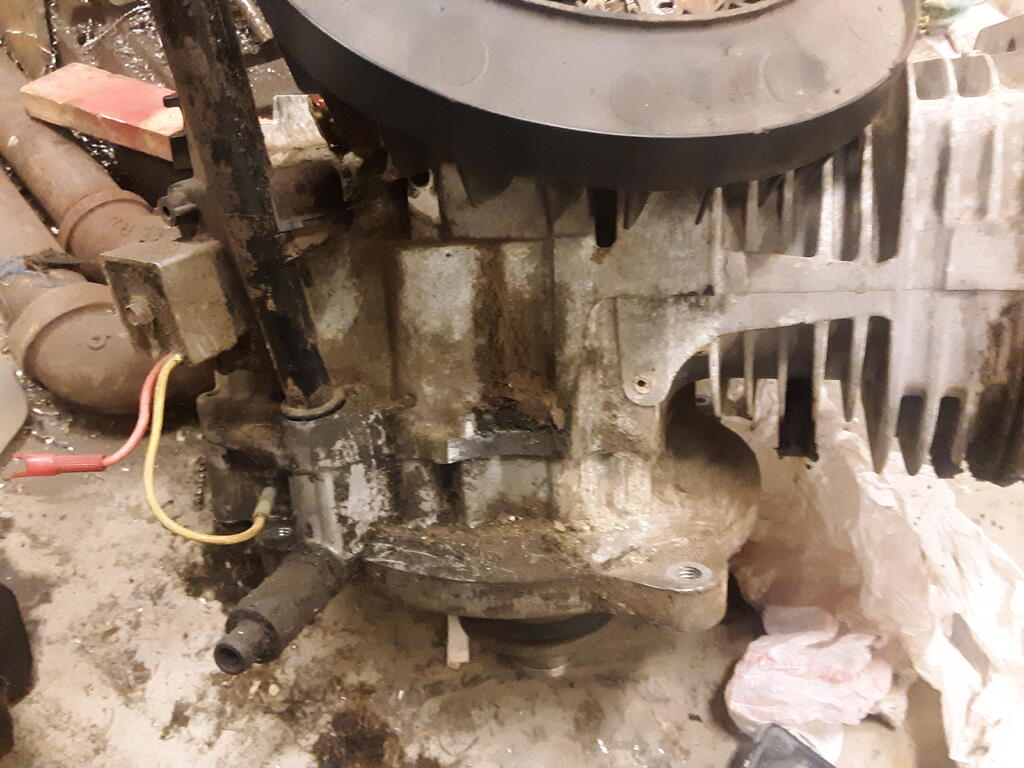

Has anyone ever used this stuff? Holy crap it works good. You can literally just spray the gunk away. Before and after pics. No rubbing or scrubbing.

55 minutes ago, Oldskool said:
this stuff
No sir. That's a new one to me.
Oldskool
Its wicked goot bub🤣🤣

26 minutes ago, Oldskool said:
I didnt even rinse it off. Start at the top and work your way to the bottom. Done.
Like brake clean?
Oldskool
Just now, ebinmaine said:
Like brake clean?
Ya pretty much. I wish I had taken a video. If I had some left I would
Nope!  But 5 folks on Amazon absolutely love it!

DennisThornton
Castle Multi Purpose Solvent | Shop Solv King Size Spray
Mostly Heptane:  Heptane or n-heptane is the straight-chain alkane with the chemical formula H3C(CH2)5CH3 or C7H16, and is one of the main components of gasoline (petrol).
Also in some glue solvents.
Mixtures
Chemical name Common name and synonyms CAS number    %
Heptane, branched, cyclic and 426260-76-6 linear             40 - 60
n-Heptane 142-82-5                                                            20 - 40
Carbon Dioxide 124-38-9                                                   2.5 - 10
Ethyl Alcohol 64-17-5                                                         2.5 - 10
Toluene 108-88-3                                                               2.5 - 10
Methanol 67-56-                                                                    1 - 2.5
Other components below reportable levels 0.01 - 0.1
