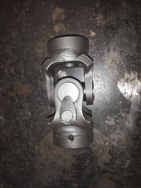

Here is what I came up with to disperse the load on the C-clips. I will be using grade 8 bolts when fully assembled.
Edited by Oldskool
Very clever! I like this a lot. It'll keep the bearing race in in case of failure--maybe even give you a "limp home" capability in the worst case. I doubt it compromises the yoke integrity in any serious way.  Since it'll be essentially permanent, I suggest red loctite on assembly as well.
I took a close look at a U-joint I have on hand and noticed that its "cross" arms butt directly up to its yoke arms. As long as it's "axles" don't fall out any side force is well-handled. I'm not sure how this was assembled since there is no clip! This is from a 3-point hitch drive.
In the "Drift" example, if your tank is to the left and your rear arm to the right, then the force (blue arrow) from the machine's weight is upward via the lower arm of the left yoke and carried by the horizontal axles of the cross to both arms of the right yoke. Your joint looks very similar but the cross isn't quite as "chunky".
This video below of how a u-joint goes together was pretty helpful (could have speeded up parts of it!) I'd have used a vise to squeeze the needle bearing sleeves onto the axles. And you do have to pay attention to the yoke symmetry to accommodate the grease fitting!
It does show how side force would push against the clip--it is the opposite of the assembly force!

Thanks. This will be my last upgrade until I have a failure. Until then all is good. I may have an unexpected failure elsewhere. We all will see soon.

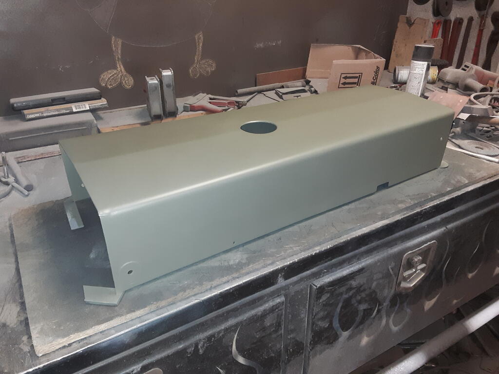

I have to say I'm quite pleased with the hood.
