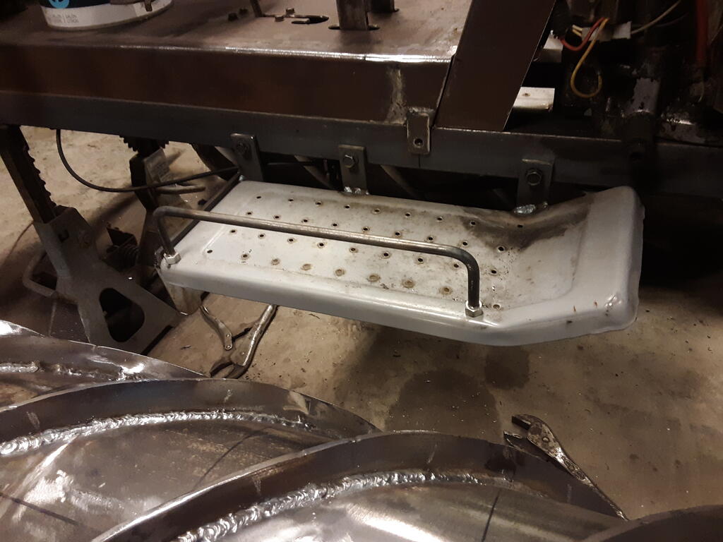

A bit of builders block today so it's slow going. I have managed to get the running boards on. Kinda kept them K.I.S.S.
DennisThornton
Nothing wrong with that!  How did you make them so quickly? (smile)
Hard to know what you will won't until you throw snow.  You can always add a full cab next.
Oldskool
I dont know about a cab. I'm getting burned out.
SylvanLakeWH
Just an observation, do you think they are big enough? Hard to tell from pic but perhaps cover more to the rear and make them wider?
Thats one helluva pinch point...
