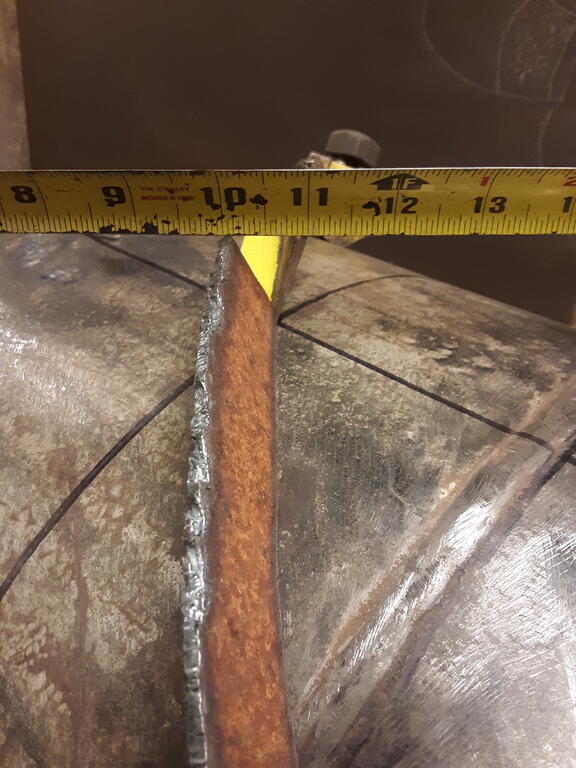

Oldskool

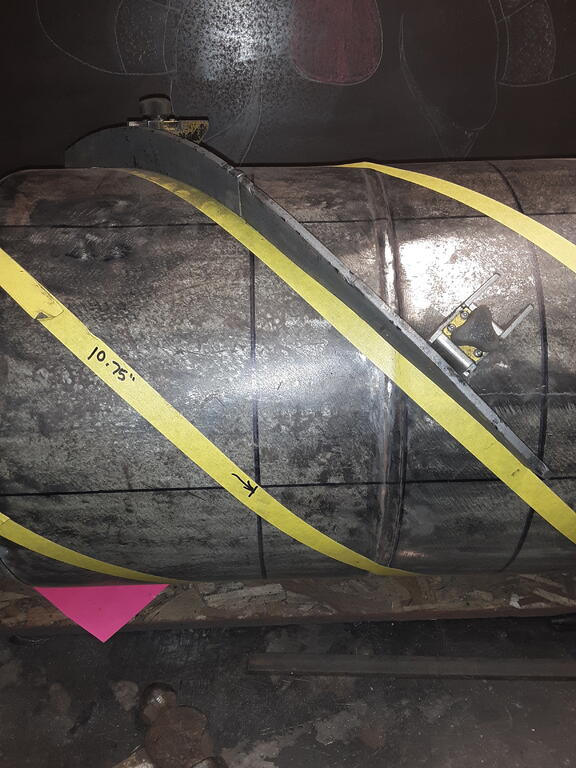

This pic is of the junction of 2 pieces at the 1/6 mark on the tank.  They both are 90 degree from the tank.  So each 1/6 segment has a 1/2" of twist in it
  • Like 3

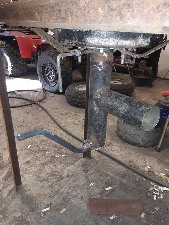

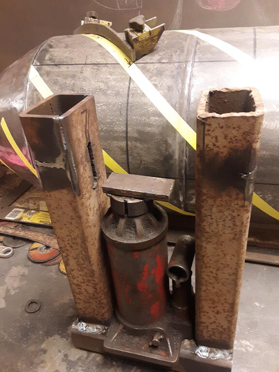

Merry Christmas Eve everyone. Had a chance for a little garage time. It's a crude little bugger but I think it will work. It only has to last for 72 pieces lol.  I also took the opportunity on my cool down time to do a bit of math. Without the blades factored in it's looking like 1.34 pounds per square inch. I dont know if that's more or less then what I was expecting.
  • Like 1
  • Excellent 7

That's the ticket!
Simple, strong, effective.

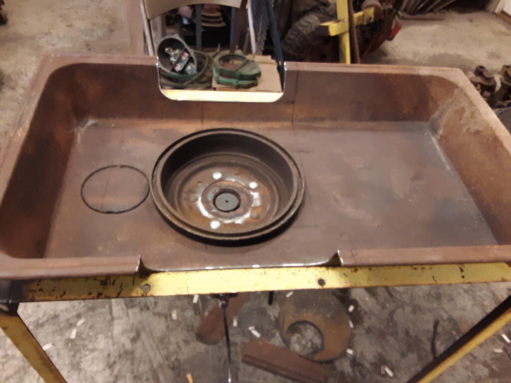

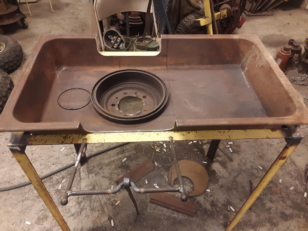

Sidetracked Saturday again. Cause everyone needs a little coal forge to mess with
  • Like 6

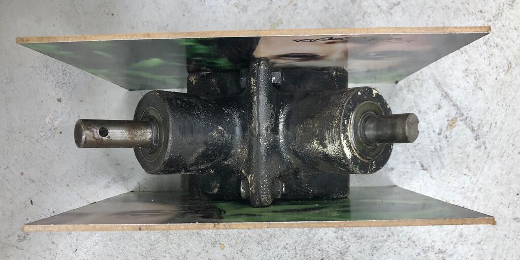

@Oldskool FYI on gearbox
in "original" packaging
Ready for USPS @ 16.5lbs
  • Like 1
  • Excellent 2
Oldskool
Thanks Don
  • Like 1
Oldskool
A bit more on the coal forge. If I have to bend steel for the screw drive this will do it. At least it will save my oxy/acet.
  • Like 2

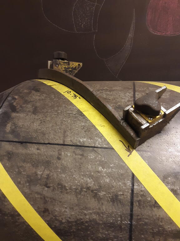

Oldskool
Nothing I cant overcome, but bit more of a challenge then I was thinking.
  • Excellent 3

Oldskool
4 minutes ago, ebinmaine said:
I believe the international laws of fabrication states that you are allowed to use multiple BFH'S in situations of complex curves
Oh I am. Its actually the twist that's getting me. I'm trying to figure out a way to do the twist without putting an unwanted added curve in it.
  • Like 1

One complete twist tacked in place.
  • Like 1
  • Excellent 5
