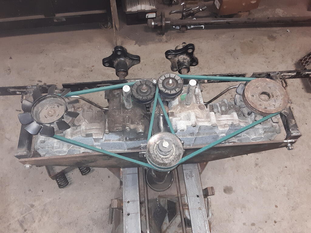

Tension both sides? Maybe 2 idlers on a single piece of steel bar that pivots in the center and you can spring load it :scratchead:
That would take up the slack on both sides of the loop for different directions.
Oldskool
That's not a bad idea, but with a ridged tensioner, would I need 2?

wallfish
Ridgid just one side, the loop can't go anywhere if the chain is tight. Depending on which way they turn for forward, I'd locate it on the opposite side of the drive side. Thinking you would be going forward a lot more than reverse

8ntruck
I'd consider an idler sprocket.  Maybe mounted on a slotted bracket parallel to the run of the chain.  Slide it closer to the drive or driven sprocket to tighten the chain.  Use a hefty shoulder bolt to hold the center race of the idler sprocket bearing.
  • Like 2
Oldskool
I hadn't actually thought of running the idler in that direction. I had thought more of pushing in the 90 degree direction of the chain travel. Interesting. When the parts show up I will have to put that into consideration
8ntruck
I envision the idler sprocket outside of the chain, with its pitch diameter 1/2 to 1/4 inch snide the drive/driven pitch diameters.
  • Excellent 1
Oldskool
That sounds about right. What I'm starting with is just the idler sprocket itself with integral bearing. All the rest will be built.
