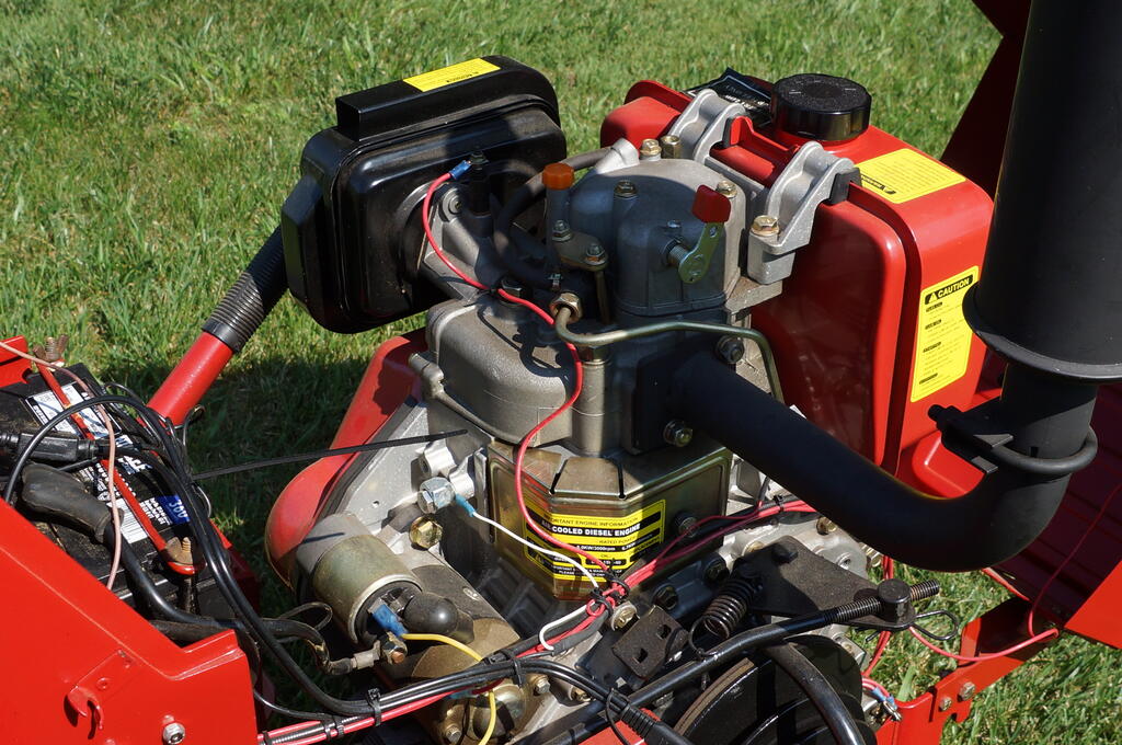

Achto 28,794 #5 Posted October 29, 2020 Because of the lay out of a Wheel Horse, a single cylinder air cooled diesel would be the easiest swap. The power that I have from my 10hp Hatz diesel is kind of unbelievable. I have yet to find enough work to make it pull on the governor. Pulling a 10" Brinly plow from lighter to heavier soil you will hear the tranny start working harder as you enter the heavy soil, but the engine never changes tone. If you find a 2 cylinder that you can mount side ways that may work out as well. Fitting a 3cyl Kubota would be a bit of a challenge You would most likely have to lengthen the frame to make room for the engine & radiator to mount inline with the tractor. Then there would be the challenge of turning the rotating power 90 degrees so that you could run a belt to the transmission. This could be done with a right angle gear box which would again lengthen your power unit. Not saying that it can't be done but it would be a challenge, One other thing to keep in mind is that a 60" can be hard on the frame of your tractor. I have seen some 520 frames crack where the foot bar passes through the frame on tractors running a 60" deck. 3 Share this post Link to post Share on other sites

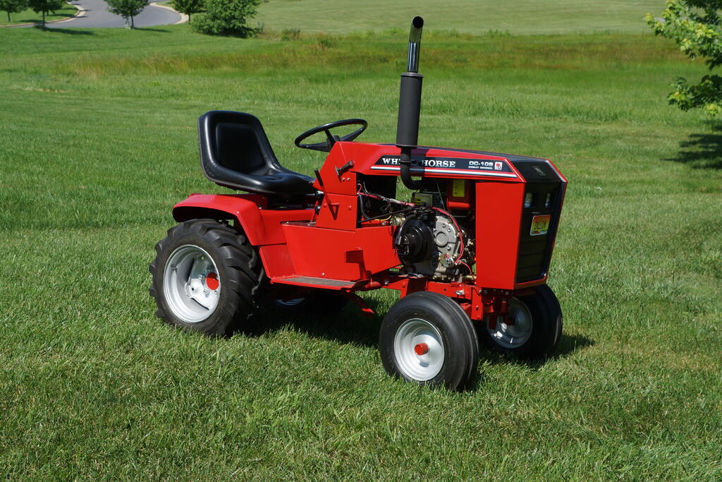

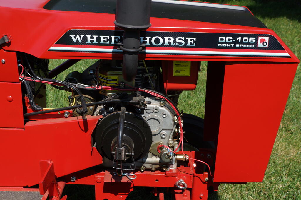

shallowwatersailor 3,214 #10 Posted October 29, 2020 I owned a C-105 that was converted by another member. It has moved on to a different member! The Carroll Stream 10hp was a perfect fit on a Black Hood only needing to be raised about 1/2" at the hinge.. 1 4 3 Share this post Link to post Share on other sites
