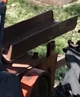

Is that thin metal bar all it has as a hitch
Pullstart
it’s angle iron.  I’m planning to extend it back about 6-8” for better turn radius and give it some kicker supports.

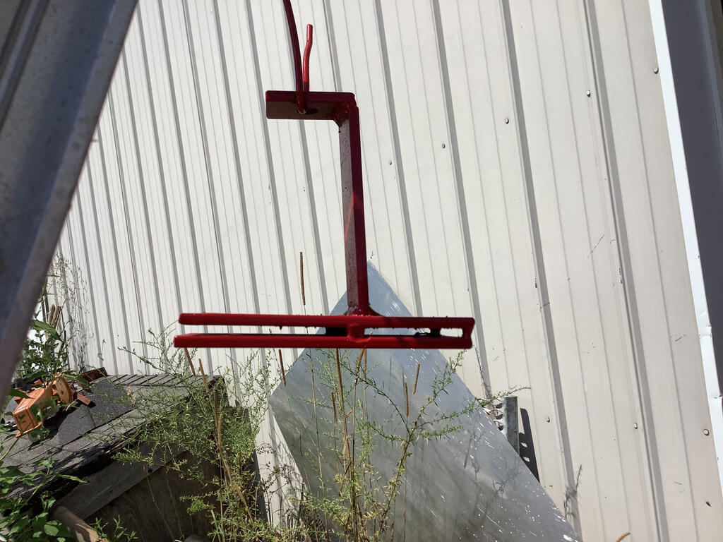

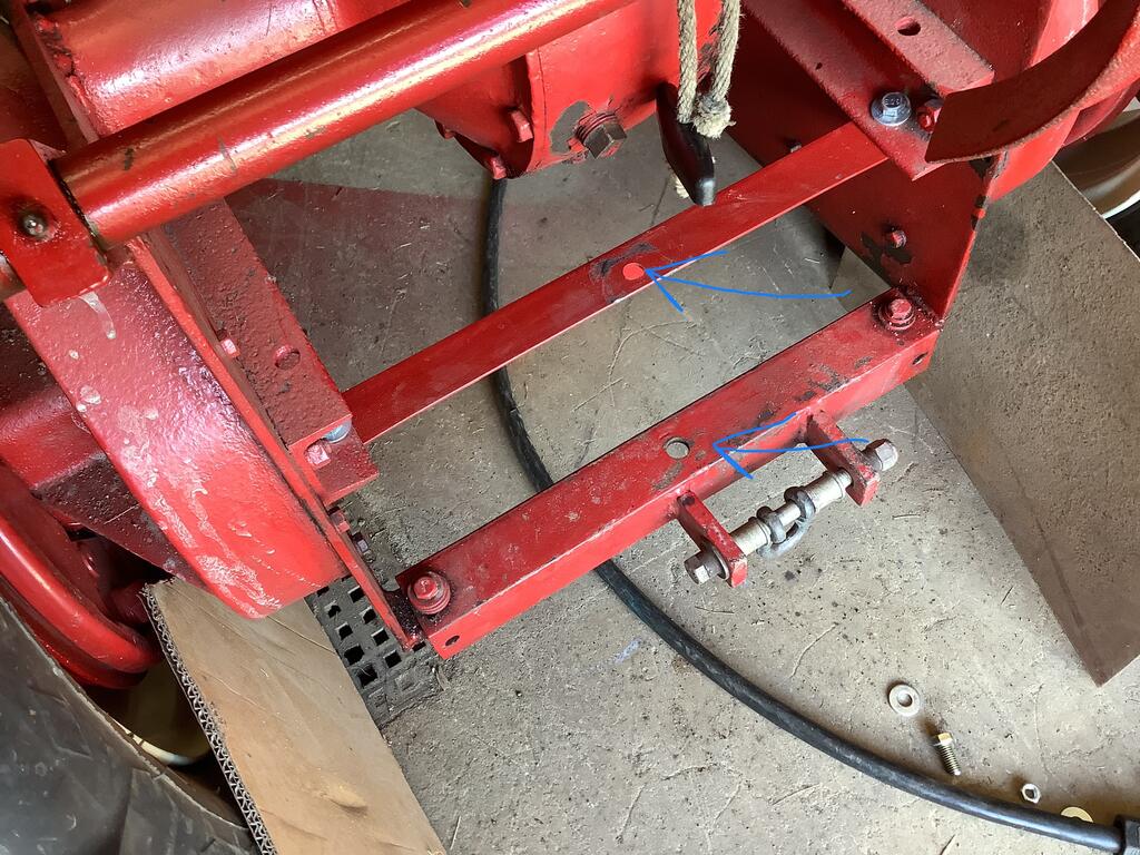

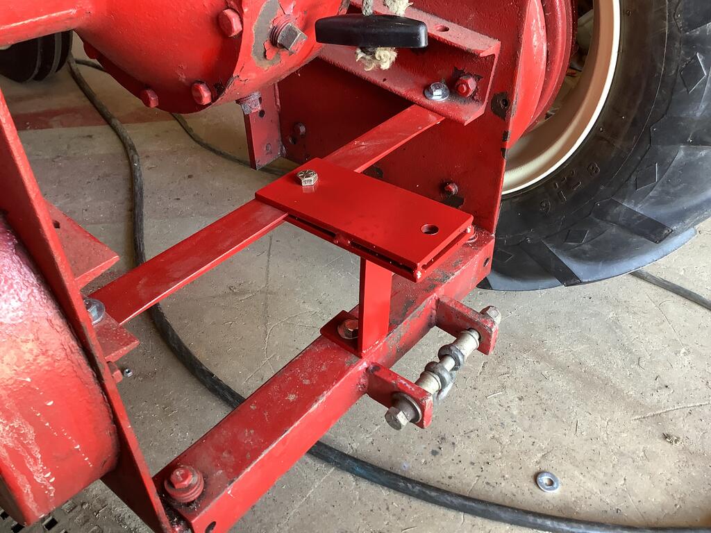

I built an attachment draw bar.  It attaches to the two holes marked in blue and backs up into the angle iron, so no side to side movement.
It’s hanging upside down but also double shears the top angle and gives the hitch pin a little more vertical rigidity.

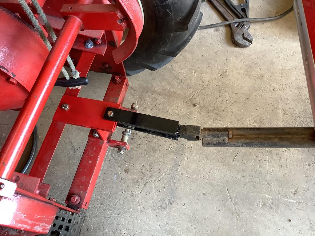

Pullstart
Ready for parade laps!
