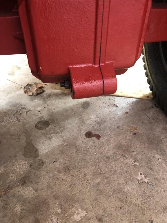

Since I filled up the transmission on this charger, I noticed there was a small spot on the floor underneath. I had put nearly 5 quarts in it and it wasn't moving yet because the motor was not running. So this would lead me to believe that possibly
something to do with the gear case
seal? Any ideas?

Re torque all the case and hydro motor bolts...  Did you make or buy your gasket???

Any torque specs on these bolts?
pfrederi
35 if you used GR5 50 if you used GR8

Haven't got back to it yet. Trying to get my 414 moving so I can do some yardwork. I am going to try and re-torque the bolts and see if that doesn't help. Otherwise I will have to pull off the side of the case to replace the seal.

What did you use for a seal?
May want to put some time into figuring out the exact location of the leak.
White rags or paper towels. Clean it off well then check after (15?) Minutes?
