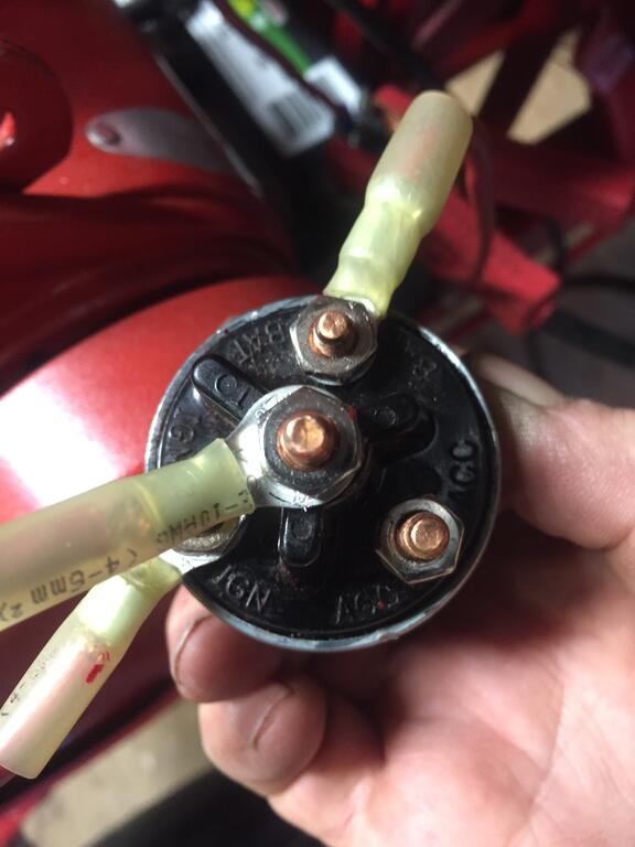

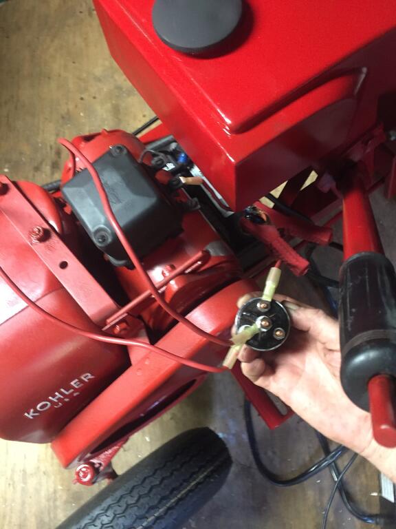

After s year I have restored my 854 wheel horse, wired it back in and get nothing. It ran when I took it apart.  Does the IGN on key switch go to coil. Have included picks close up and hopefully you can see where the lead to.  I have ign to coil, Bat to battery and last one to generator A    Thank you for any help.

I have restored my 854 , it started fine when I took it down to frame. It will not turn over, no sound , no crank. Does IGN go to coil?  I have to pics here hoping you can see how I have it wired. Have IGN to coil, Batt to battery S to generator A.   Thank you appreciate any help
Some times a freshly painted tractor and engine will need to be roughed up a bit to work. Some star washers on the ground wire and on the S/G bolts will help complete the electrical circuit.

Is the ignition switch rated for 70 amps? If not the S/G will cause the switch to fail unless a solenoid is added. A 103-990 switch is used in this drawing.
5b202ef98cc34_wiring-starter-generatorwithbatteryignition.jpg.24ab0ca0cab6d9b8f7d7ffb2a7a42fbc.jpg
Looks like a Blue Streak US-126KA switch.

You may have a stuck brush or dirty spot on the commutator in the genny. Try spinning the motor by hand a little then try the key again. My 953 will do that once in a while. I give the motor a half turn by hand then it fires right up.

The wires you have running from battery to ignition switch and Center post of ignition switch to A on the genny appear to be way under sized.  They have to carry full starting amperage.  Should be 6 ga wire.

I changed the wires. Have IGN hooked from key switch to coil, batt on switch to battery a cable from battery to middle post on voltage reg , other cable from switch to Gen.  still nothing.  Hand turned motor , nothing. Give me all seneareos it can be and will check them one at at time. Thanks , Lonnie.  It ran when I took it down to restore

There are two wires on the A terminal of the generator.  Take the small one (from the regulator off) Hook up you multimeter to the terminal and turn the ignition switch to start. do you read 12 volts.  If not you have a bad switch (or bad wire from battery to switch...)
