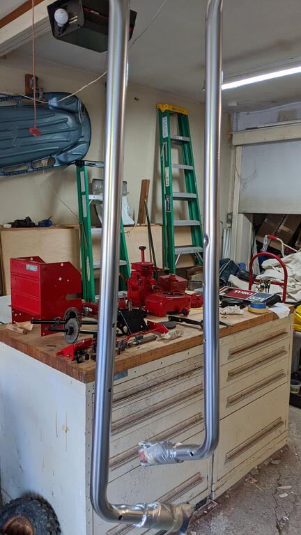

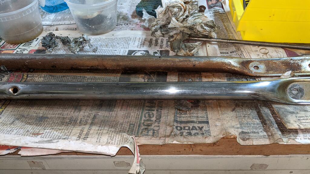

echris 1,425 #14 Posted October 22, 2020 I just used the regular Rust-Oleum chrome paint on the handlebars for a snow blower restore that were too far rusted to save. It's better than it used by, by a long shot but, there's good and bad. The bars looked like hell. Since I spent several hours trying to polish the chrome, the paint finish was much nicer than I expected. Which means if you want a decent finish, you'd better spend way longer than you'd like doing the prep work. They look like a slightly satin chrome. not bad overall appearance. Here's the bad, every time you touch them you get silver hands. Is that going to eventually go away? No idea. I've read about Rust-Oleums automotive chrome paint which is totally different and requires a special gloss primer. No idea if that's any better. https://www.rustoleum.com/product-catalog/consumer-brands/auto/general-purpose-paints/premium-custom-chrome Here's a shot of the bars before and after: 4 Share this post Link to post Share on other sites
Elliot Garfinkel 166 #15 Posted October 22, 2020 That actually doesn't look to bad the rims have lots of nooks and crannys lm not sure if I can dedicate that much prep time on a some what worker. But from your pics they look pretty good I believe the rustoleum was rated in the top ten if that means anything,not sure why color comes off wondering if a clear coat would help but the rustoleum stuff is pretty scetchy as far as clear coat and recoating in general Share this post Link to post Share on other sites

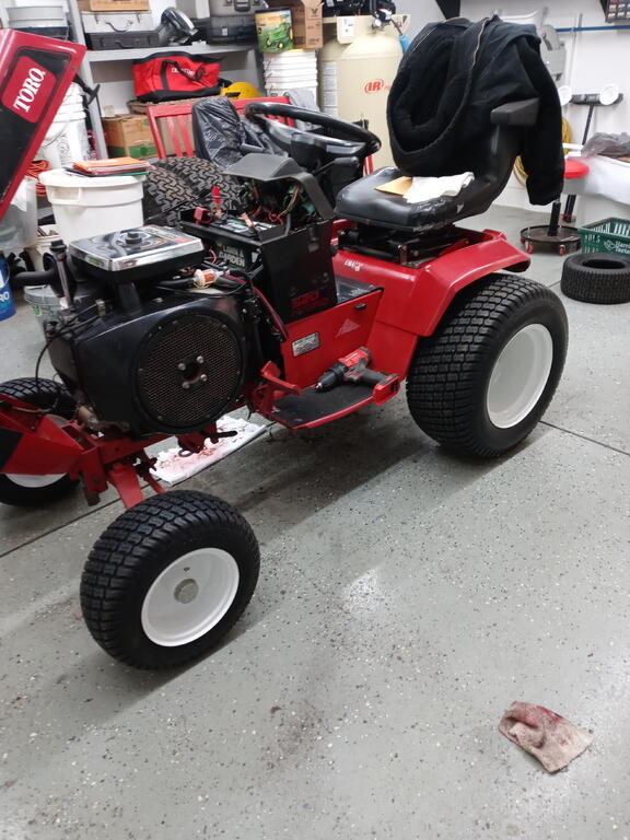

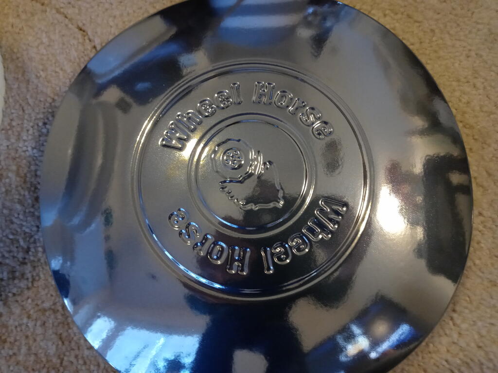

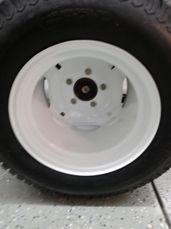

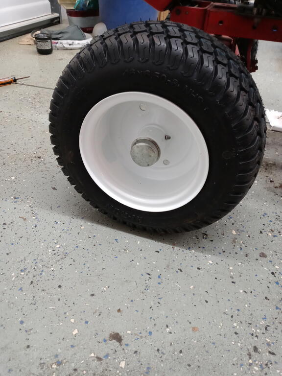

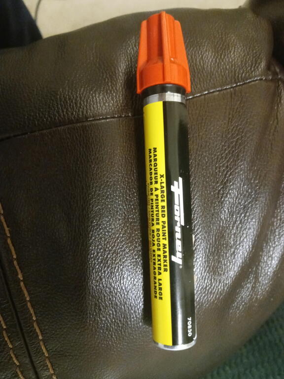

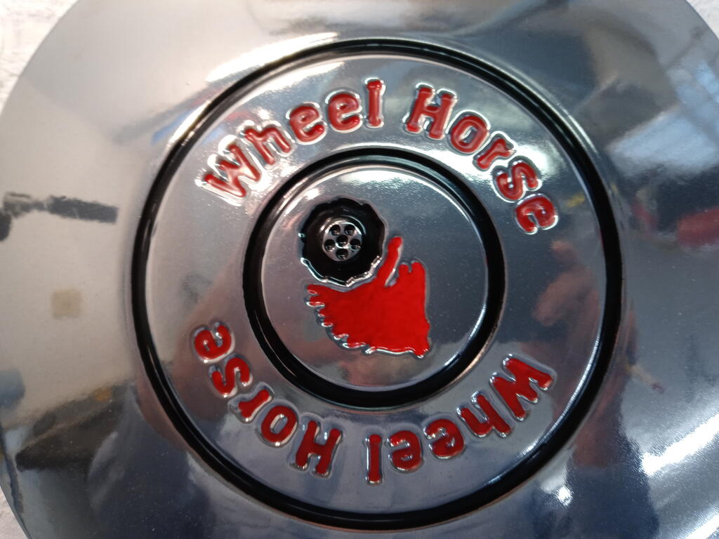

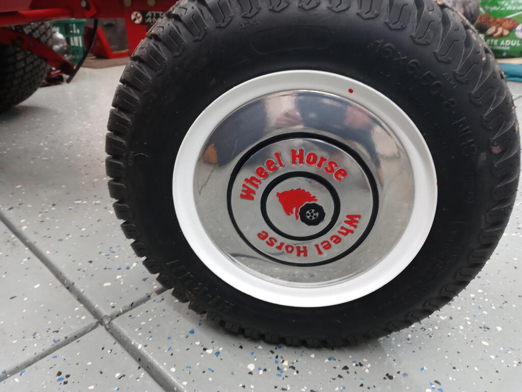

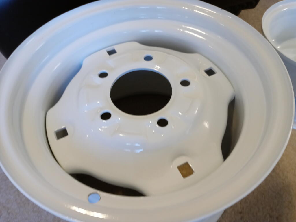

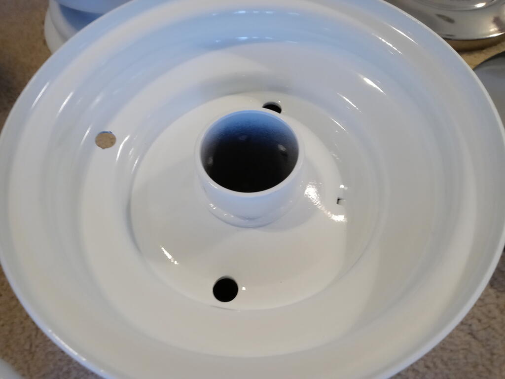

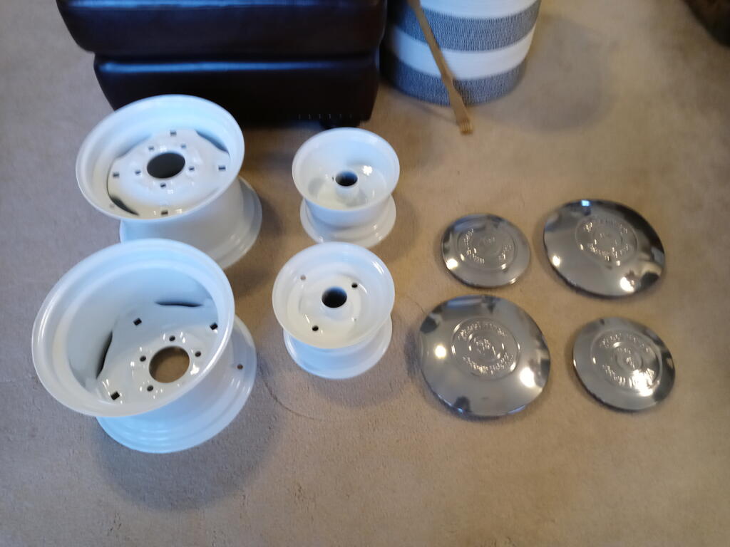

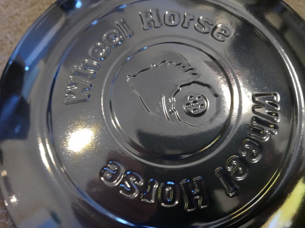

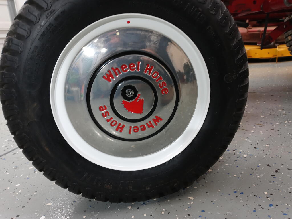

Horse Newbie 7,195 #19 Posted March 2, 2021 (edited) Thanks @WVHillbilly520H... @Elliot Garfinkel... Here's what I done with my 1994 520H wheels and hub caps... My tractor wont be a trailer queen but it will be well taken care of... Wheels: Sandblasted and powder coat Powder coat- Hi Gloss White Polyester Manufacturer- PPG Hub Caps: Sandblasted and powder coat Powder coat- Super Chrome Manufacturer- Tiger Drylac Then I bought some red and black paint markers (Forney brand/ regular and wide tip) and trimmed the hub caps. (Stole this idea from @WVHillbilly520H) These can be bought online and some hardware stores like Ace. Here are some pics... I don't think I have any before pics of the hub caps , but they had pretty bad surface rust... I think all and all the wheels and hub caps came out nice. The pics of the hub caps on the rims don't seem to be as shiny as they were when I first brought them home...I believe I need to polish them to get my fingerprints off. Edited March 2, 2021 by Horse Newbie 1 3 1 Share this post Link to post Share on other sites
