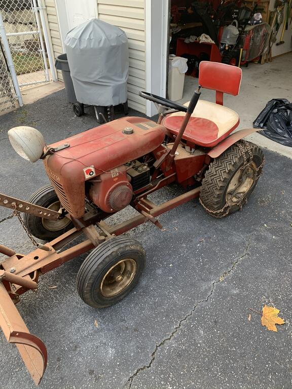

ebinmaine 75,747 #3 Posted October 14, 2020 A short frame plow has a true triangle shaped frame. Both beams are straight. A long frame plow has a section of the frame that's parallel, then it turns in toward the pivot. It appears yours is a short frame plow so it won't fit the Raider. Share this post Link to post Share on other sites
Ed Kennell 43,783 #4 Posted October 14, 2020 A short (A shaped plow frame on your 654) will not fit a long frame tractor like your Raider. Some long frame plow frames will fit long or short frame tractors if they have the bottom mounted axle bracket. The older short frame tractors had a front mounted axle bracket. Share this post Link to post Share on other sites

Jimmy0331 27 #6 Posted October 14, 2020 Here’s better pics 1 Share this post Link to post Share on other sites
ebinmaine 75,747 #7 Posted October 14, 2020 You should be able to pick up a plow frame with plow either 42 or 48 wide for somewhere in the neighborhood of $125 to $200 depending on condition and location. Most important thing with plowing is going to be traction. Chains with lots of weights and that Raider would be a monster machine in the snow. Share this post Link to post Share on other sites
