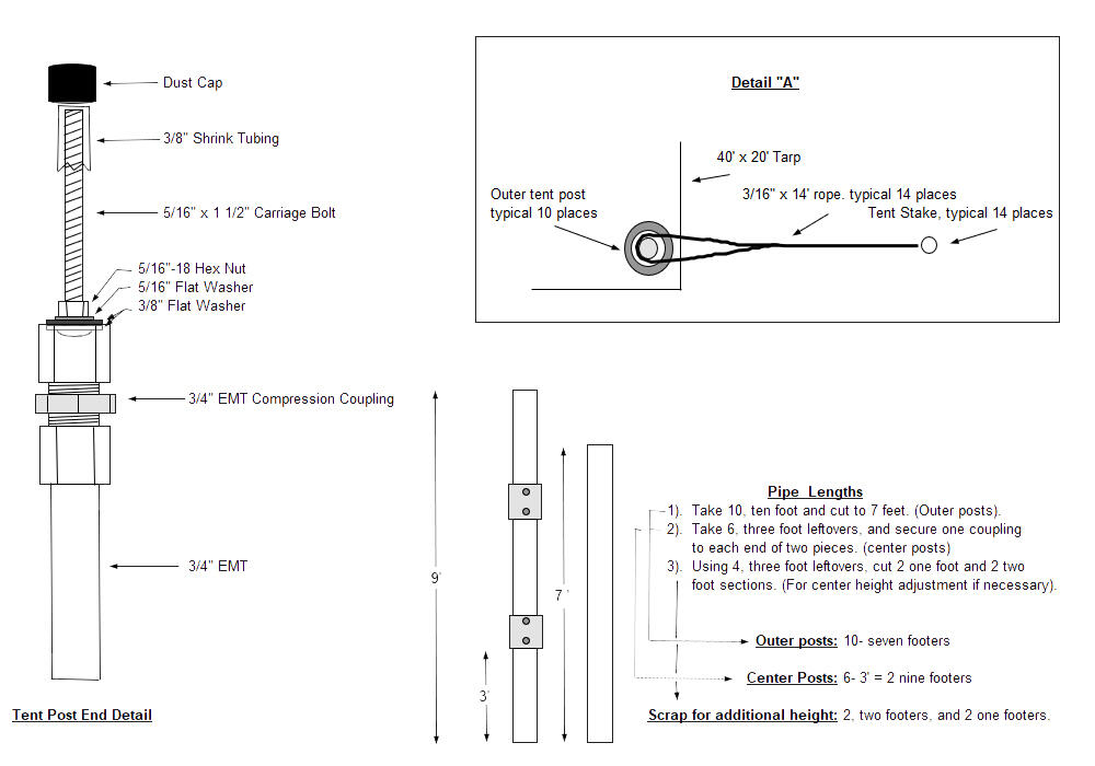

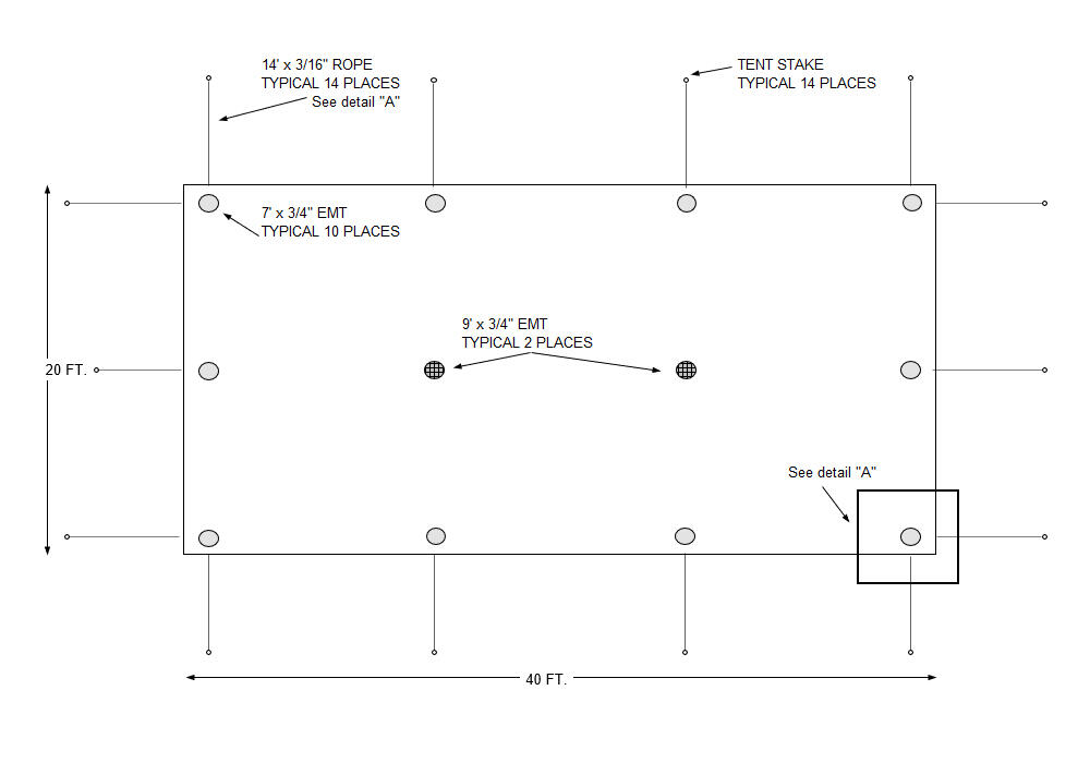

These are the original plans, I've made a few mods over the years, but in about 1995, it cost around $100.
Very simple, sturdy, cheap design using off the shelf parts.
If you have a pass-through trunk the 7' poles should easily fit in most cars, trunk closed.
I originally used a cheap blue tarp, but they didn't last long, maybe 2-3 seasons.
About 15 years ago I bought a much heavier silver tarp, removed the grommets, sewed Kevlar patches into each grommet point and re-grommeted.
That tarp lasted until this past year when a factory seam tore open. (Gorilla tape just might fix that. ;) )
For the stakes, I originally used plastic tents stakes. Ha, no. Between hard as stone campgrounds dirt, and rainy muddy soil, the final solution was re-bar, cut into 2' lengths with a flat washer welded at the top.
The craziest thing about this design is that I did about 90% of it in paper. Put it together in the real world, and aside from a few issues (The stakes mainly ) it worked like a champ, for decades.
She even hosted my best buds wedding back in 1997. B)
So now ladies and gentlemen, I present to you, the "Cheap Mans Big Ass Party Tent ™".

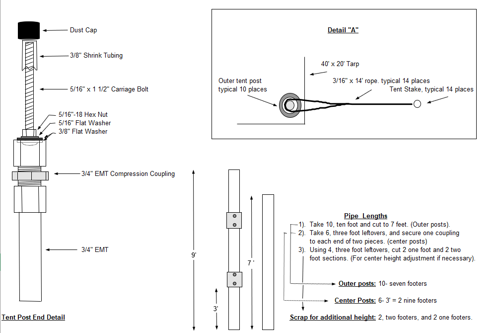

OK, so the forum is freaking out tonight, I can't remove the duplicate image. :roll:

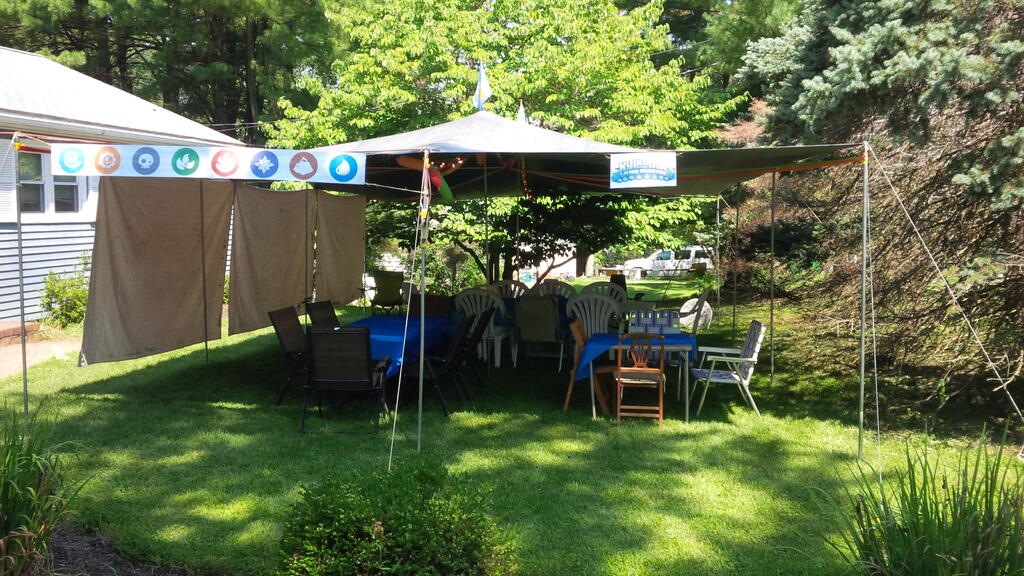

10's of thousands of digital pics and this is the only one I could find. :roll:
This is from 2015 when I did a Skylanders themed birthday party for my son. The drop cloths on the left are a sun shield.
Note the two flags on top. The tarp is held to the outer poles by the ropes. I wanted to hold the tarp down on the center poles as well so I bought two flags from a marine supply, one a beer mug, the other a martini glass, made two flag poles out of wood and thread them onto the top of the tent center poles before raising it up.
I can set the entire tent up myself. It's easier with 3 people, but I figured out how to do it on my own if necessary.
