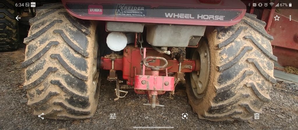

WVHillbilly520H 10,376 #11 Posted October 4, 2020 (edited) 7 hours ago, ebinmaine said: Ag tires won't be satisfactory to you especially in a hill. What you need are RUBBER CHAINS. And tons of weight. Enough weight? Add more. @Ed KennellKennell is it you that runs rubber chains? Eric, I'm gonna have to disagree with you here , I have AG tires on my 520s fluid filled and iron weights plus a little more hanging out back of the snow chucker rig and DON'T use chains on our paved driveway without issues (of course your milage may vary)... my OTR Lawn Trac R1 has been an excellent traction tire on my 2 520s whether the blower or pushing a 56" snow plow or pulling a 10" Brinly or mowing my steep hills. Just my experiences here. VIDEO0124.mp4 VIDEO0125.mp4 Edited October 4, 2020 by WVHillbilly520H 3 Share this post Link to post Share on other sites

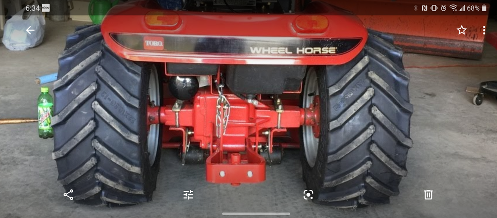

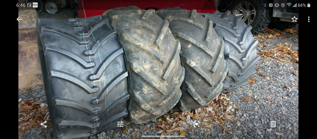

WVHillbilly520H 10,376 #14 Posted October 4, 2020 4 minutes ago, ebinmaine said: Mine were pretty slippery without chains. But maybe if I added more weight....? IDK, I only have 5 gallons methanol in each tire maybe 75# iron each wheel. Then add the cab and another 120# on the blower tractor plus my 200... But the OTR (#2) have a different pattern than the Carlisle TruPower(#1) or Deestone equivalent(#3) that I had to run chains with, again just my experiences. 1 1 Share this post Link to post Share on other sites
ebinmaine 69,852 #15 Posted October 4, 2020 Maybe those OTR are the difference? Interesting straight spot in the center. Share this post Link to post Share on other sites
WVHillbilly520H 10,376 #16 Posted October 4, 2020 16 minutes ago, ebinmaine said: Maybe those OTR are the difference? Interesting straight spot in the center. That center could be the tractive difference IDK... but no chains for 3 years they are definitely better than the Carlisle Trac Chief R4s on my Mahindra and even with fluid fill the sidewalls have plenty of flex. Share this post Link to post Share on other sites
ebinmaine 69,852 #17 Posted October 4, 2020 17 minutes ago, WVHillbilly520H said: That center could be the tractive difference IDK... but no chains for 3 years they are definitely better than the Carlisle Trac Chief R4s on my Mahindra and even with fluid fill the sidewalls have plenty of flex. Forgive the slight side track of the thread here.... How's the mud traction? Share this post Link to post Share on other sites
WVHillbilly520H 10,376 #18 Posted October 4, 2020 Just now, ebinmaine said: Forgive the slight side track of the thread here.... How's the mud traction? So far here in my wet red clay soil gardening this summer no issues a few times I wondered if I was going to have to get a tow but they pulled on through or backed out and over I am truly impressed by this brand tire they can be had in 26x12-12 as well. 1 Share this post Link to post Share on other sites
