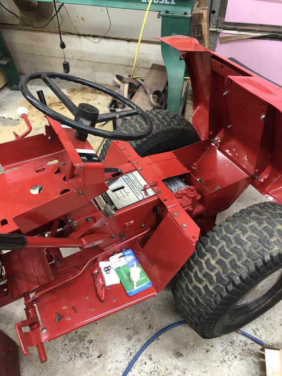

The Tuul Crib 7,338 #1 Posted October 2, 2020 About to head down to the auto parts store to pick up some transmission fluid for the Sunstrand. Kinda confusing! And probably will have to pick up a filter as well Share this post Link to post Share on other sites

The Tuul Crib 7,338 #3 Posted October 2, 2020 Seems to me that there has to be a certain amount of friction needed on these little tractors. And I know there's somewhere that there is a certain blend of the ATF products. I only want to do this once a year! Change the fluid that is! Share this post Link to post Share on other sites
