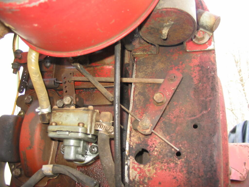

The Tuul Crib 7,338 #1 Posted September 25, 2020 Start to put my 16 horse back together. Trying to remember which holes the spring goes in for the governor and throttle. 3 Share this post Link to post Share on other sites
oliver2-44 9,999 #2 Posted September 25, 2020 MIne is 2nd from the top. Share this post Link to post Share on other sites

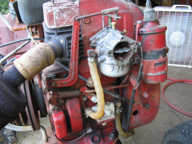

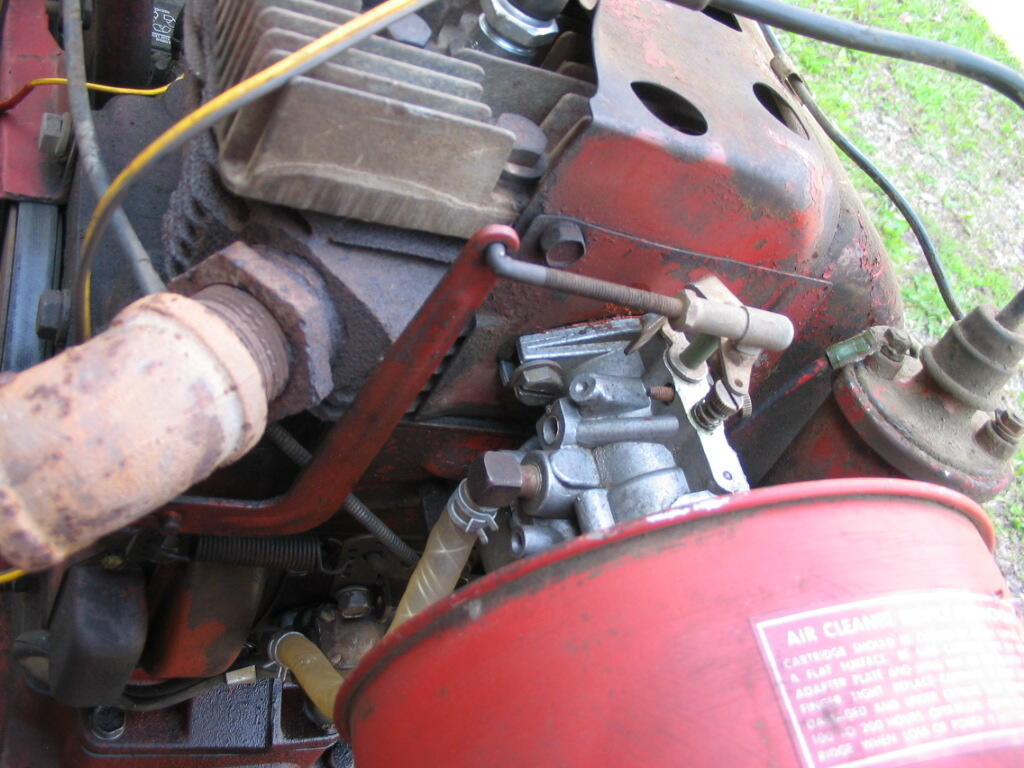

daveoman1966 3,765 #3 Posted September 25, 2020 These pics help...Its a 10hp but linkages are the same for a 16hp. 1 Share this post Link to post Share on other sites

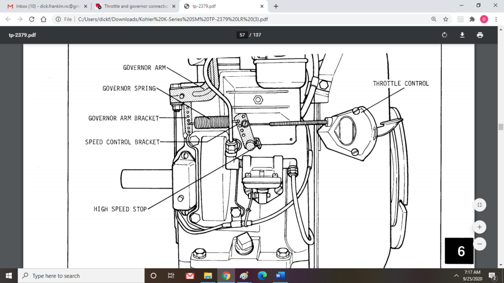

953 nut 56,405 #4 Posted September 25, 2020 This page is from the Kohler Repair manual found in our manuals section. It outlines steps to adjust governor sensitivity once you get it in the tractor. 1 Share this post Link to post Share on other sites
