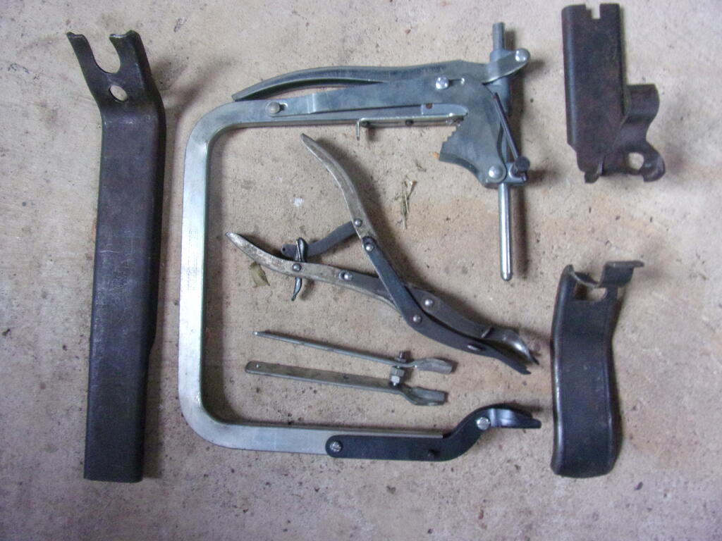

ebinmaine 70,740 #1 Posted September 24, 2020 I've been thinking about getting one anyways and someone is interested in valves that I have in a Tecumseh HH100.. Seems like a perfect time to get one coming. I would like it to have broad usage across all makes if possible. I don't want to spend a ton but I'm not above investing properly for a tool that will last forever. What do you use and why? Share this post Link to post Share on other sites

lynnmor 7,560 #5 Posted September 24, 2020 I have more than a half dozen valve spring compressors and none work particularly well on small engines. I think that the one shown by Bob might be as good as any. YMMV 2 Share this post Link to post Share on other sites
bc.gold 3,403 #6 Posted September 24, 2020 (edited) For the small F-head engines this style of spring compressor gives big thumbs more room in an already constricted space. Edited September 24, 2020 by bcgold 3 Share this post Link to post Share on other sites
WHX?? 50,730 #7 Posted September 24, 2020 I've got one of these and it's a cheap POS but it lays on the shelf a lot so for how often I use it Just a tad better than a a couple a screwdrivers. 1 Share this post Link to post Share on other sites
bc.gold 3,403 #8 Posted September 24, 2020 (edited) 15 minutes ago, WHX24 said: I've got one of these and it's a cheap POS but it lays on the shelf a lot so for how often I use it Just a tad better than a a couple a screwdrivers. I've always been pleased with tools made by Lisle an American company, not to be confused with some Chinese knockoff. The trick of using the c-clamp style is to give the screw a turn or slightly more to add pressure onto the valve spring, then tap the top of the thumb screw lightly with a dead blow. This action breaks the bond, now your ready to fully compress the spring. Lisle Corporation has been manufacturing custom tools for over 100 years! Check out our website to see our selection: from battery brushes to mechanic Edited September 24, 2020 by bcgold 4 Share this post Link to post Share on other sites
oliver2-44 10,367 #9 Posted September 24, 2020 5 hours ago, bcgold said: For the small F-head engines this style of spring compressor gives big thumbs more room in an already constricted space. I have one of these and it works “OK”. The one problem I have with it is sometimes the bottom black piece Wants to pivot on the single bolt that holds it square. I’ve tightened that bolt as tight as I can get it several times. I’m ready to weld it. 1 Share this post Link to post Share on other sites
Ed Kennell 40,484 #10 Posted September 24, 2020 They all work, but the big C clamp frees up both hands and allows more room to work on the keepers. 1 1 Share this post Link to post Share on other sites
953 nut 57,904 #11 Posted September 24, 2020 1 hour ago, Ed Kennell said: C clamp frees up both hands and allows more room to work on the keepers. That is what I use, for the keepers I use a spring loaded tool with magnetic jaws. Just put the keepers on the magnets, line them up on the stem and release the valve spring will push the tool down capturing the keepers. 3 Share this post Link to post Share on other sites
