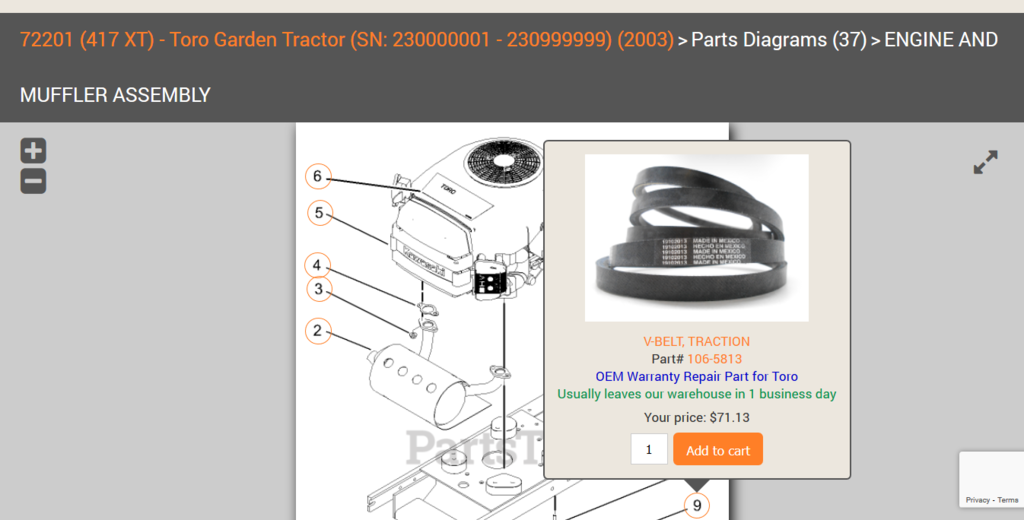

Hello,
 I need to replace the drive belt on my 417xt but am having some difficulty finding the correct part \number and belt length,the Stens # is 248-046  and is 1/2"x 46" but i want to ciofirm before purchase, to be clear, this is the belt that connects engine to trans, right now i have engine running great but not engaging wheels
Thanks
Drive belt 106-5813 but only dimensions found and they are not at Toro - 1/2" x 86.75"
Gates does not show a replacement.
RCPW is a Toro and Stens dealer. They will show the Toro part and a Stens part if there is one and nothing for Stens.
https://www.psep1.biz/arinet.asp#/s/TO//106-5813/1/
Garry
1995 520H+96+97
Achto
:WRS:
Napa 4L870W
