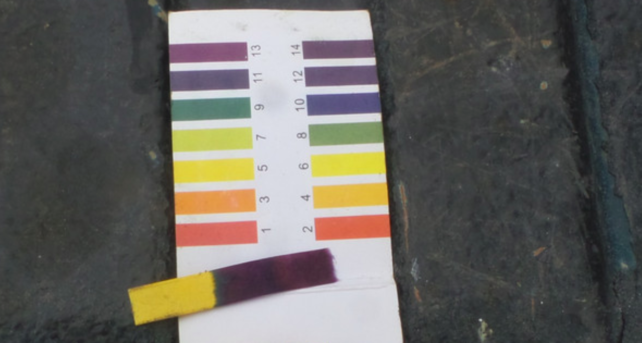

I'm using rain water to leach out the potassium hydroxide, you can use tap water for the same purpose. No need to heat the water use it cold.
Filled the cut off water tank full to the top, once the water was added the solids shrunk. I then refilled the tank to the brim then let the water rain out slowly.
The ph paper shows the liquid coming off to be very alkaline - caustic.
You can use the potassium hydroxide to make soap or use it as a de-greaser which is much better at cutting through grease than sodium hydroxide aka lye.
Hot tank  your next engine rebuild in potassium hydroxide.
Keep in mind not  to introduce pot metal, aluminum or brass parts into the alky solution, they may not be there when you come back to check on them hours later.
