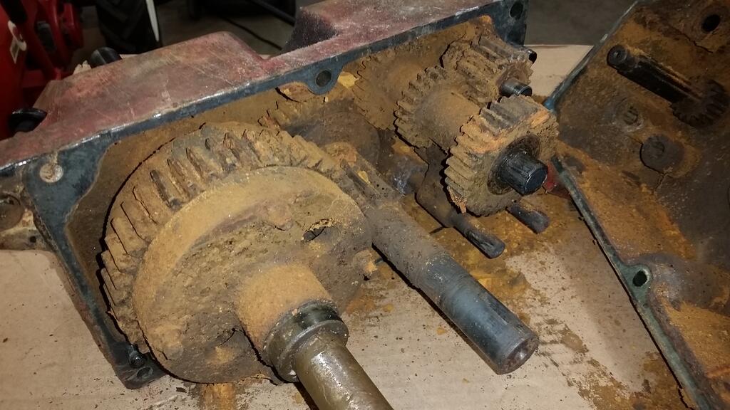

This is a really rough sounding tranny that I put back together from a real mess so the gear mesh is somewhat sloppy but she is what she is. Figured good enough for the women we go out with. :)

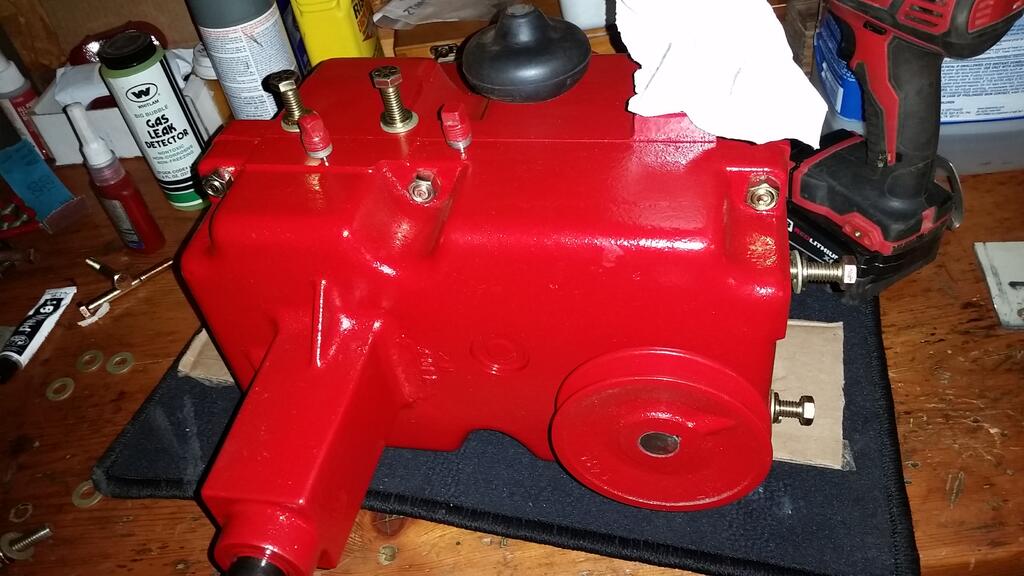

No way, you were driving in that shape?  I imagine that came from the deep sea!?
WHX??

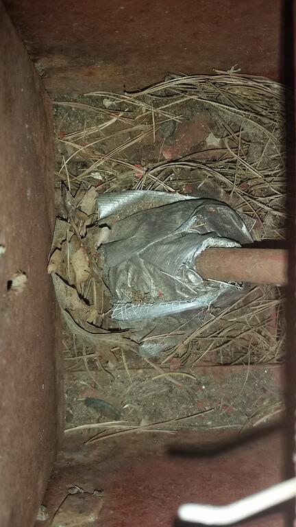

No tranny was locked up. Sat out side for many years with this for a boot.
Edited by WHX24
  • Confused 3

That sure cleaned up nicely :thumbs:

Tractorhead

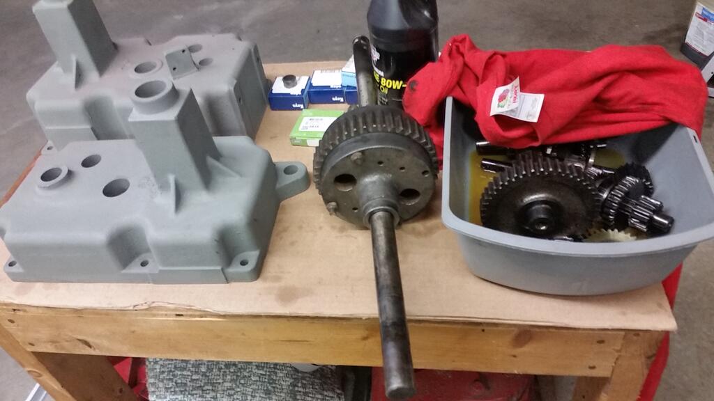

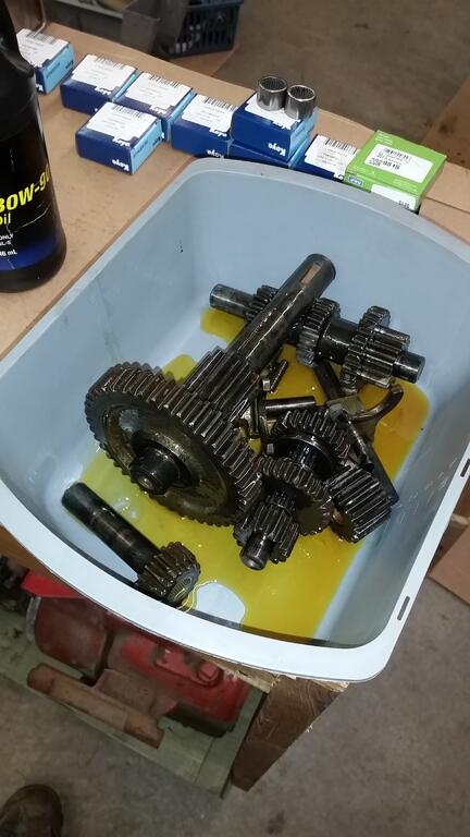

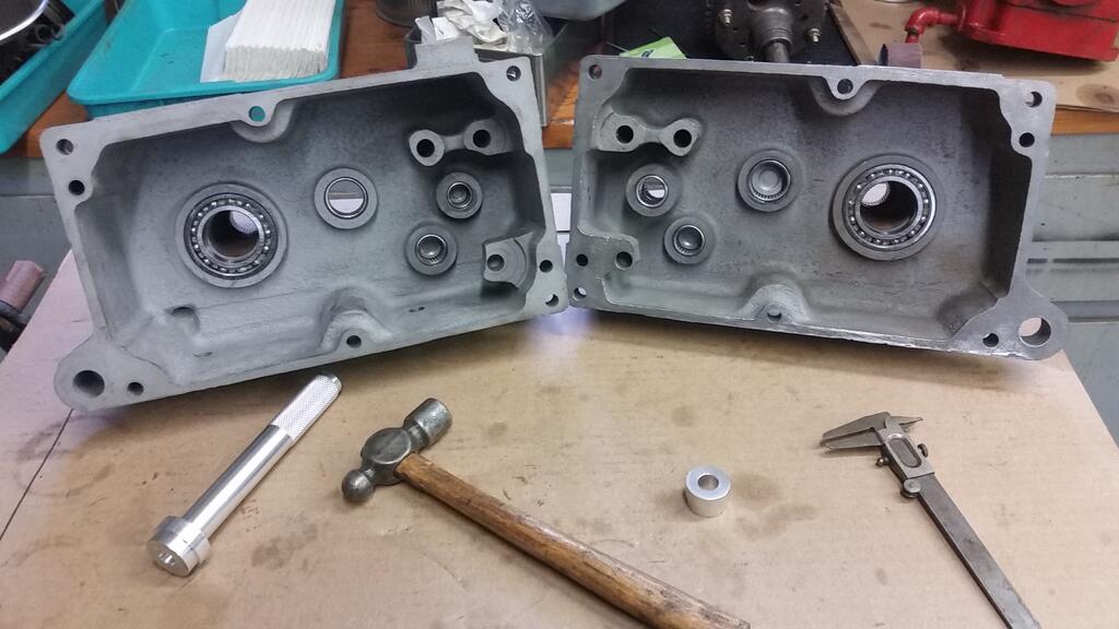

No... bench top grinder with a wire wheel & by hand with a small wire brush. Cases blasted
Tractorhead
Great job!
The blasted case Looks really good, but maybe better in Red.
do you paint it or powder coat?
WHX??
Paint

well when I took mine apart I did see about as gunkie as your interior was also, my detent steel balls were pitted and out of round so I went to Lowes and they had some, I got the 1/4 inch size I believe one in a package and not very expensive.  I do not remember for sure but I think I used the original spring
