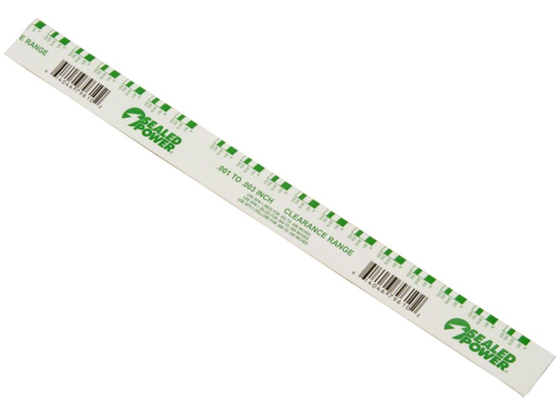

rmaynard 15,427 #39 Posted December 14, 2020 (edited) Sometimes it is hard to determine by ear where the rattling is coming from, but my guess is that it is coming from the connecting rod. Changing the points gap, thereby changing the timing, will tend to quiet it down, but you will lose power in doing so. I never use the .020 as my final. I only start there and do a static timing adjustment using a meter and viewing the marks on the flywheel. Once you have determined that the timing is right, and noise is still there, you will probably have to do a deep dive into the engine. But here is another thought. Many of the K-301'S had balancing gears. As they wear, they can be a noise producing problem, many guys have just taken them out. Either way, you will at least have to remove the pan. If you don't want to completely remove the connecting rod, you can always check the journal wear using Plastigage. Edited December 14, 2020 by rmaynard 1 1 Share this post Link to post Share on other sites
