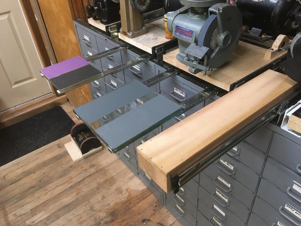

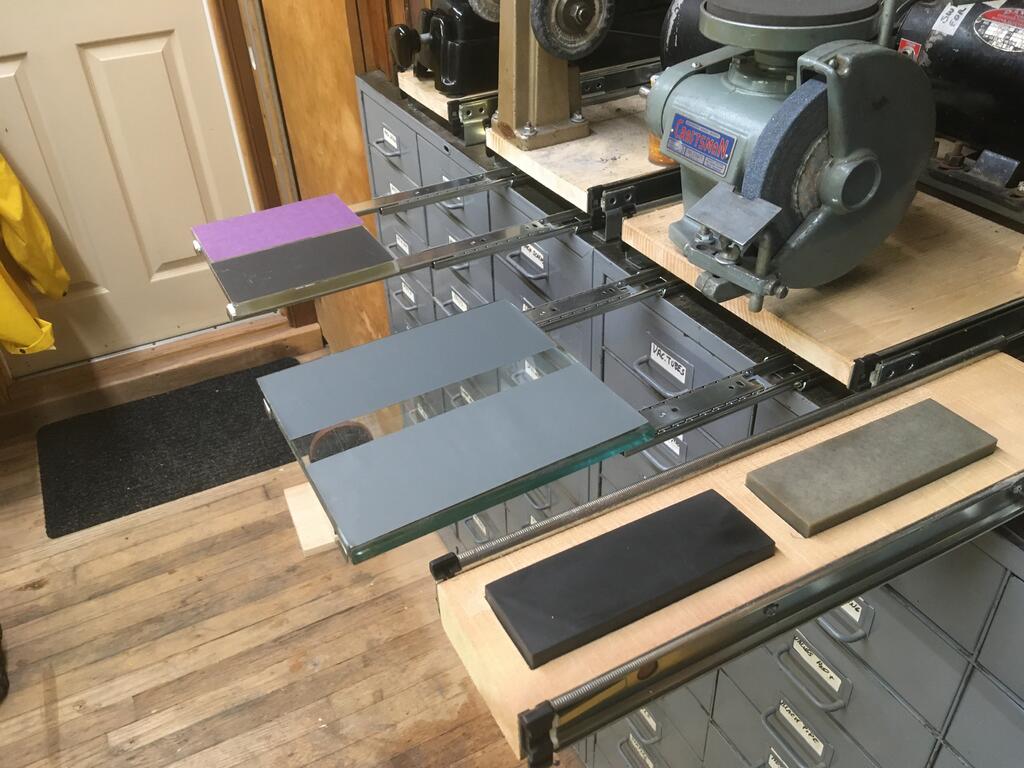

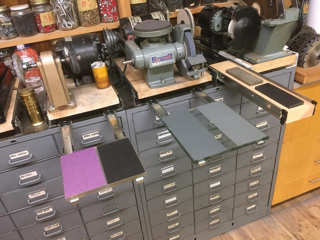

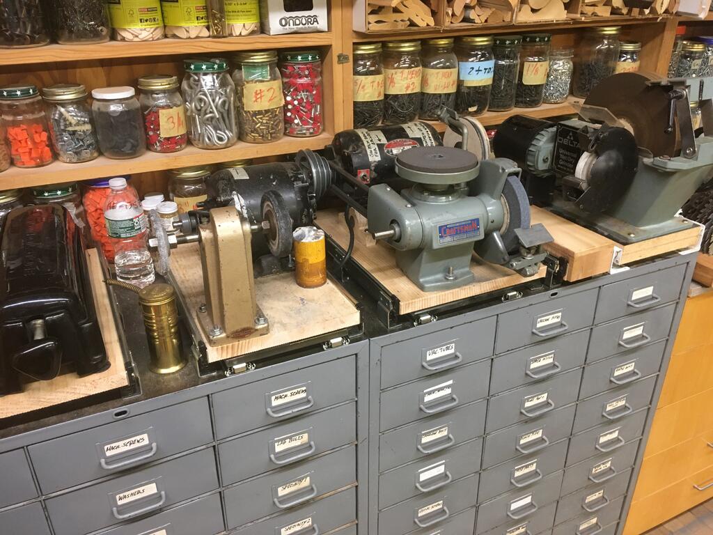

formariz 11,993 #1 Posted September 10, 2020 Had time today for a few additions that keeps all in one area now. Added two pull out units with a 1/2 glass plate for very fine sandpaper ( 400, 800, 1000, and 2000), to polish and hone backs of chisels and plane blades. I don’t use the wet stones for that because they are never flat. Added also my favorite two natural whet stones. A translucent white Arkansas and a Surgical black Arkansas. 3 7 1 Share this post Link to post Share on other sites
