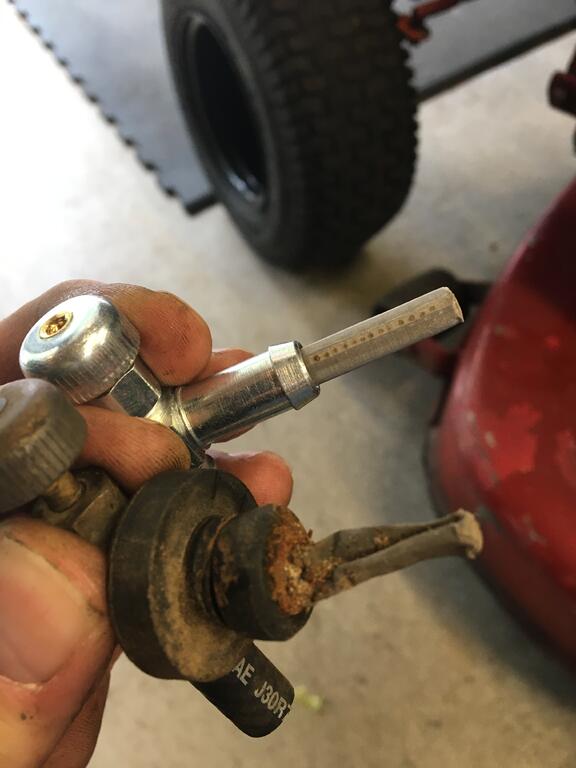

Sparky-(Admin) 21,743 #5 Posted September 9, 2020 The in-tank filter might be compromised. This is the one I swapped in a 312 last month. Fuel still flowed thru it believe it or not, but it had to be restricted. 4 2 Share this post Link to post Share on other sites
