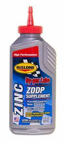

johnnymag3 2,559 #7 Posted September 9, 2020 (edited) Rotella 30W with Rislone zinc additive...you will feel the difference immediately. Edited September 9, 2020 by johnnymag3 6 1 1 Share this post Link to post Share on other sites

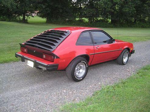

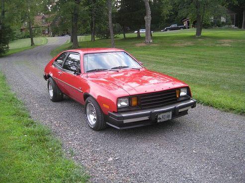

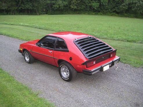

71_Bronco 1,072 #11 Posted September 9, 2020 (edited) My little red Pinto Edited September 9, 2020 by 71_Bronco 1 2 1 Share this post Link to post Share on other sites
ebinmaine 70,752 #12 Posted September 10, 2020 Cute. Is it in the muscle car thread? 1 Share this post Link to post Share on other sites
71_Bronco 1,072 #13 Posted September 10, 2020 57 minutes ago, ebinmaine said: Cute. Is it in the muscle car thread? Didn't know we had a muscle car thread, ill have to look for it. Not sure this would even qualify lol 1 Share this post Link to post Share on other sites

305 380 #16 Posted September 10, 2020 i have three older cars that have flat tappet camshafts , the use of zinc is necessary in them. i use conventional Valvoline with Rislone #4405 supplement. available at any auto parts store. i also add some to my Wheelhorses and my 1966 Honda 4 1 Share this post Link to post Share on other sites

peter lena 9,088 #18 Posted September 11, 2020 305, agree with the rislone zinc zddp additive, best price is on amazon prime , i also recently contacted rislone about adding a side measurement scale to the bottle for smaller engine amounts . adding this to rotella 30 wt , is the magic smooth , effortless running that you have to experience, pete 1 Share this post Link to post Share on other sites
