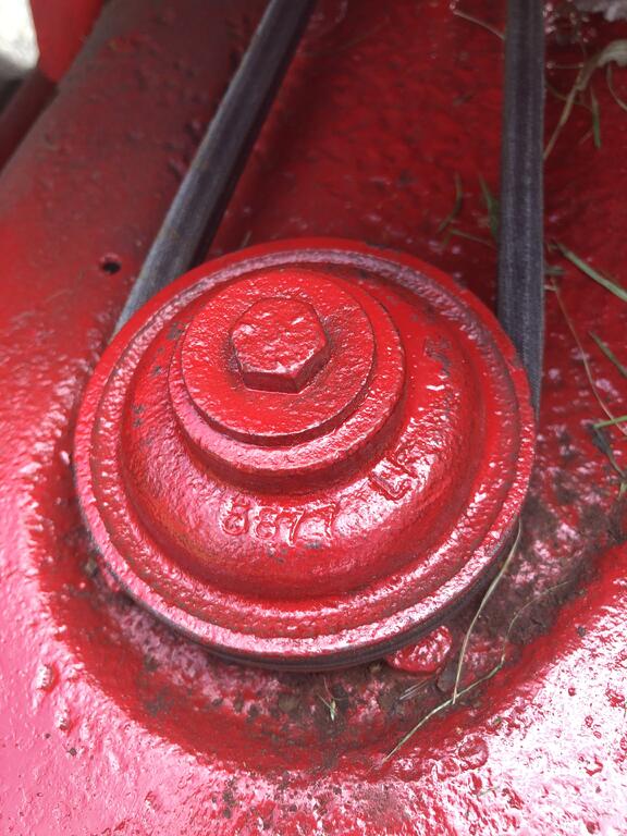

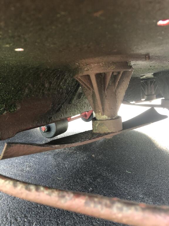

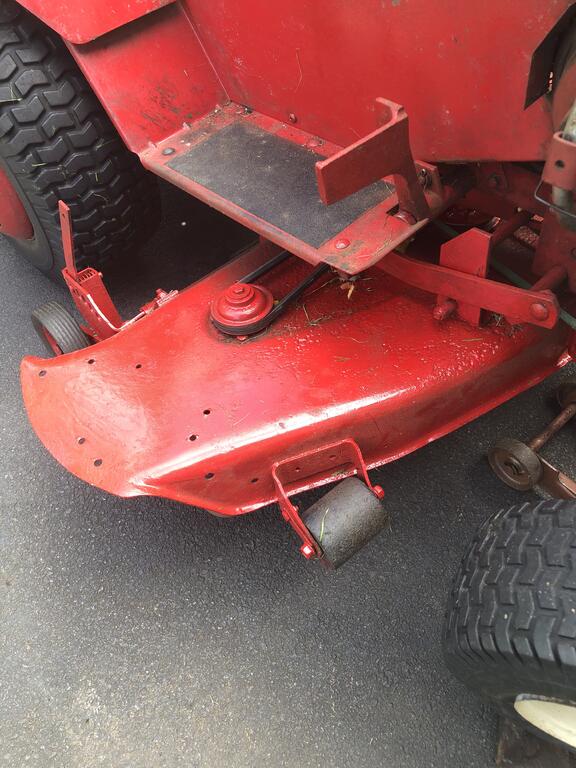

Hi guys need you help have a 42" side Discharge Deck (Triple Blade) mower deck, mounted on a C-81, that is in bad need of an outside Spindle (Mandrel) the pulley on top is # 5877. The bottom bearing is toast. so I poise the following questions. Note pics attached.
1. Does any on have one of these for less then a Kings ransome?
2. Is it possible to disassemble and install an new bearing from like NAPA?
3. All three spindles have NO Zerk grease fittings can I drill and add some...... if yes where on the housing is the best place to do this.
Thanks feel free to add any other options......

Might be the top side  they used a real common bearing bottom may well be a needle bearing. You need to disassemble and find out.
That is a crossover deck that used the old style shell but the new style carriage.

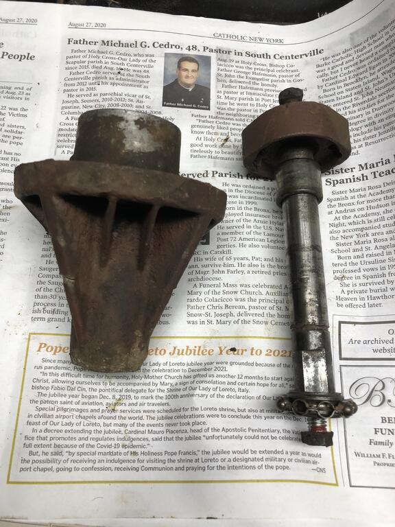

Thanks for the great information and Parts Manual excerpt. I will try to get the bad Spindle out and apart to see just how bad the damage is, my guess is that all the bolts will break off and make things kinda miserable.

This looks like the one should have a common bearing on the top and a needle on the bottom. Basically the same spindles as these. Yours might be the type K non greaseable ones tho if they have been upgraded. Only one way to find out and that's peel it apart which sounds like it has to done anyway.
  • Like 1
Rob R
So after MUCH heat and slow progress I go the Mandrel off and apart. I need a new upper roller bearing and a lower needle bearing.... on flea-bee and the Internet they want a small fortune for them so I went to McMaster-Carr and found their R12 in both categories (total $ around $30.00) just might work so taking a chance and will see what happens..... might need a little creative shimming but so be it...... to be continued.....  The Macmaster bearings R12 one needle and one roller arrived.... as stated they were slightly shorter then the stock bearing so I shimmed them until correct width. Installed and cut the front and back lawn..... back in business.... thanks for the help!  Save another one that was laying in the woods for at least 15 years.

Sorry I do NOT have the exact # I used they were in the R12 category on the internet site. I did have to shim them and this took a while to get right.... not sure it was worth the time and effort to do this especially with two. Suggest you take the existing to NAPA or spend time with a rep from McMaster Carr to get the correct bearings.
