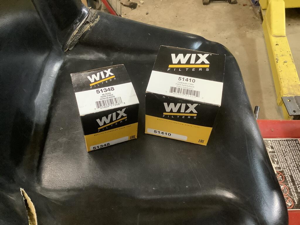

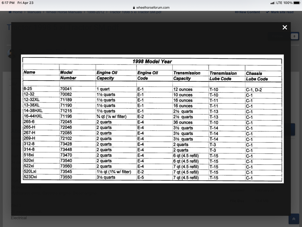

Pullstart 64,523 #53 Posted April 20, 2021 Oil change day for Duke! I’m running WIX 51348 for the Kohler CH20 CH20S engine and WIX 51410 for the transmission on my 520 Xi series 520Xi. Yes, I made key words that might help with a search Share this post Link to post Share on other sites
haydendavid380 759 #54 Posted April 20, 2021 (edited) 31 minutes ago, pullstart said: Oil change day for Duke! I’m running WIX 51348 for the Kohler CH20 CH20S engine and WIX 51410 for the transmission on my 520 Xi series 520Xi. Yes, I made key words that might help with a search What do you run for fluid? Edited April 20, 2021 by haydendavid380 Share this post Link to post Share on other sites
Pullstart 64,523 #55 Posted April 20, 2021 26 minutes ago, haydendavid380 said: What do you run for fluid? Because the engine has a filter, I’ll run detergent 10W30. The trans will get the same. Share this post Link to post Share on other sites
haydendavid380 759 #56 Posted April 20, 2021 2 minutes ago, pullstart said: Because the engine has a filter, I’ll run detergent 10W30. The trans will get the same. I assumed 10w30, I meant brand. I'm new to hydros and one thing I read has said to use a non detergent. The manual said "premium motor oil". I didn't know if there was a go to for the hydro system or if any 10w30 would work. Share this post Link to post Share on other sites
shallowwatersailor 3,214 #57 Posted April 20, 2021 32 minutes ago, haydendavid380 said: I assumed 10w30, I meant brand. I'm new to hydros and one thing I read has said to use a non detergent. The manual said "premium motor oil". I didn't know if there was a go to for the hydro system or if any 10w30 would work. I use to own three different 5xi, two 520-H, and a C-145. In all six I ran Mobil 1 10W-30 synthetic. In the winter it flowed easier when cold, and in the summer provided better protection with the heat generated. Share this post Link to post Share on other sites
Pullstart 64,523 #58 Posted April 20, 2021 1 hour ago, haydendavid380 said: I assumed 10w30, I meant brand. I'm new to hydros and one thing I read has said to use a non detergent. The manual said "premium motor oil". I didn't know if there was a go to for the hydro system or if any 10w30 would work. the previous engine filter was dated 2016, I’m going to hang out on a limb and guess the trans filter was much older. With that said, an annual maintenance will far outlast the previous maintenance record and I’m sure any oil is better than 5 year old oil no matter the quality. 2 Share this post Link to post Share on other sites
Pullstart 64,523 #59 Posted April 23, 2021 I’m adding 4.5 qts 10W30 to the transmission per the lube chart, then oil changes will be complete! Share this post Link to post Share on other sites

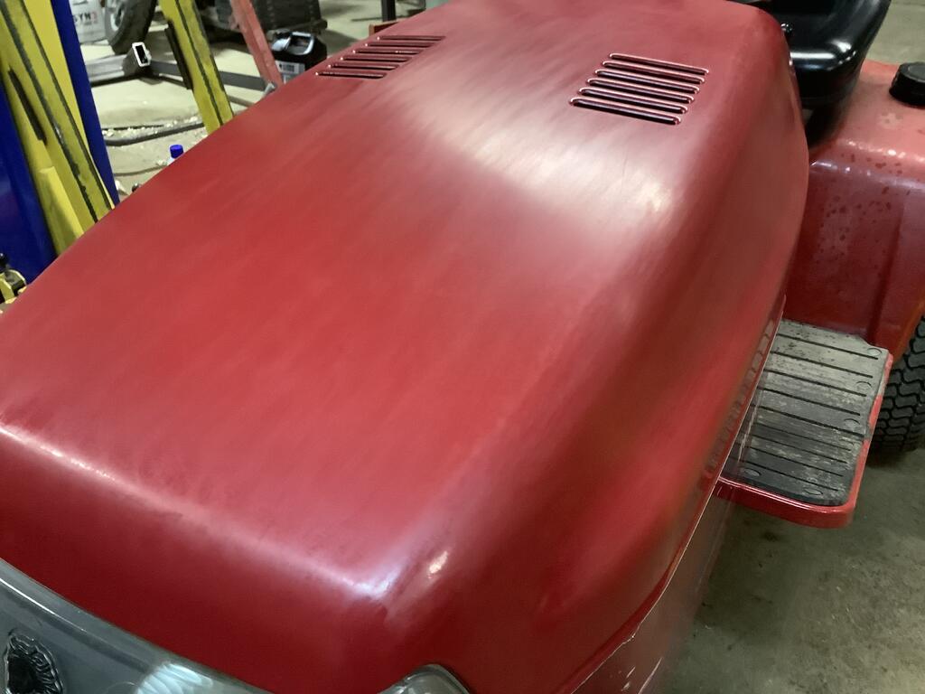

Pullstart 64,523 #60 Posted April 28, 2021 On 8/24/2020 at 9:53 AM, pullstart said: I gave this beast a bath today, and while I still think of a name I consider if I should wet sand the brush marks out or leave it as is as a worker? I threw some 600 grit and WD40 at the hood tonight. It needs 1000/1500, but it took the deep scratches out! The fender scratches are too deep to wet sand out.. Share this post Link to post Share on other sites

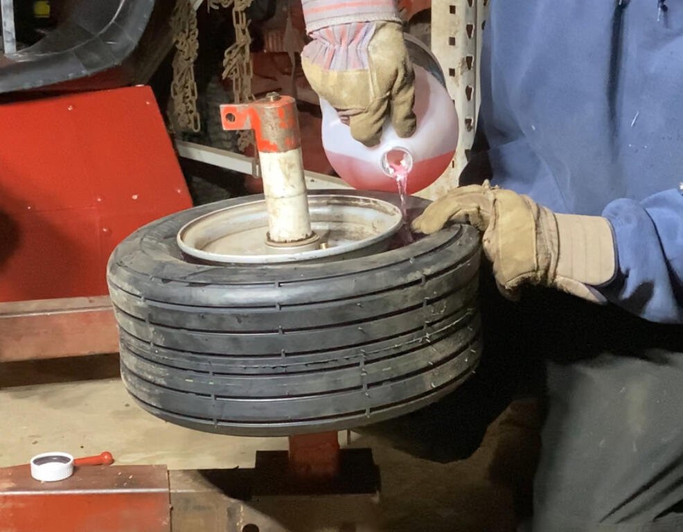

Pullstart 64,523 #62 Posted July 26, 2023 I never shared the video of filling these front tires on here… and if I’m being honest I only actually changed one front tire Share this post Link to post Share on other sites

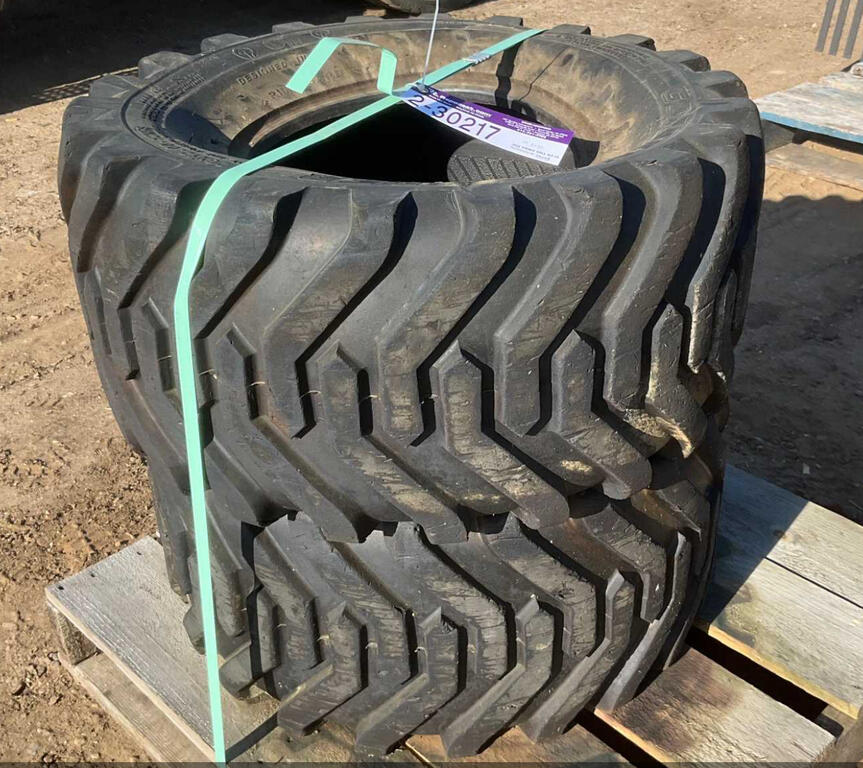

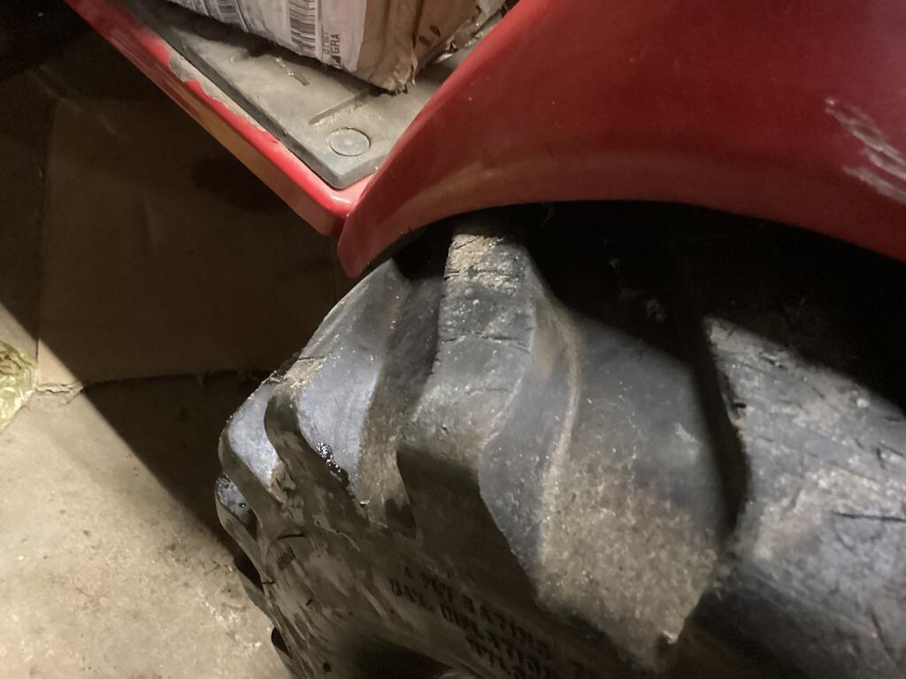

Pullstart 64,523 #63 Posted July 26, 2023 I might have some fender trimming to do… or possibly raise the fender pan? I’ll be picking up some more 26x12-12 OTRs today! Share this post Link to post Share on other sites

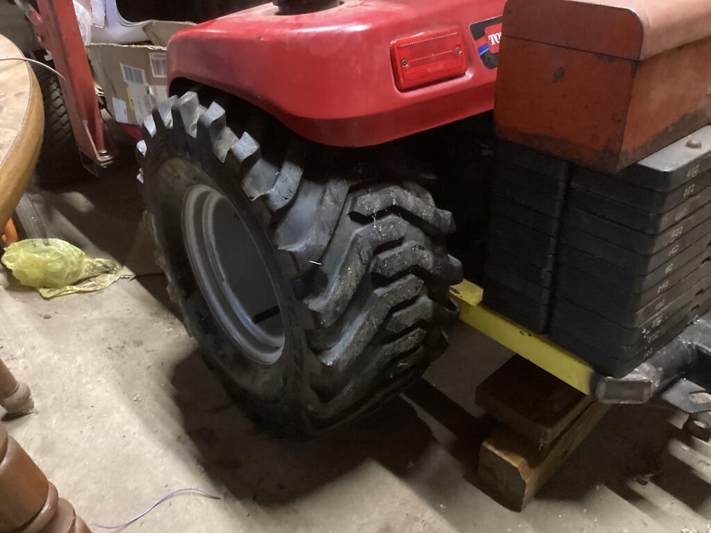

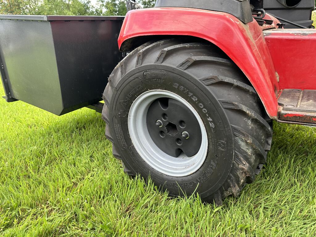

Pullstart 64,523 #68 Posted July 26, 2023 26x12-12 Carlisles on stock wheels JUST clear! 2 1 Share this post Link to post Share on other sites
Pullstart 64,523 #69 Posted July 27, 2023 18 hours ago, SylvanLakeWH said: No more than 1/16" of mud allowed!!! As quoted from another post, yeah it’s a bit tight. Before I work this one, I’ll more than likely trim the fenders up or at least roll them up a bit. 1 Share this post Link to post Share on other sites

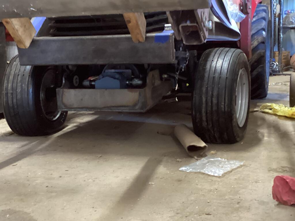

Pullstart 64,523 #70 Posted July 27, 2023 I’m happy to report this thing is finally sitting on new rubber and the fronts have about 2 gallons each of fluid in them! Share this post Link to post Share on other sites
Handy Don 13,340 #71 Posted July 27, 2023 2 minutes ago, Pullstart said: I’m happy to report this thing is finally sitting on new rubber and the fronts have about 2 gallons each of fluid in them! Quite the beefy look there! Is that the hydraulic pump behind the lower front bracket/bumper? How much ground clearance? Share this post Link to post Share on other sites
Pullstart 64,523 #72 Posted July 27, 2023 8 minutes ago, Handy Don said: Quite the beefy look there! Is that the hydraulic pump behind the lower front bracket/bumper? How much ground clearance? I have 6” up front, 7” from the yellow subframe on back to the tail. There’s also a skid of sorts from that front pan all the way back, as the front bracket will bolt to the subframe. I don’t plan on much off road duty with this one. 1 Share this post Link to post Share on other sites

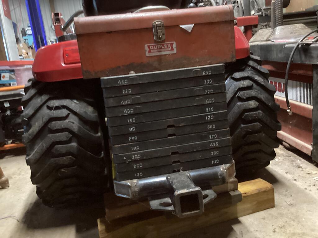

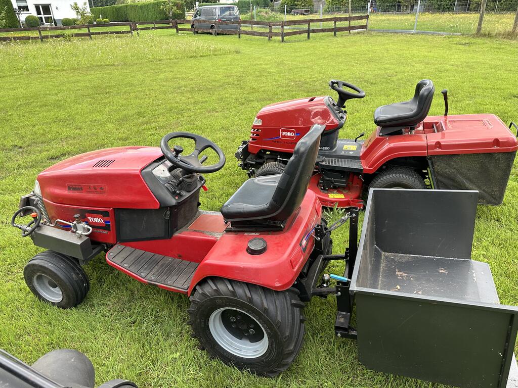

d-schumacher@web.de 6 #73 Posted August 2, 2023 I Hello, I'm from Germany and I also have 2 Toro 520LXi. I also put 26x12-12 tires on one. But had to lift the bowl. 1 1 Share this post Link to post Share on other sites
Handy Don 13,340 #74 Posted August 2, 2023 1 hour ago, d-schumacher@web.de said: Hello, I'm from Germany and I also have 2 Toro 520LXi. I also put 26x12-12 tires on one. But had to lift the bowl. Hello Herr Schumacher and welcome to the forum. I would certainly like to see some more detailed pictures and descriptions of the additions you have made to your 520lxi tractors! 1 Share this post Link to post Share on other sites
